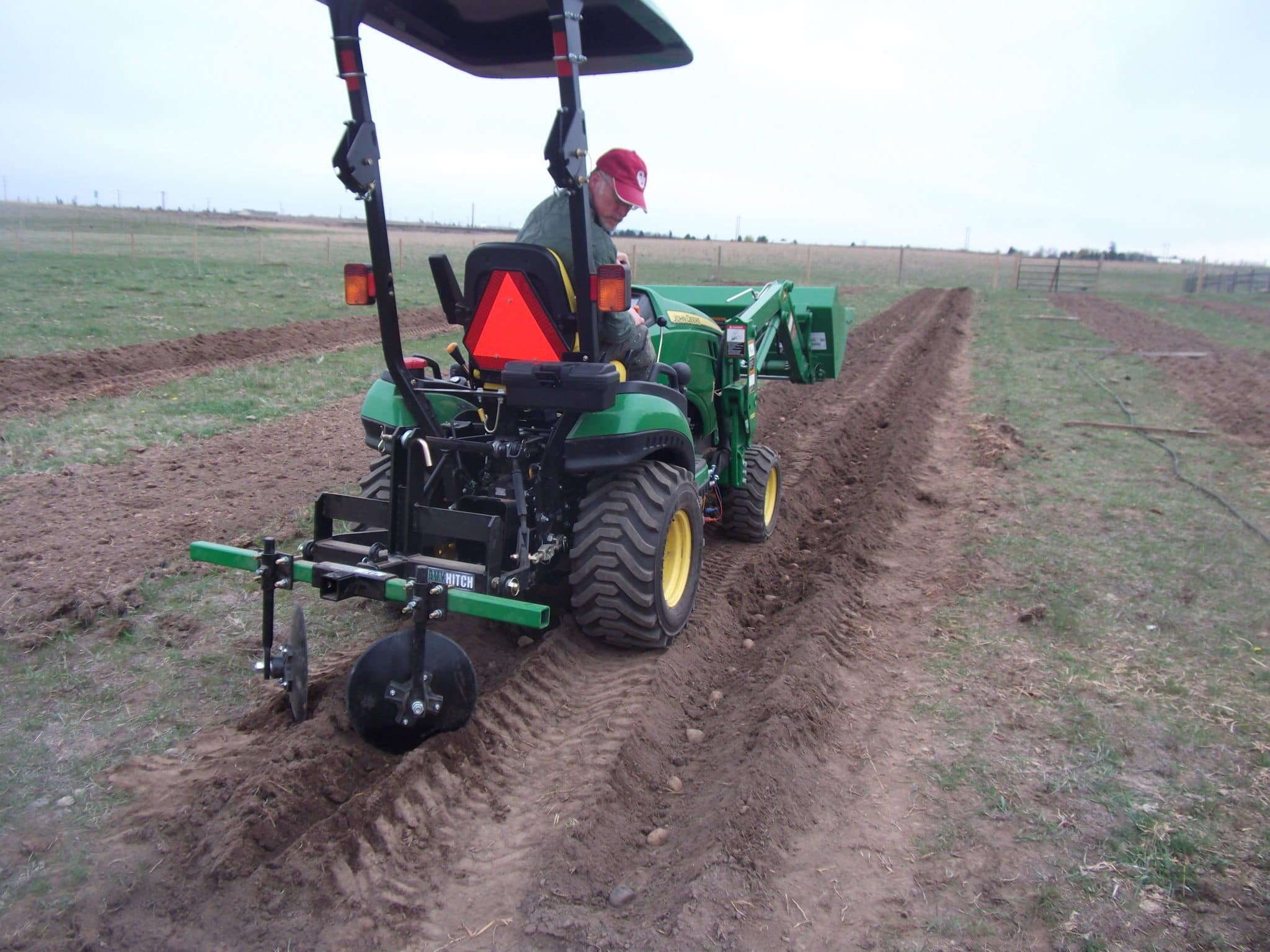

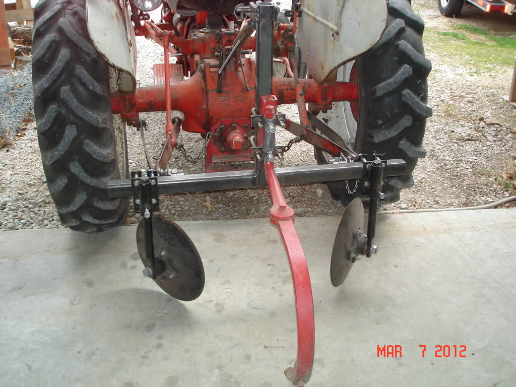

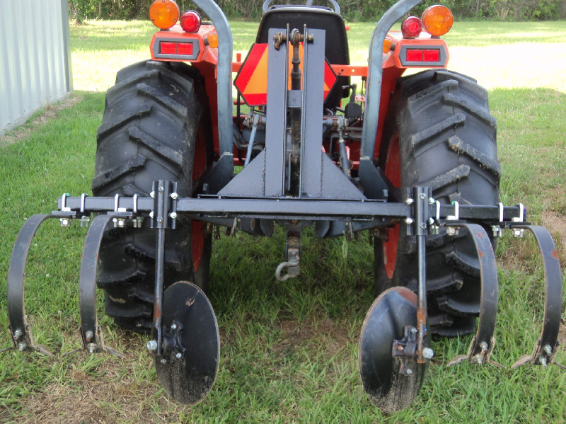

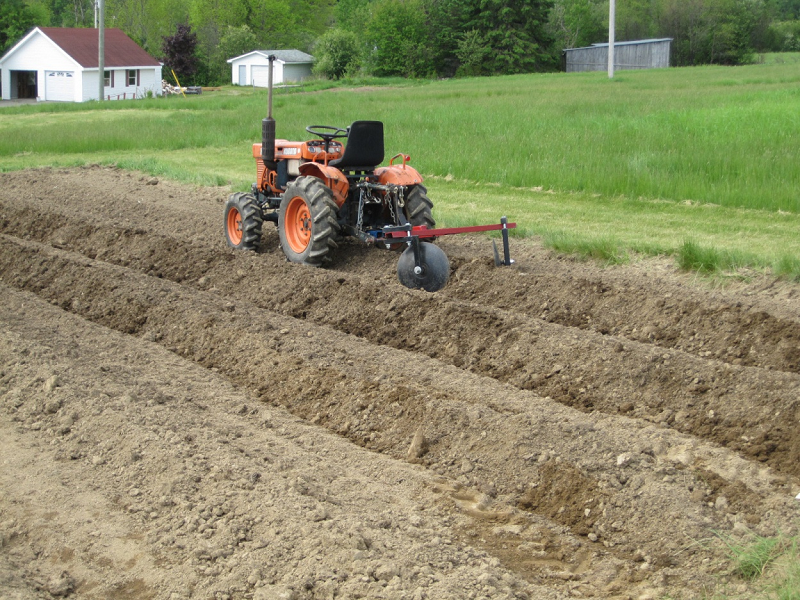

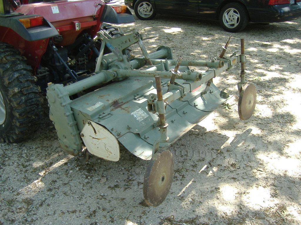

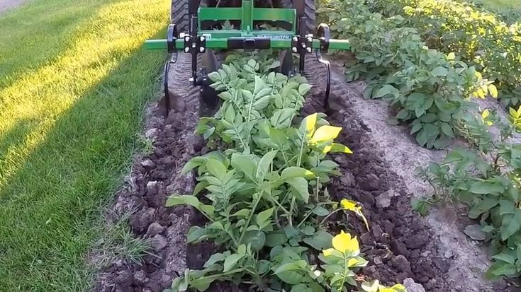

Yanmar tiller disc/wheels come in a few types off the back end of the tiller.
These are the rear tiller disc/wheels that can do hilling. They are not adjusted yet for use.
Those Yanmar tiller disc/wheels are to behave like this real hiller attachment.
Or this one,
Or this for corn,
or this,
For a successful hiller, The disc are to be like this and turned inwards. These discs are dome shaped.
Now, I want a hiller on my Yanmar tiller with BIG disc/wheel. For potatoes!
Why make 2 passes when a Yanmar tiller can do it all in 1. :)
Here's a funny Yanmar tiller at work. LOL :whistle:

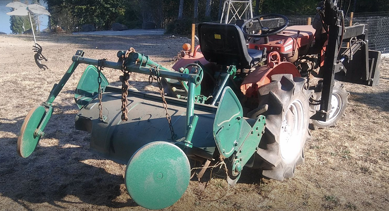

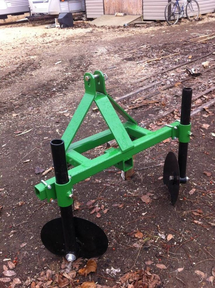

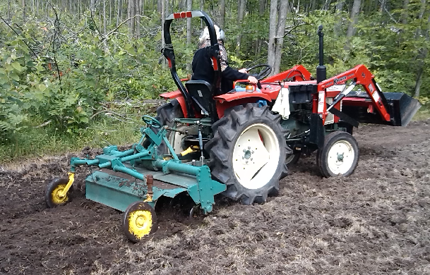

Those first two tillers are set up wrong, smooth side of the wheels out. The second photo shows that this makes a gouge where each wheel is crabbed. That's not the intended result, the tilled soil should be flat. The setup diagram on my RS1400 wants smooth side in.
I like the third photo. It looks like the wheels can be locked at the angle needed for hilling instead of swiveling.

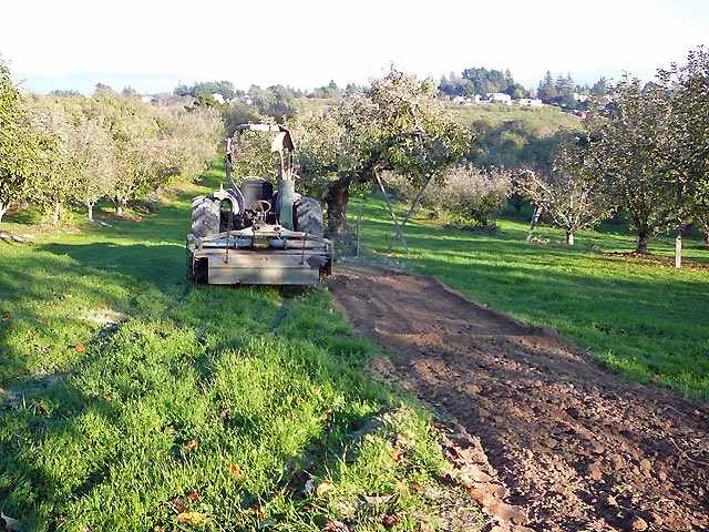

Hey that last LOL funny photo is MY $200 tiller!! (in my apple orchard). On the YM240 which it was intended for (on YM2000) but my ROPS and oversize tires make this unsuitable for my orchard, I can't get close to the trees. A first trial, when I bought it. A few feet in 540rpm gear then a few more in 1,000 gear which turned the soil to fine flour. I concluded 540 is the right gear for American farming and the higher speeds used in Japan must be for rice paddy muck. This was before I had the rear wheels.
And here's that RS1400 on the little YM186D the first time I tried it there. I still hadn't learned that the wheels need to be smooth side in to avoid running crabbed and making the ruts shown here. I finally swapped them so each wheel is smooth side in, and now my tilling result is even with no ruts.

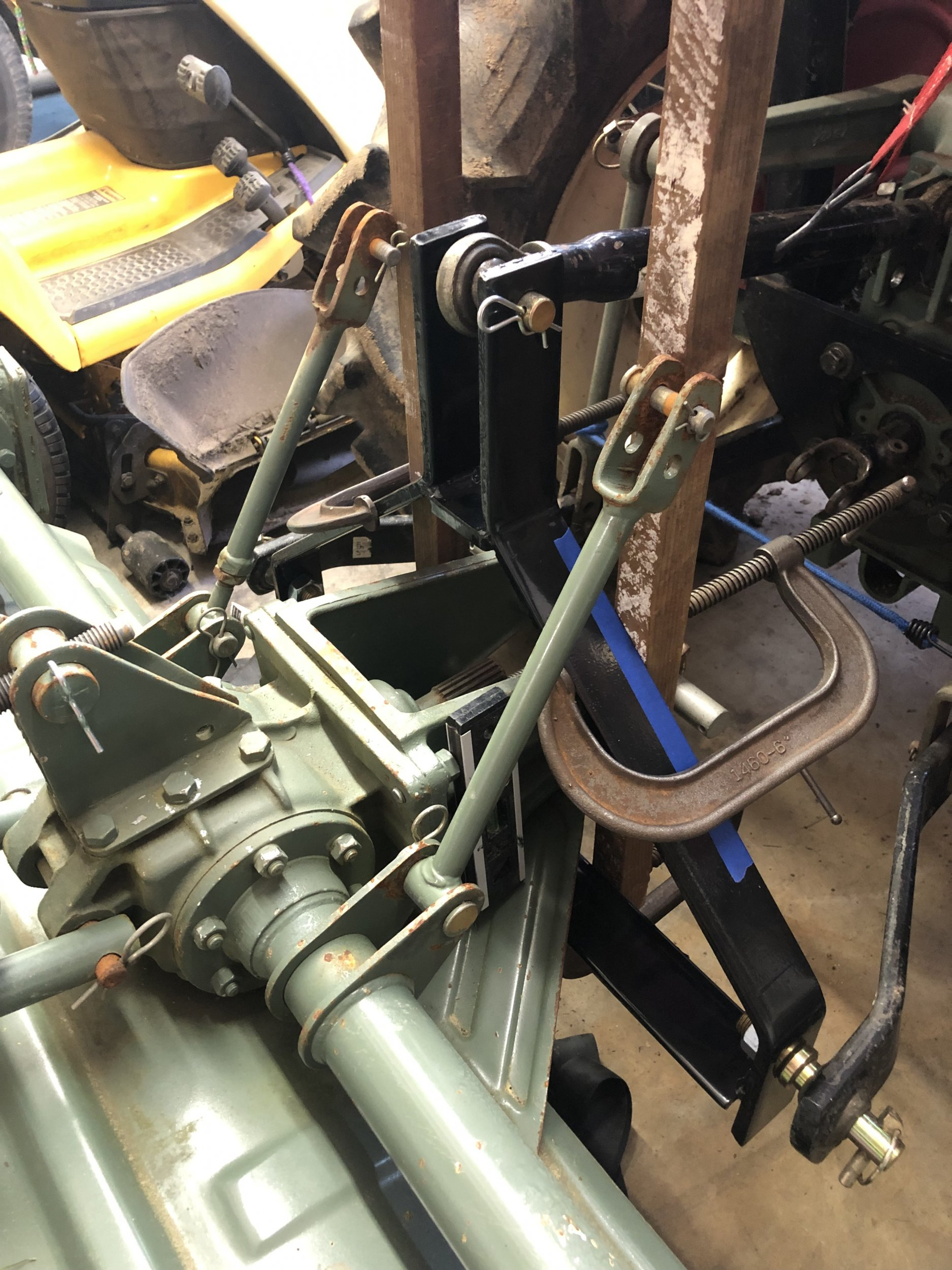

It was a total fluke that I found it bmaverick. I have been thinking I need to get going on smoothing out my "yard" and was looking for ideas for a Harley rake and searched tillers on CL (first search in years) and two Yanmar tillers popped up from the same seller. A 1400 3-point and this one. The 1400 sold in less than 4 hours but I got my hooks into this one, probably because of the 2-point. It was in better shape any way. Thanks for the manuals, they will be a big help!
Mine has what looks like the complete wheel setup on the rear but I don't know anything about plot prep and I'm not planning any planting prep except grass seed if this works.
The mount is all done, now on to the driveline.
I like your workmanship. It doesn't modify the tiller, just mounts it.

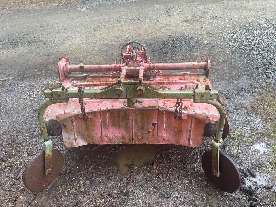

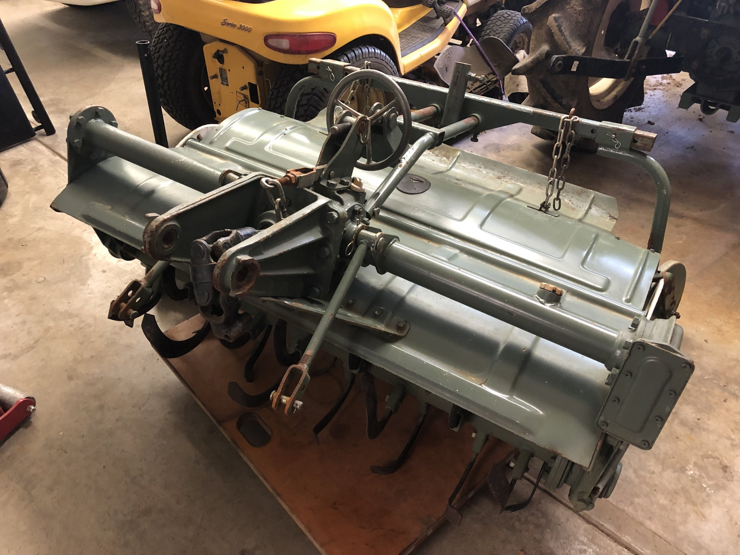

Just came across this not to far from #1 son advertised at $325. Looks to be the same Yanmar....Condition unknown, any thoughts.....
/ Yanmar RS1202 Tiller project #12
/ Yanmar RS1202 Tiller project #13
That's Yanmar Leisure Suit Green under the repaint using Pepto Bismol Pink. The RS-something decal seems intact.
Those are near indestructible, I wouldn't be afraid of it if the tines are intact. The dent means nothing.
And it seems to have the variable-width 'training wheels' so it might be suitable for hilling.
If you (or a friend) have the welding skill to add 3-point attachment points on it, and considering what a new one costs, it is worth what he's asking.

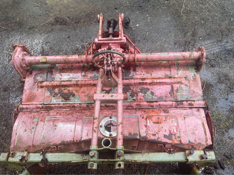

Can design, fab and weld in my shop no problem. Just wanted to confirm it's the real thing, any idea which model ? Waiting on a reply to see if she spins freely.
/ Yanmar RS1202 Tiller project #15
Looks to be a chain drive (skinny gear case) and maybe two sizes wider than my RS-1400 (1400mm tilled width, 53 inches).
I think there is a serial number stamped by the center gear case and the prefix would be the model. Or that big decal might be legible. The top row of text will say which model.
/ Yanmar RS1202 Tiller project #16
It's listed as a 48"
