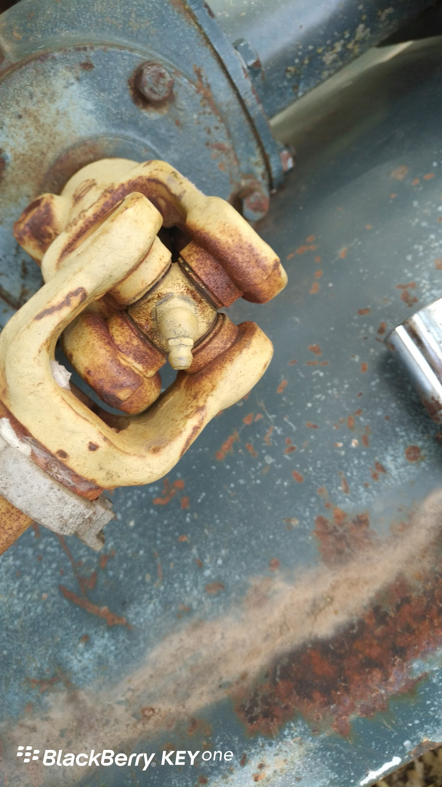

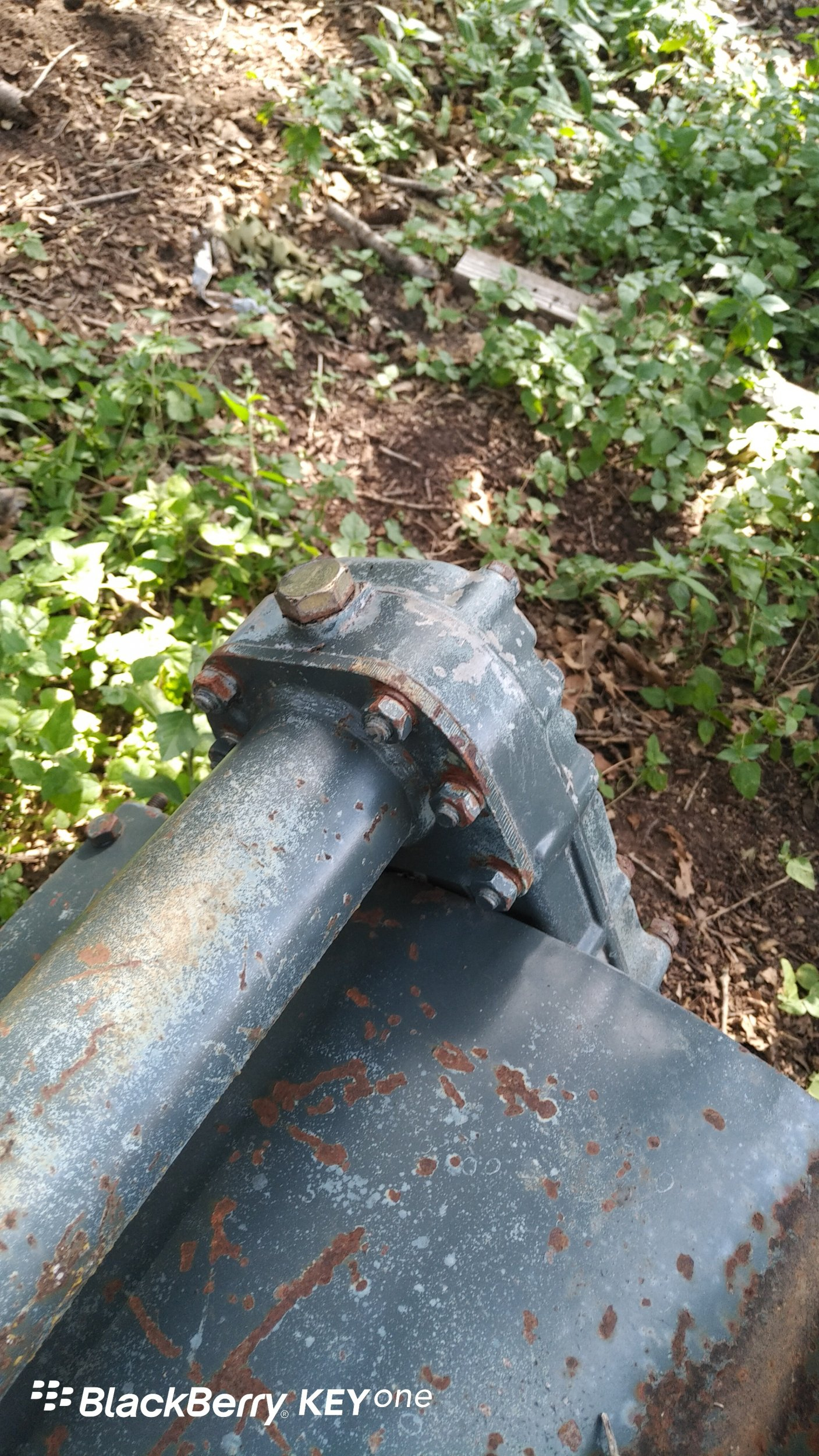

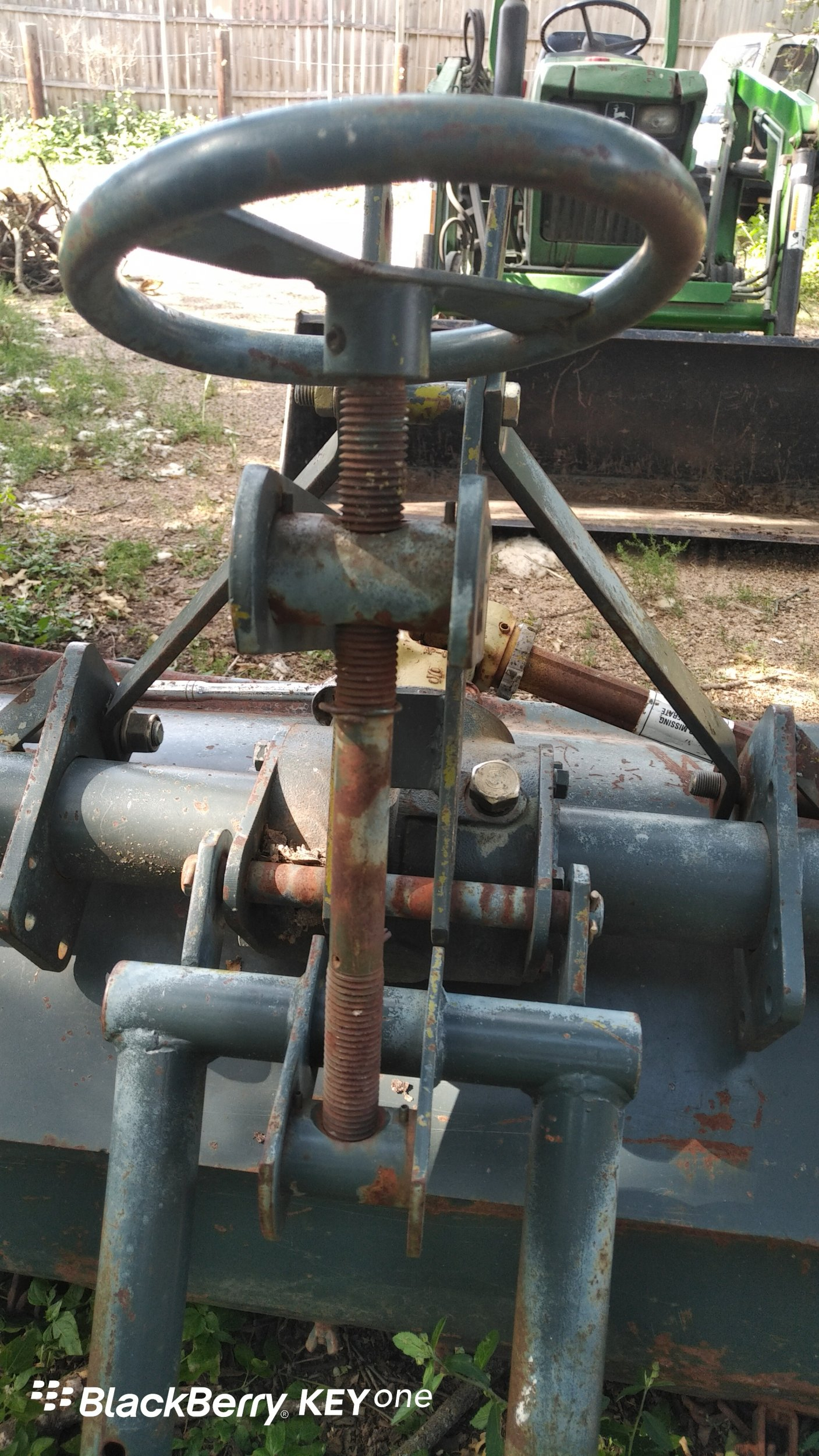

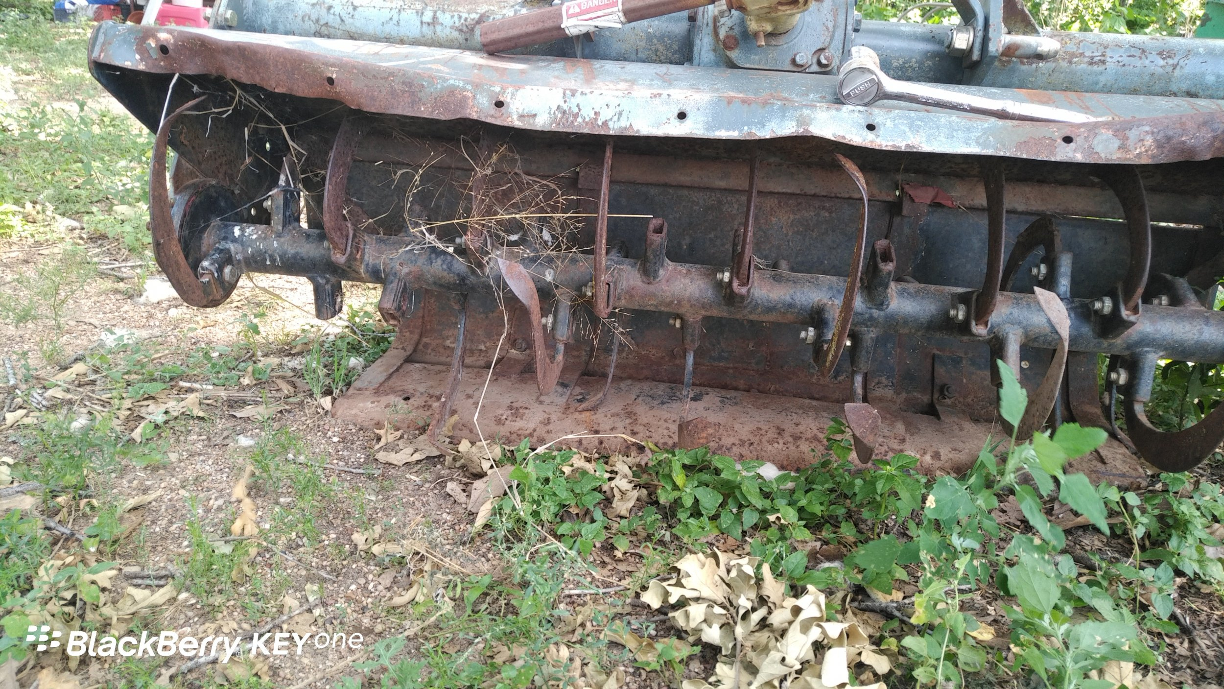

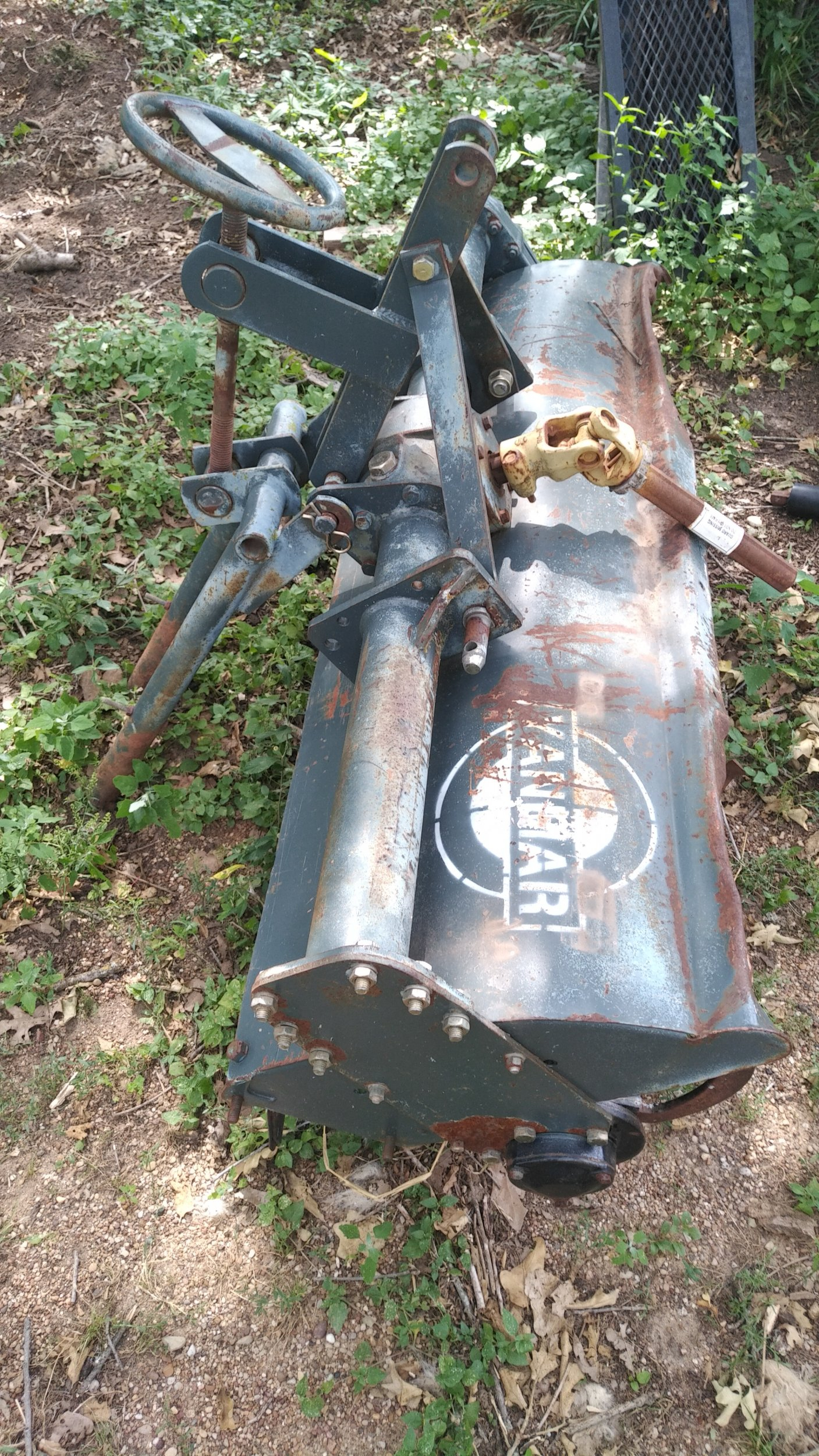

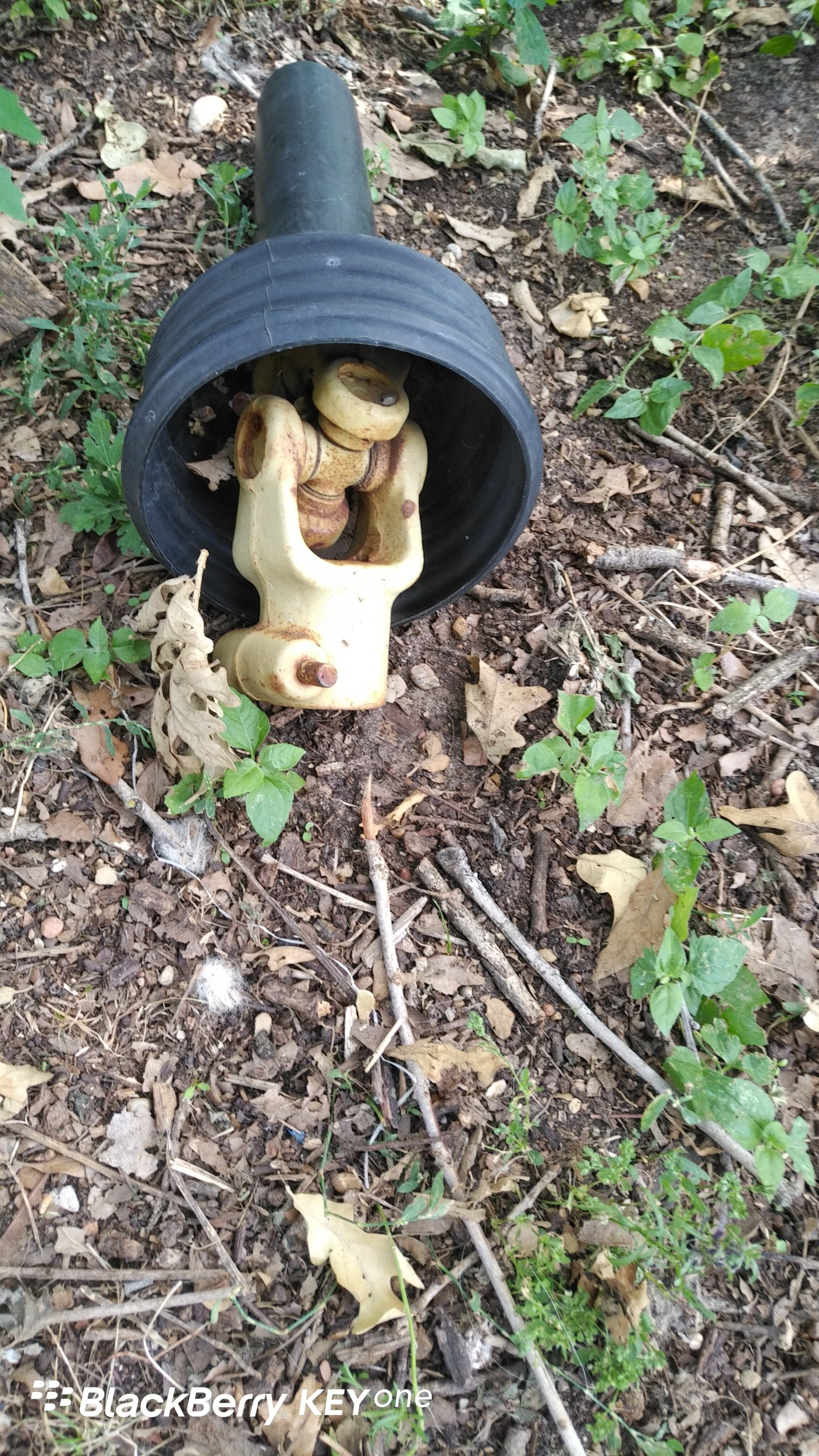

Was gifted a tiller from retiring farmer. Needs a few tines, she said to fill up the gear boxes, lube joints. Looks to be 2 gear boxes, top along by hitch and one on the side for the chain, I presume.
I'm glad to have this tool as my shoulders and pulling start ropes days are coming to an end if I want to feed myself when I'm 70. Any tips? Here's some pics. Sorry I didn't mean to upload all of the full size pics AND the thumbnails.... Thanks!

Looks really dry.....give it plenty of grease, PB Blaster, oil.....
maybe take one of the tines off and take it to a farm store like Tractor Supply to match it with a generic. Might even be easier to replace all of the tines with new ones that match if you can't find an exact replacement.
probably don't even need to replace the missing tines; just see how it does without them; just make an extra pass.

I may have the exact manual for this tiller, however, the images are at such odd camera angles that I can't even figure it out. From the large Yanmar logo, it could be a USA made model and not a Japan made model. I've not seen a Japan made model with a huge logo like that as Yanmar in the YM logo era. It's a mystery.
IF you can supply pixs from standing behind it looking down onto it and another one standing in front of it looking down on it, the arrangement of the gearbox and the shaft positions would tell the better story.
Yes, clean it up. Get it in prime working condition. Not sure if I would use PB Blaster on a tiller meant for growing your food. Those forever chemicals are totally not good for your health.

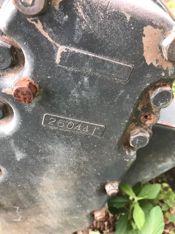

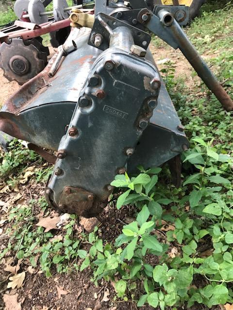

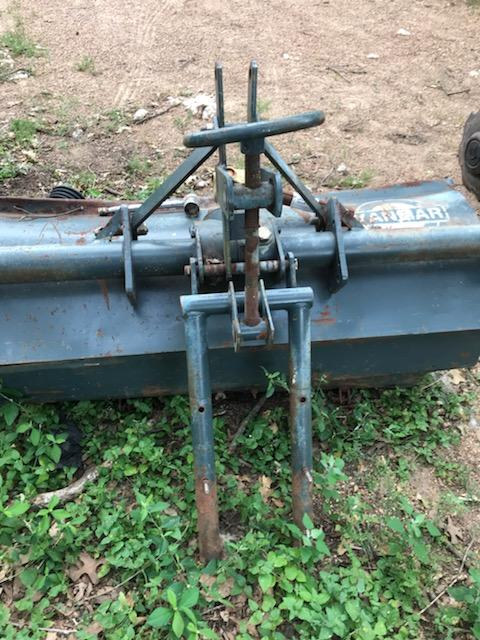

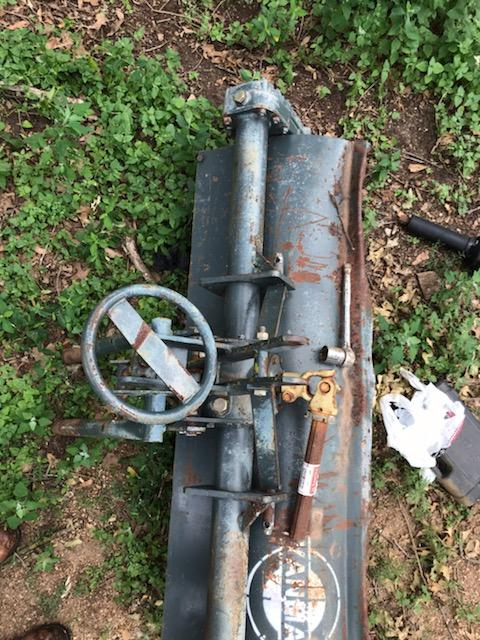

I'm glad you said to take more pictures cuz I didn't even notice that number yesterday

Ah ha, it has many ques to the RS Tiller series. If you can measure the side-to-side walls on the 'inside', then we'll know if it's a RS1300 or an RS1500 tiller.

It measures 48"side to side inside. And I've been taking off the tines, many are loose and theblts are ruty, so I am cleaning them up or going to replace. Looks like 2 diff size/styles tines. Will post pics once tey're all off.

48-inches = 1220mm. Thus, the Yanmar tiller is a RS1200 type. I'll look tonight for the RS120X variants to help you figure out exactly the right model.

OK, since the Yanmar logo marking and the color don't match up, the RS1200 and it's related RSxx00 family are in the first PDF. The second PDF is the RC1200, somewhat related, but added for good measure as your tiller is difficult otherwise to identify.
The 48-inches really narrows things down in a good way to the 1200mm (1.2M) width size.
