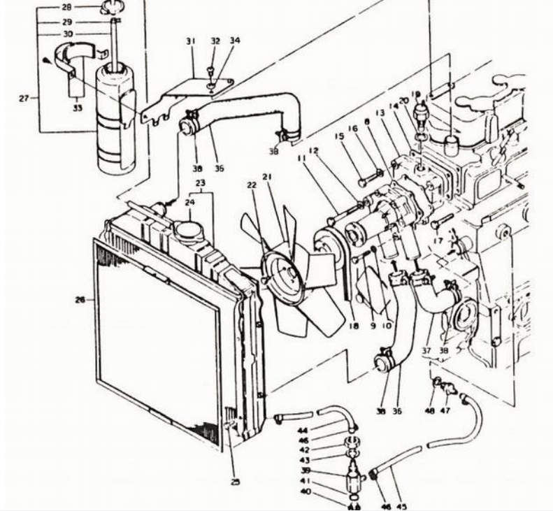

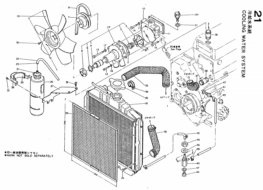

I am confused by the cooling system. The 2500 is not one of Yanmar's tractors that used a thermosyphon cooling system. It has a water pump, but no thermostat. I keep seeing reference to the 2500 being identical the JD850. The JD850 uses the same 3T80 engine, but a different water pump backing plate that accommodates a thermostat.
I'm confused by the design. What is supposed to keep it from overheating? Without any interruption to the coolant flow, even a new radiator won't be doing much to dissipate heat. It pushes coolant into the overflow tank and pulls coolant back into the radiator as needed. So the cooling system is working at some level. But that doesn't change the fact that I can turn off the engine and hear coolant boiling in the block. Hence, my concern and confusion.
/ Yanmar 2500 frankensteined #2
I'm familiar with this having a used a 2500. I went and looked and correct. No Thermostat showing in my Yanmar parts. I knew the 2000 didn't have one either. But! the YMG2000 does have a Thermostat. The 2500/2000 Temp. sending switch about it. Test the Pressure in the Radiator sounding like a bad Head Gasket. You can Rent one at most any parts store.

The YM2500/YM3000 Parts Manual shows,
The YM2610 has he same engine as well,

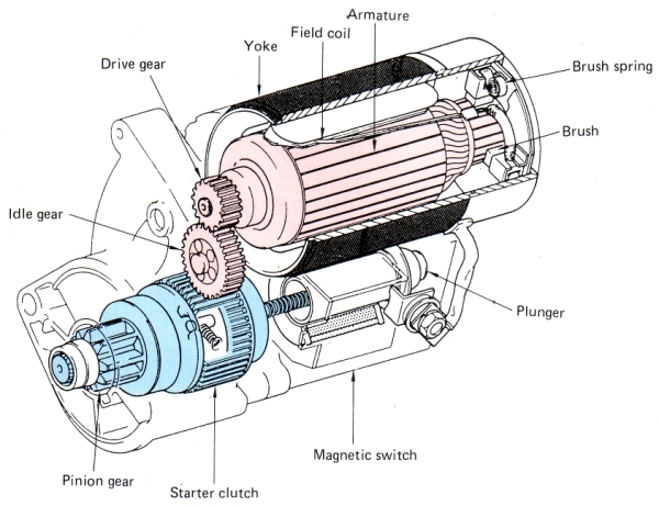

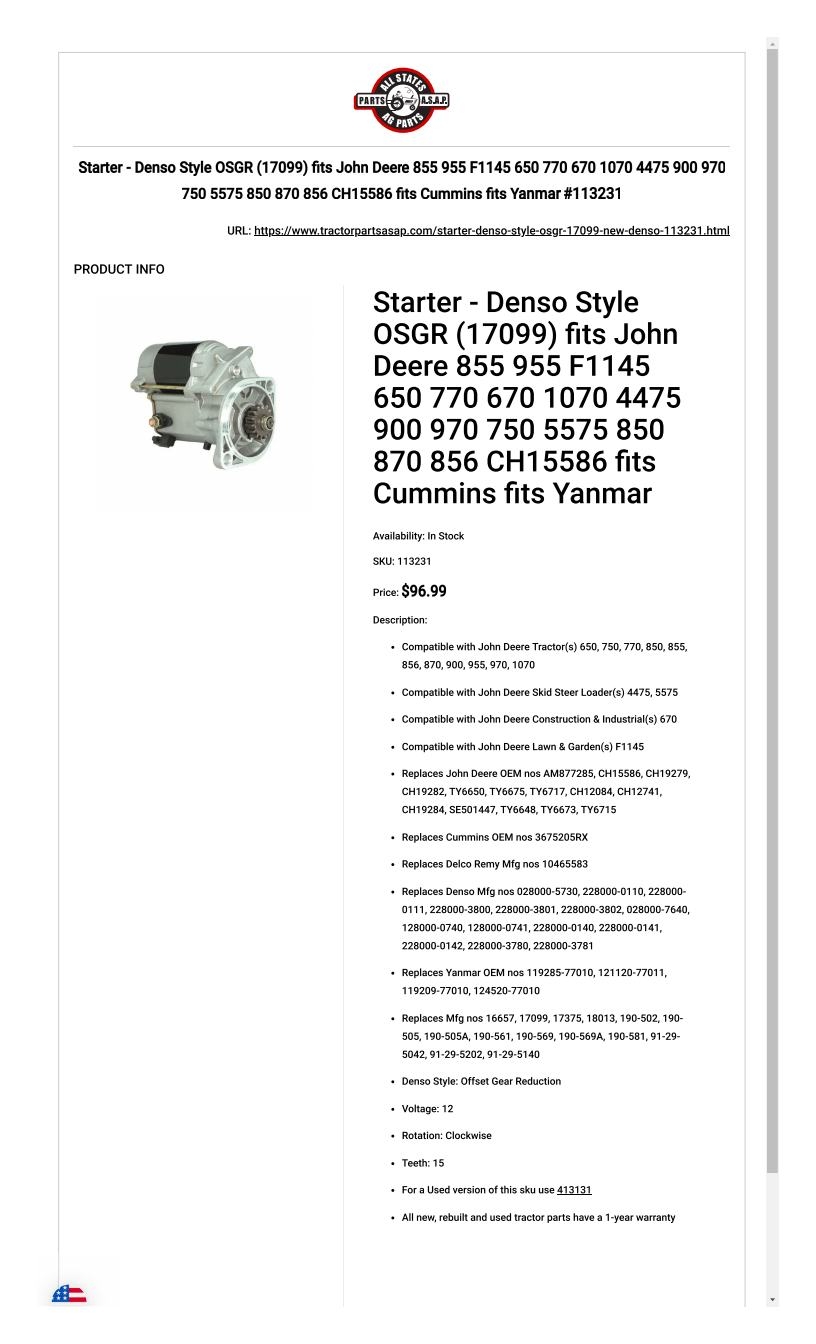

There is a starter upgrade available for the 3T80 engines. The old starters use a solenoid and turns at 1.2Kw of power, the newer technology is a OSGR starter and turns at 2.0Kw of power. Best of all OSGR starters draw less power from the battery. It's all done in the gearing. If you have a very old and tired starter, then upgrade.

old starters use a solenoid and turns at 1.2Kw of power, the newer technology is a OSGR starter and turns at 2.0Kw of power. ... If you have a very old and tired starter, then upgrade.
That starter or one very near the same is what I put on the YM240 to replace the bad amateur rebuilt I found when I got the tractor. It was under $100.
With the higher amperage and the gearing, it cranks much faster, so I expect this would even start a worn out tractor that doesn't have spec compression.
