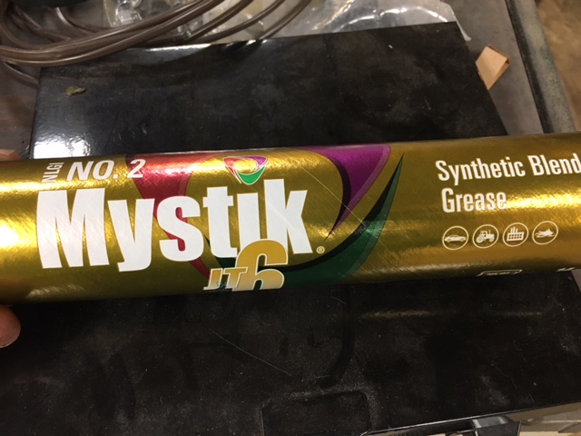

What type of grease had you been using? I am still wondering about the possibility of incompatibility between types of grease.
Grease I'm using: Mystik Store - Mystik(R) JT-6(R) Synthetic Blend Grease #2 - Product Details

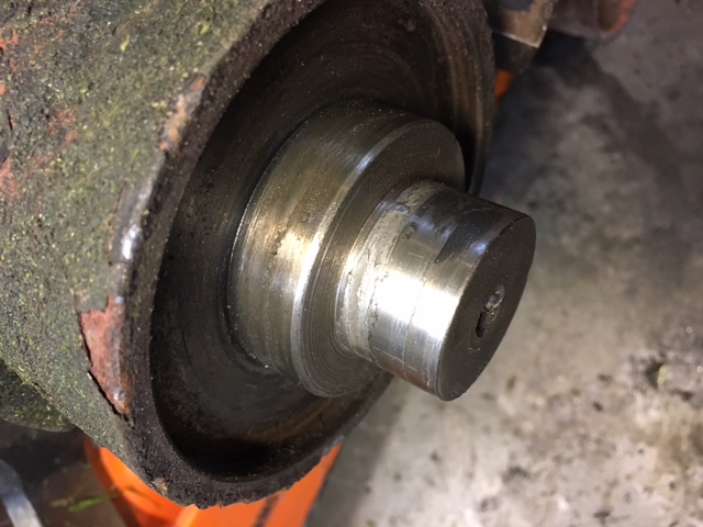

Bearing races all out, wasn't too bad. Inner race even spun a bit on the stub shaft - will need to clean that up.
For Leonz- seals do have a spring on the lip, that said they don't strike me as the highest quality, maybe mediocre. The outer seal on the drive side (between belt pulley and the outboard side of the bearing housing was installed crooked. If the replacement bearings are anything like the ones I've pulled out- straight to the recycle bin they go.
Edit - took another look at the seals and would upgrade to "good quality" - I don't want this to look like a "bash WoodMaxx " thread as that is not my intent- just reporting my experience. I fully expect to get years of service once this bearing issue is solved.. Obviously WoodMaxx has identified the bearing issue as they are advertising upgraded bearings.

Per Woodmaxx's website, they started using NSK bearings August of 2016.
The pictures of the bad bearing show "HRB," which is clearly a Chinesium product: Harbin Bearing Manufacturing Co., Ltd.
If you get NSK as replacements then you're probably going to be fine. These folks - FAG Bearings, INA Bearings, TIMKEN Bearings, NSK Bearings - ACES BEARING LIMITED - seem to lump NSKs with all the other big name bearing manufacturers: don't appear to me like they'd be peddling junk.

Just confirmed with WoodMaxx that they are sending NSK bearings as replacements for the failed China bearings. Good enough??

Thanks. Link says:
Mystik JT-6 Synthetic Blend Grease is a premium quality, multi-purpose, high-temperature, lithium-complex EP grease with excellent low- temperature properties
Should be A-OK. Lithium complex is the most common chemistry for tractor and other heavy equipment use.
For anyone interested:
The Skinny on Grease Compatibility
Grease Compatibility Chart
I harp on this because some of the more expensive greases, that are supposedly better, are polyurea based and incompatible (or potentially incompatible) with the common lithium complex. As of 10 years ago, Deere's preferred grease was a green polyurea grease, while most others on the market were/are lithium complex. (I say 10 years ago because that's when I owned a Deere tractor.)

a week and a day later my flail mower is back up and running. New seals and NSK (mfg in Japan) bearings and some re-assembly and we're back in business. I think I am going to follow the recommendations to give those bearings a few pumps of grease before each use. I suspect the failed bearing while greased on a timely basis there was not enough or in the right spots from the start.
