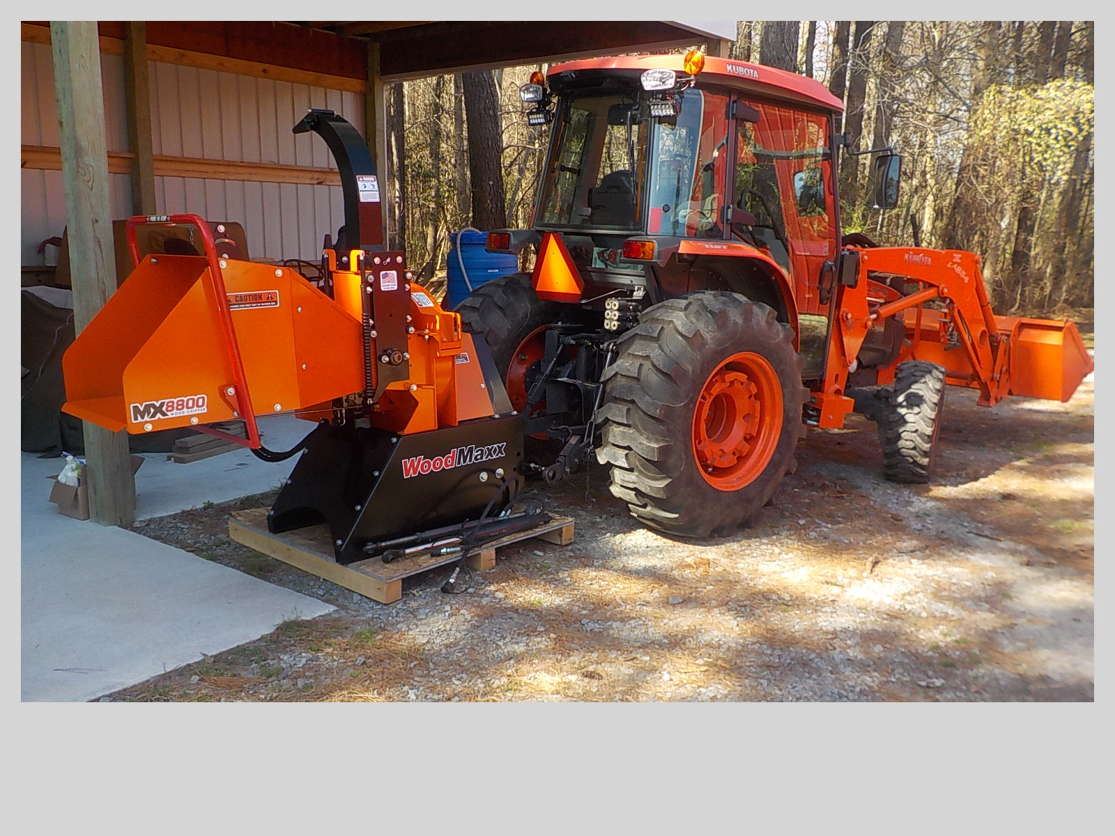

thanks Mike. Five years old, 175 hours, traded in on a nice fully automatic a/c kubota like mine, when the retired guy decided he had enough of having his brains baked out mowing with this thing. I needed a second tractor badly, had given my second one away to my Quaker Meeting in PA, and boy did i miss it. So when this one was sitting out in front of the Kubota dealer's front door as a trade in, well it really called to me. Made in India to an old Perkins design.
For sure will outlast me, and, and....
My increasing arthritis and spinal issues make it very hard for me to grip a pto shaft and get it on and off. Having a second tractor where I can leave the implement on, like the rear mower that will go on this when the chipper comes off, has been super helpful for me. What I found interesting was the old fashioned pto connector with the big push button is much easier for me to handle than the newer ones with the rings around them you have to pull back in one direction while pushing in another. I'm losing my grip, luckily only physically not mentally...;) so this Massey has been a big help to me. what I don't like is the live pto and funky rear hydraulics; they seem to be on or off and no in between. Likes to go up, and likes to go down, but hard to keep at any one level. I still have a lot to learn...

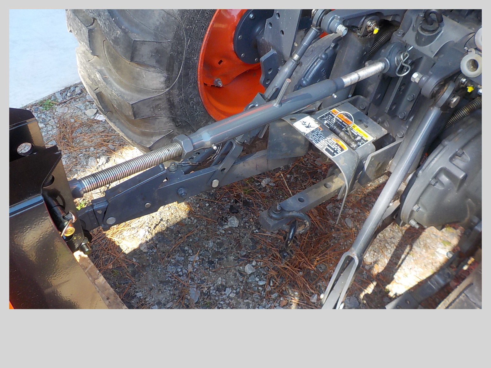

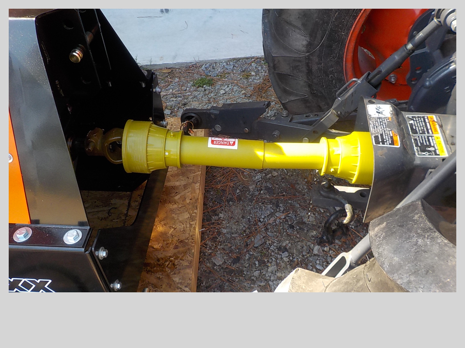

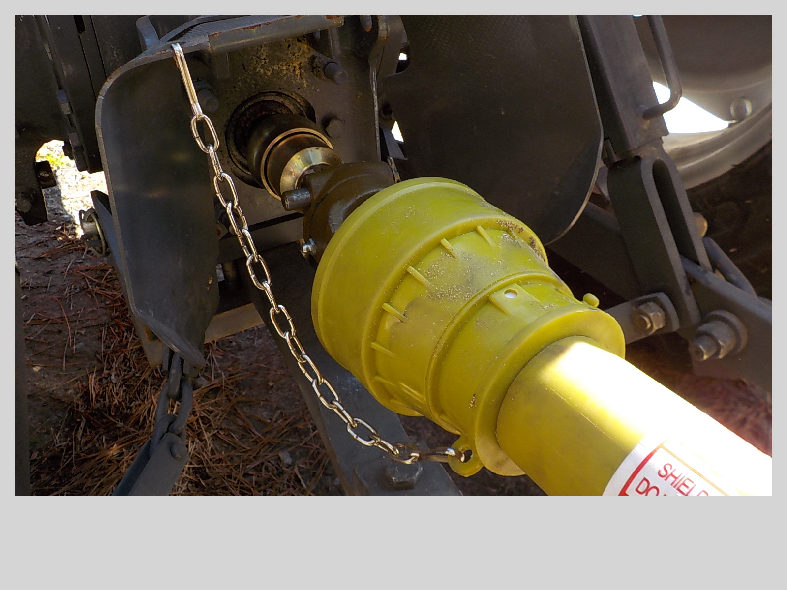

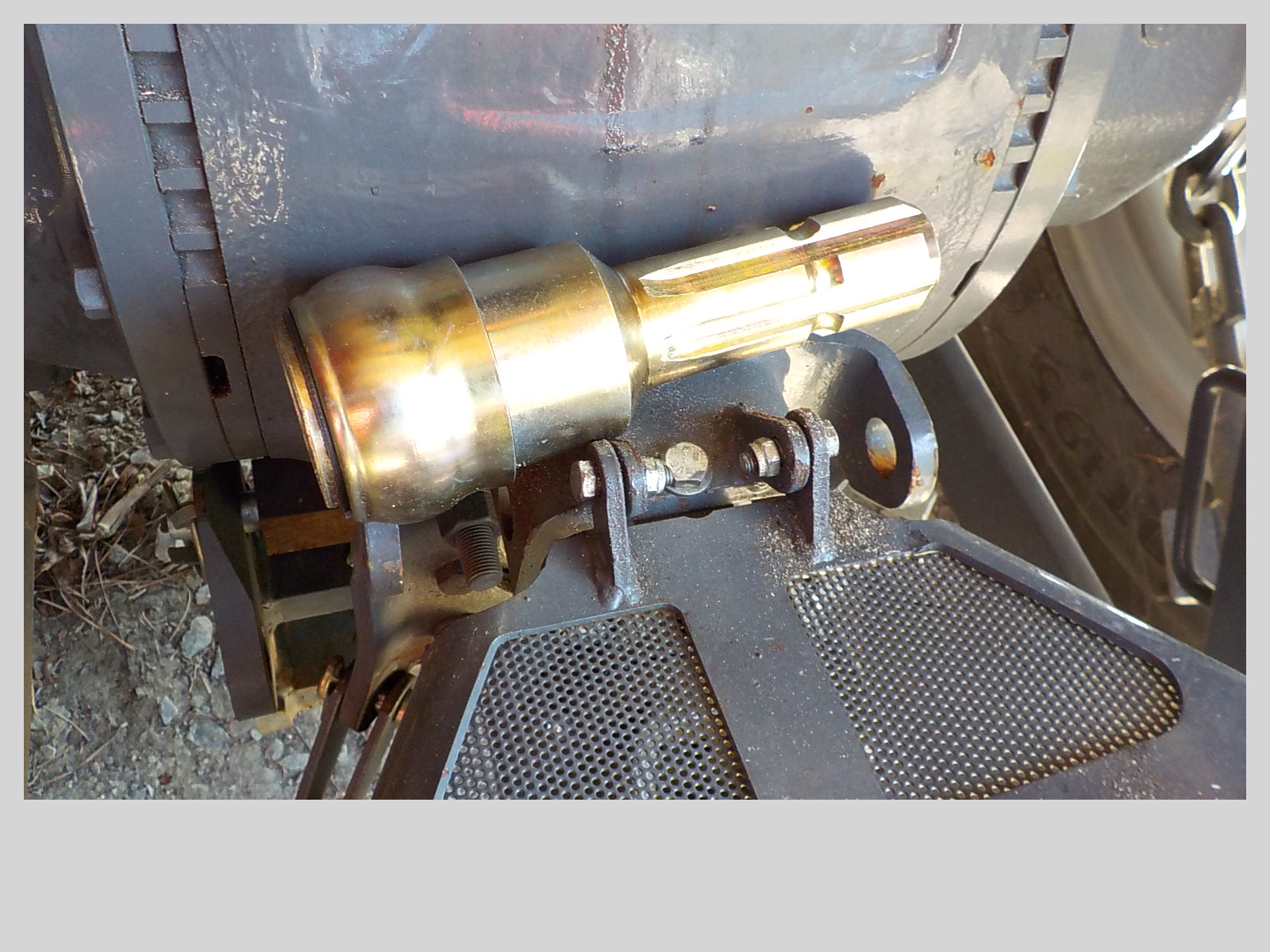

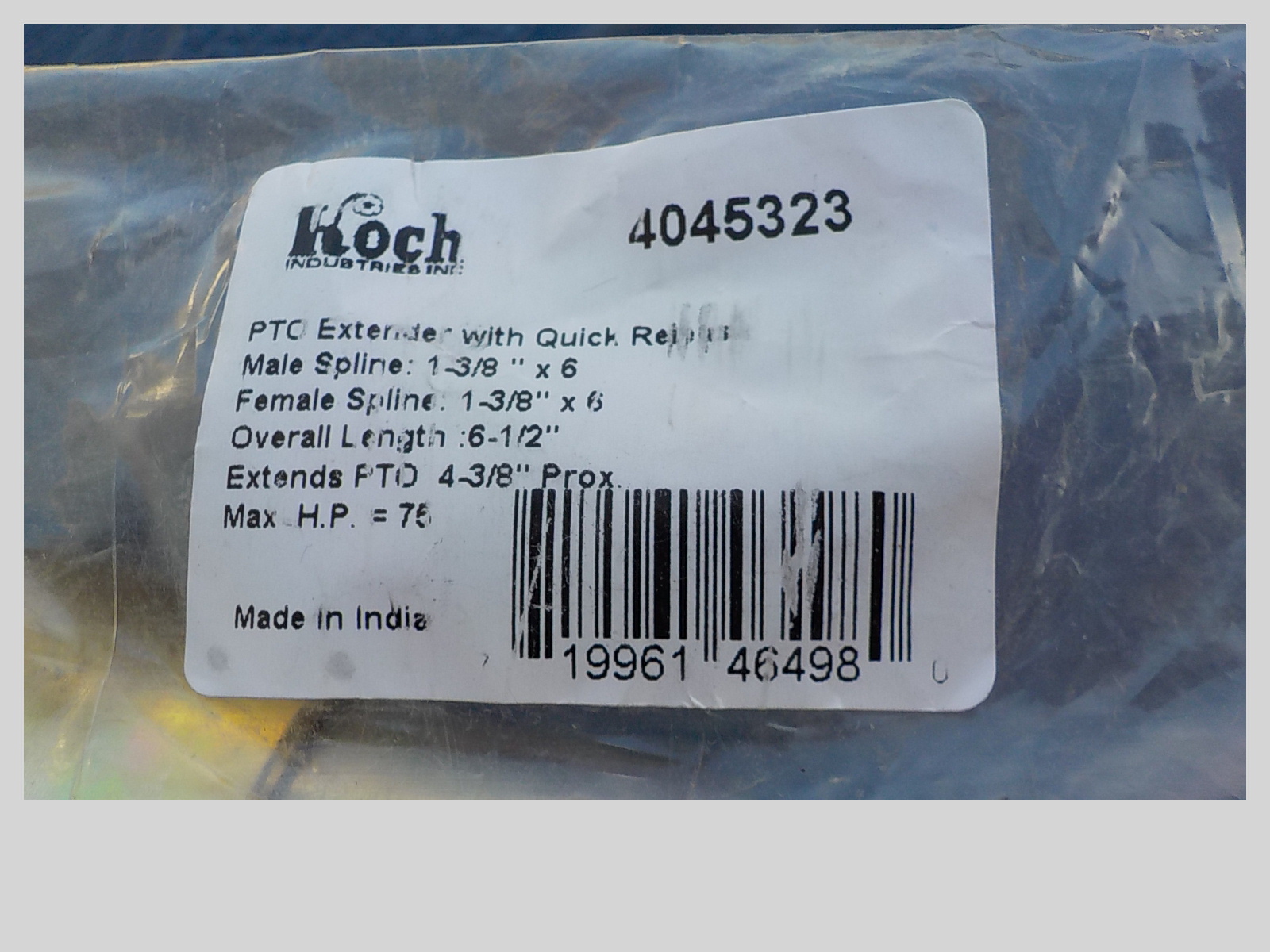

there were a number of pto shaft extenders available and the one that caught my eye looked heavier duty than the others, though it did have
a slip ring setup. It is very heavy duty, serious chunk of steel, went right on the shaft and the chipper hooked up perfectly, did not fall out when raised and still had a little
play when all the way down. I ran the chipper and it worked fine.
Then everything went downhill after I put the chipper away in its new prime spot in the shed. When I tried to hook
the Massey up to my Land Pride mower, the extension made the pto shaft too tight, actually too long now, so I'll just take off the adapter. Slid right of the tractor easy peasy. And then would not, despite my best efforts and getting utterly slimed in grease from head to toe come off the pto shaft. Stuck. Sigh. My strong fireman helper will just yank it apart tomorrow but a bit annoying. Never have a problem getting pto shafts off, but seem to be tortured trying to get them on. Someone needs to invent a Good Grips pto adapter...
Big tree down in the woods will be next project tacked with the chipper. The front woods look really nice now with all the junk cleaned up, like a shady glade.
I use an extender for my chipper too. I remove it when I remove the chipper
Extenders are very handy when one needs them, but I also think they can be tough on the PTO stub shaft bearings. And, none of us want to collapse a PTO drive shaft to where it damages the PTO itself!
Roy - I'm not sure I follow your statement. Are you saying that using an extender WILL damage the PTO stub shaft bearings? Or are you saying that the bearings would be damaged if the PTO shaft is "pushed" into the tractor as it is being compressed because it's too long due to the extension?

Mark, when I went to put the mower back on my Massey after taking off the chipper, I tried to leave the extension adapter on, wanting to see if the mower's pto shaft had enough play
left to absorb the extra length. It didn't....made the shaft tight from front to rear, and I thought it might push the tractor stub shaft back into the tractor, which is what I think Roy is talking about.
I'm not saying use of an extender will damage the bearings, but I think extended use of the extender may result in bearings wearing prematurely.
As far as your second question, if the PTO driveshaft is short enough to use an extender, you probably aren't going to damage the tractor's PTO stub shaft. However, as Drew did...best to check by slowly(!!!) compressing the drive shaft.
