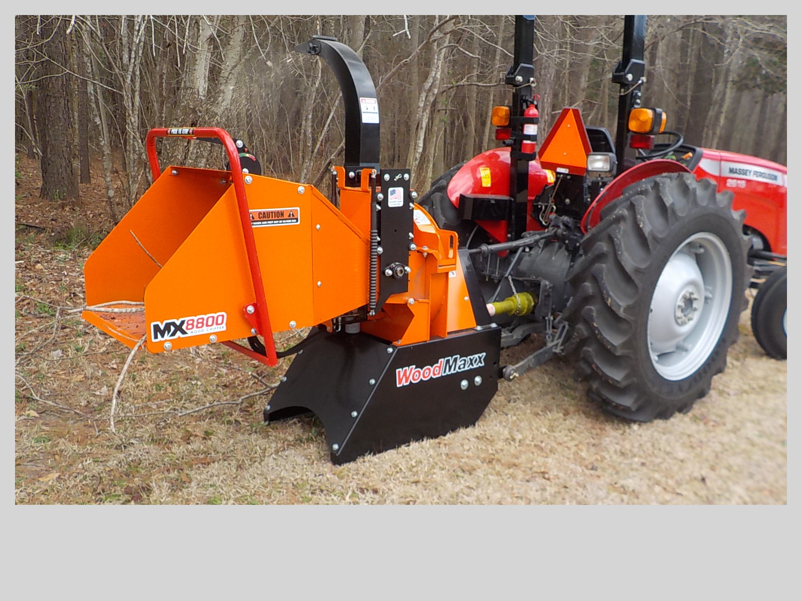

Was a nice day and found a good size branch that fell from one of the douglas firs so decided to finally test the wood chipper. Still waiting for all the snow to clear from around my big pile of branches you can see in the background.
Seems like it works pretty well.

I got my WM-8H yesterday, and spent most of today putting it together. Woodmaxx says 2 hours, it took me 8. I took my time and checked all the bolts including torquing the knife bolts and did almost all of it myself. Getting the panels aligned takes two people. I was working in front of the barn which has no power; power tools would have made it easier. Having all my tools in the barn would have helped too; I walked from the garage/shop to the barn about 40 times.
I ran some brush through it, mostly old stuff. It seemed to work well. I'll give it a more thorough test tomorrow.

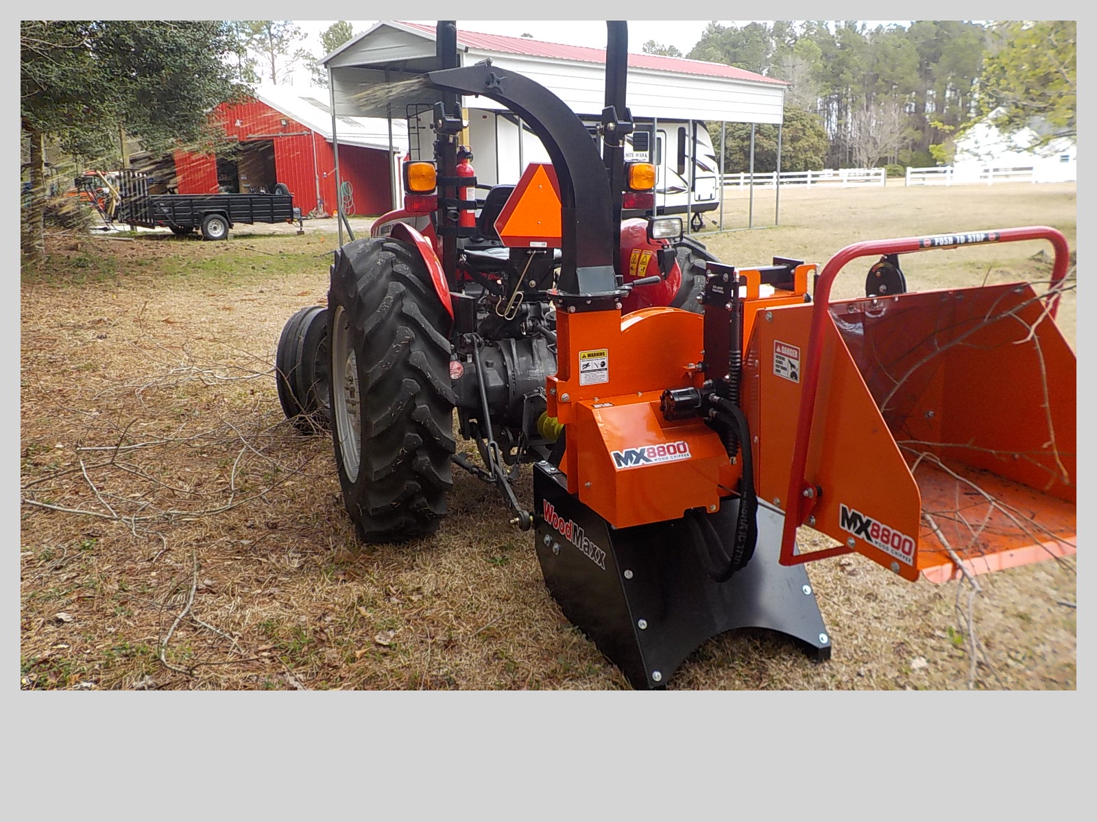

I got some time on the chipper this afternoon. It pretty much lives up to my expectations. A fir limb 6" at the butt and 25 feet long went down without noticeable slowing of the engine, on the fastest feed setting. It'll take small stuff too- if you can get it to the rollers it'll go down. However won't eat absolutely everything. A few things jammed in the feed roller, for example a thick limb with a stiff stub on the side. A couple times the vibration caused the feed to shut off. I think the emergency stop bar's weight does it.
The feed on mine seems a bit slower than I thought it'd be. It's probably fine and I'm just used to chuck and duck type chippers. It's fast enough to keep up with me feeding it, unless I'm giving it large diameter long limbs that I can't double up, I'm working from a pile, and I'm moving reasonably fast. I may find a contact tach and measure the roller speed.

I'm not sure my full speed feed is the rated full speed. I can move the speed control lever from 10 to 5 and the roller appears to be rotating the same speed. As I move the lever to 4 the roller slows suddenly to a crawl then stops moving entirely. I ordered a cheap contact tachometer to measure before I complain to Woodmaxx. The speed control lever is really stiff and does not need the stop screw to stay in place.
I chipped some more large fir yesterday and did have to slow the feed down as it was slowing the chipper too much with my Branson's 32 pto hp. It's still acceptable; I won't be doing lots of that. I got a piece wedged in the feed opening- a stub on a 6" limb jammed in the travel slot for the feed roller. Had to jam the roller all the way open and use a sawzall on the stub from the side to get it out.

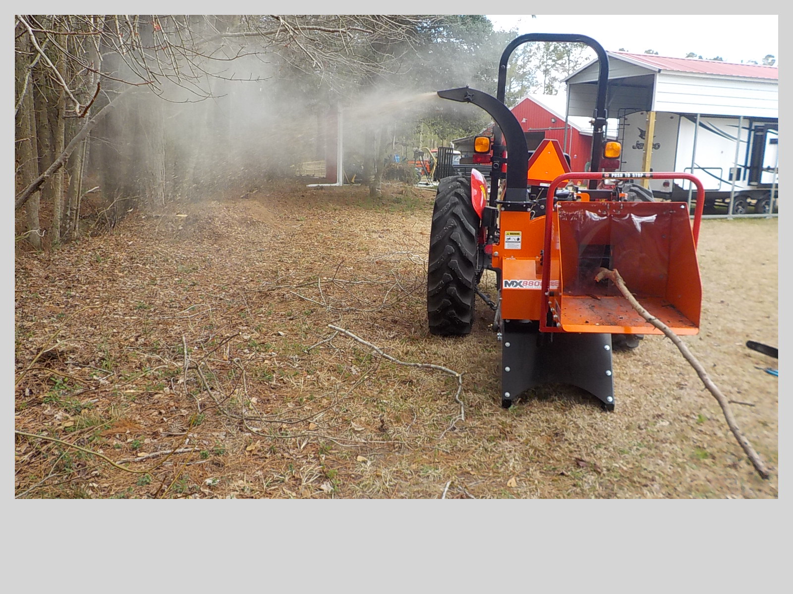

Finally got to start working on my huge pile of branches for about an hour today. There's still snow on part of the pile and a lot of the branches were still stuck together with snow but was able to get about 1/4 of the pile chipped. The Woodmaxx chipper worked great. No jams and it took in even gnarly bent lodgepole branches without a hitch. I thought I would have to trim them but the chipper handled them no problem.

I measured the feed roller RPM- at max speed it's 45, which corresponds to the advertised 75 fpm.
But it's 45 rpm for all settings of the speed control from "10" to below "4". Around "3" there is very narrow range that's 17 rpm, about 28 fpm.
And below that it's 0 rpm. It's difficult to hit the 17 rpm speed.
