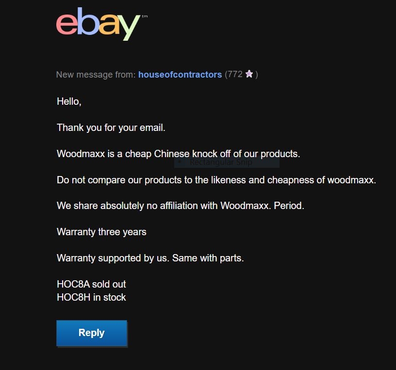

They claim to have been in business 20 years and through the wording of their ads/website they some what lead one to believe their units are made in Canada. They also claim The Woodmaxx is a knockoff of their unit? Their website sounds like it was written by an experienced used car salesman.:rolleyes: THEIR VERSION LINK

is this the same company?
yelp reviews

Would appear as so, A Big THANK YOU for that. The response I received from them on Ebay concurs with the yelp postings IMO
