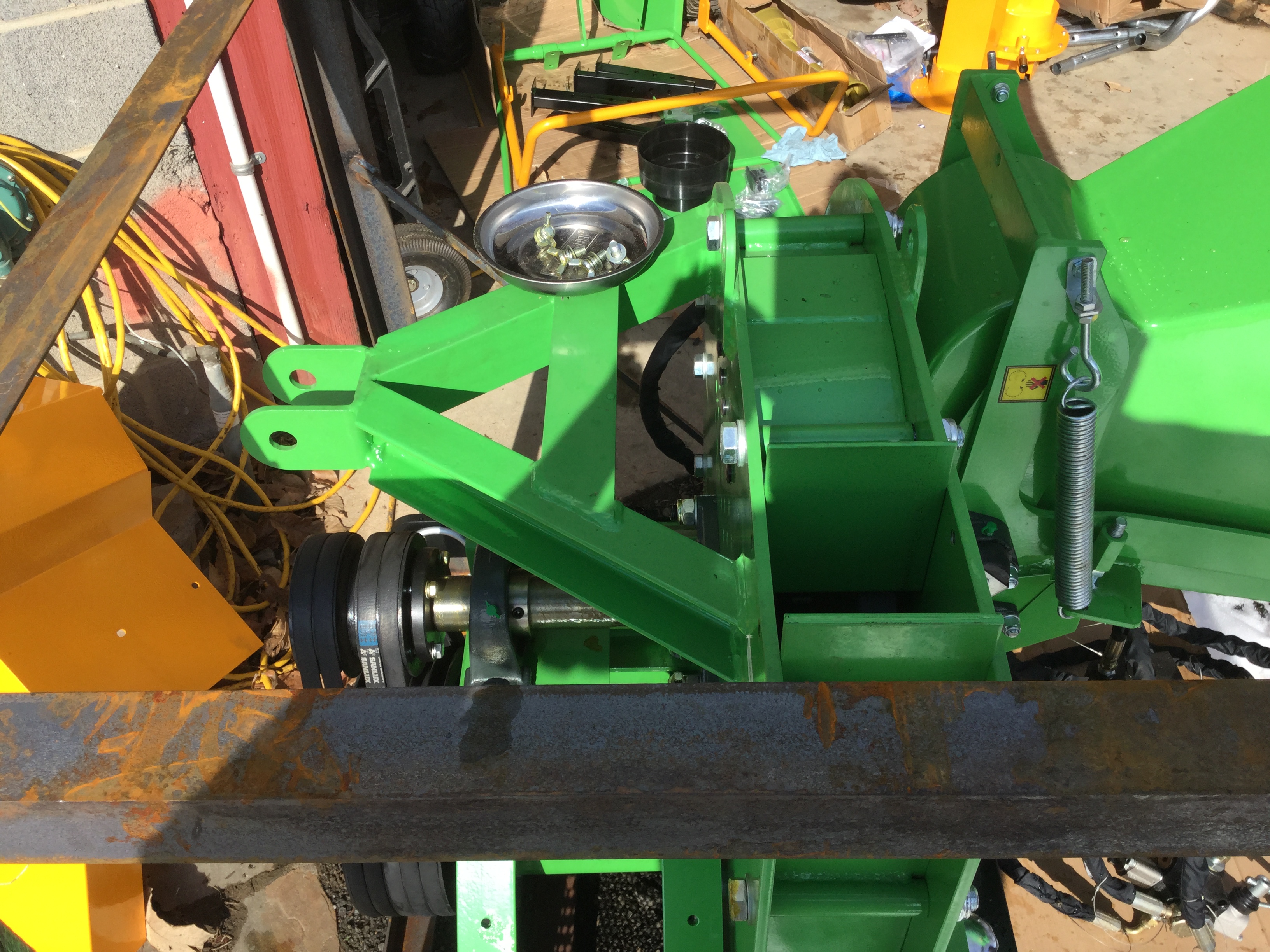

Another vote for customer support. I have the chipper on a job clearing down to a river, I’ve been there all week. Took some leave from my real job just to get some side work done now that spring has sprung. Like a Moron I parked the machine sideways on a hill, the chute was uphill by a good deal (100% my fault) well I clogged the chute and smoked the belts. I was upset at first but sometimes the best lessons are the hard ones, man I’m good at the hard ones. Anyway once again it’s Sunday and I sent an email to customer service. Guess what I got an immediate reply and they are expediting my belts out. Again this is my fault and I don’t work for Victory but they sure are taking care of my self inflicted issues. Big thumbs up.

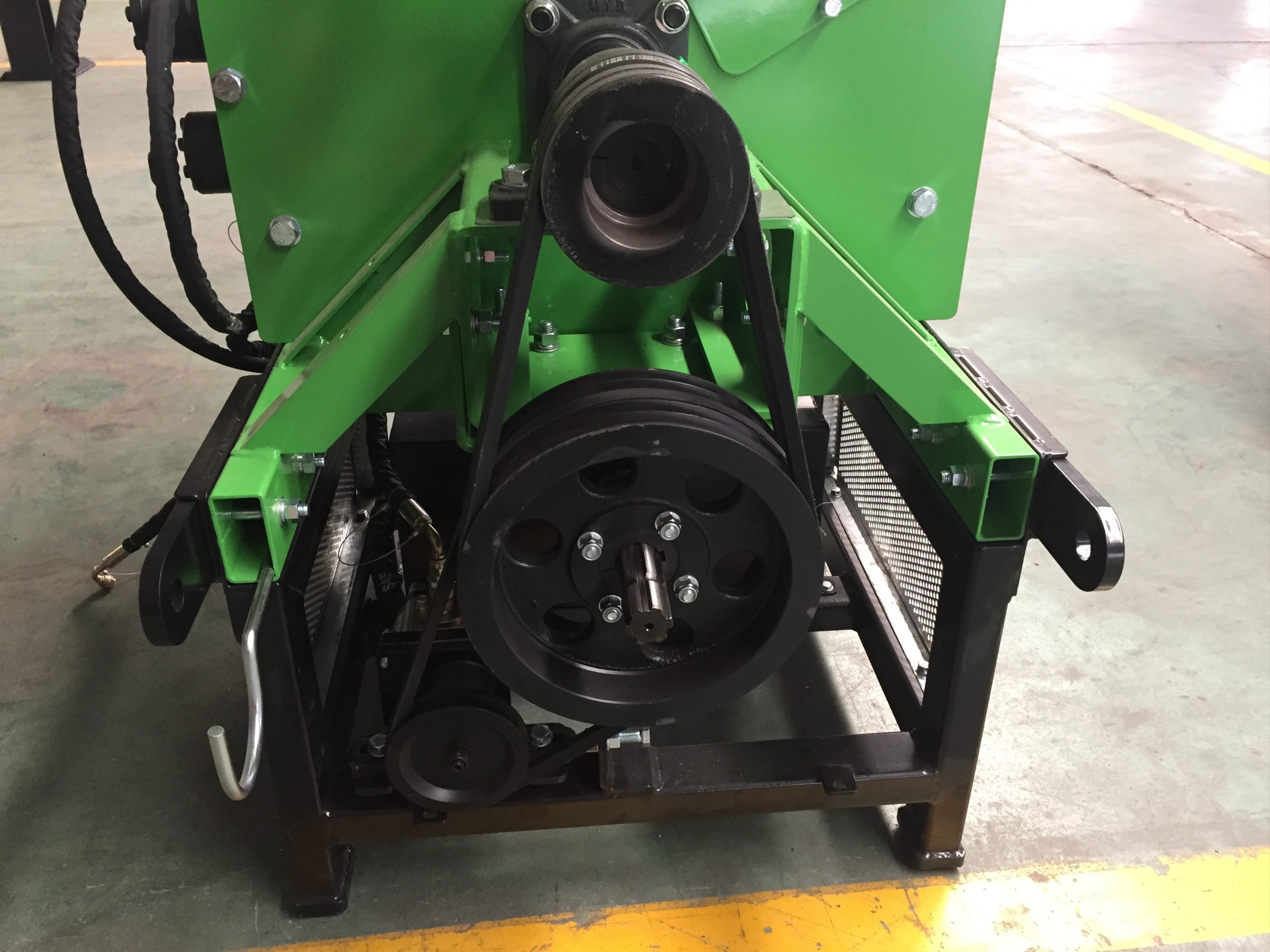

Remove the cover, you can see those bolts inside, then loosen some of them and replace the belts.

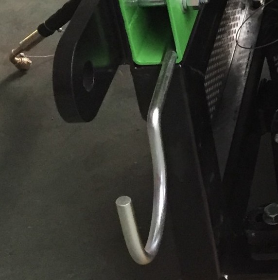

What is this? Is it a PTO hanger?

Depend on what tools you have. With wrench driven by air pump, I can replace it easily. For most people only have common wrench, well, it depend on if how strong you are. We always tighten these bolts very tight.

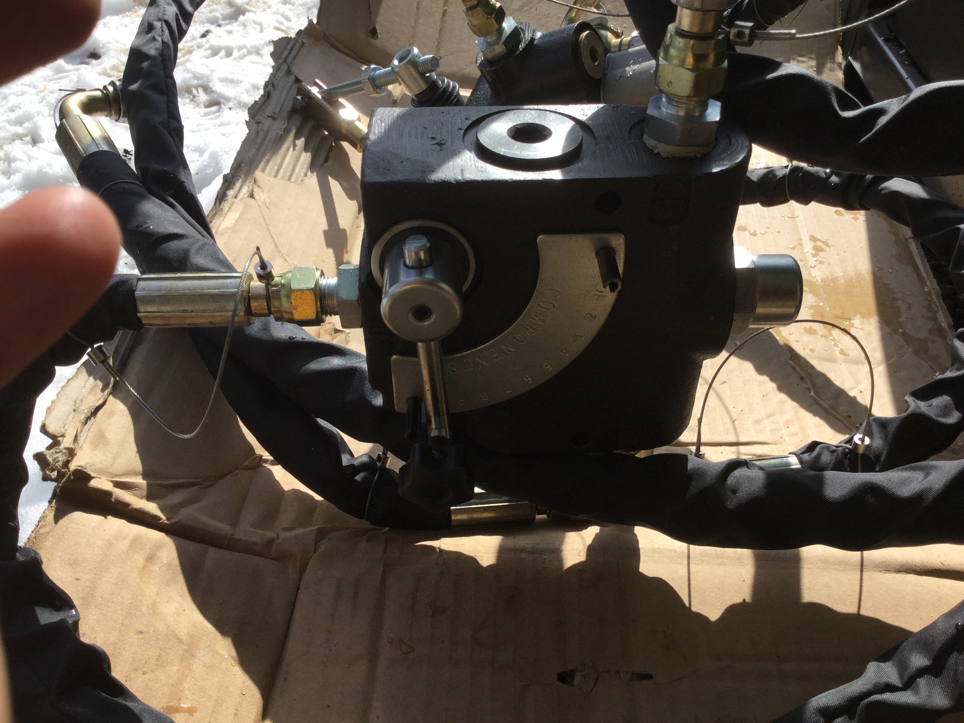

As far as having to get it started, the infeed rollers are adjustable. I happen to have mine super tight for smaller material so when big stuff comes along you have to pull the handle to get on top of them. I could change it but the job I’m doing has a bunch of small stuff and if I went up a bit it wouldn’t grab the little guys.

Changed out the belts yesterday, it was raining so I didn’t get pictures. The lower pulley is set in a cradle, you loosen 4-18 mm bolts that hold it tight and you have 4-8mm, 2 front and 2 back that are used to adjust tension on the belts and adjust alignment.
I also loosened the pump bolts and the pump tension adjustment bolt (so a total of 3) just to have maximum room. This step is probably not needed.
It took me 30 minuets or so. Now I know how it works and bet I could do it in 10 easy. It was really simple.
/ PTO Chipper, Victory vs Woodmax
#59
In hindsight after pulling things apart you have a lot of room for belt adjustment, I bet I could have tightened them up and kept on running. I’m glad I didn’t because now I have a far better understanding of how the drive system works and I can keep a better eye on wear and adjustments. Plus I have my original set of belts for an emergency back up, haha.
/ PTO Chipper, Victory vs Woodmax #60
Assemble the cover asap, be safe. :)
