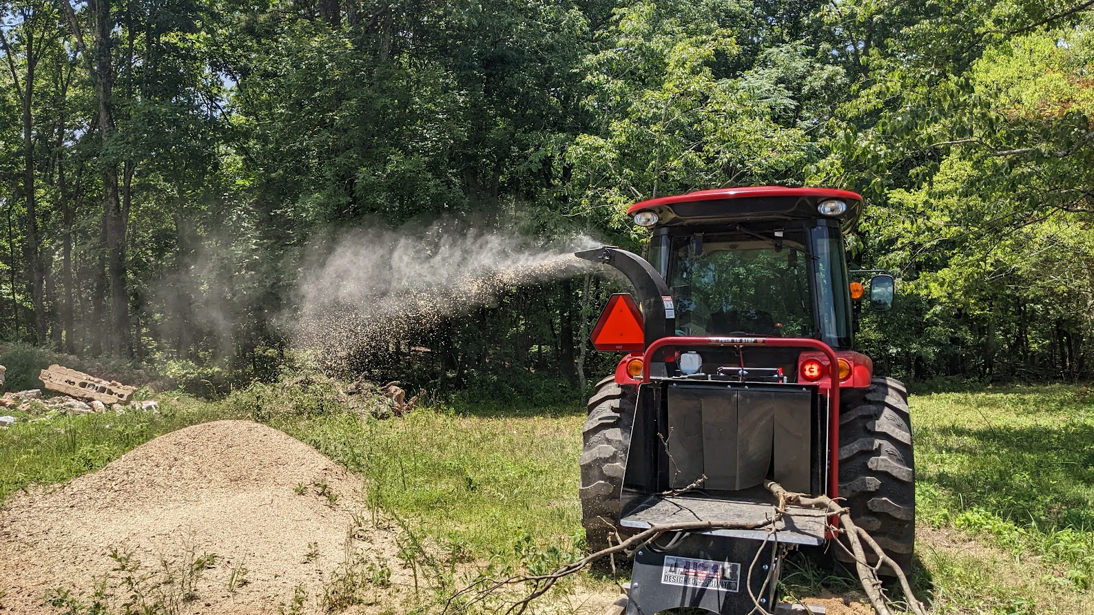

FWIW, I bought a Victory 8” chipper 2 years back (it is basically a clone of the Woodmaxx 8H). Bought it as the other two brands I was considering at the time either had very long lead times with no committed ship date or a waitlist where you were notified via email when stock was ‘available’ and it was a crapshoot if you’d be one of the ones that got in the queue quickly enough. Victory gave me a committed ship date ( and actually beat it by a week iirc). Quality was generally acceptable, assembly instructions were hit and miss.
In retrospect I’d buy the largest unit the tractor can handle with ‘reserve’ cushion at the PTO. There wasn’t anything larger from Victory than the 8” hydraulic feed unit that I bought.
Don’t know why I don’t have a picture of the thing assembled-I’m going to be engaged in a chip fest this weekend-maybe I’ll remember to get a photo.
