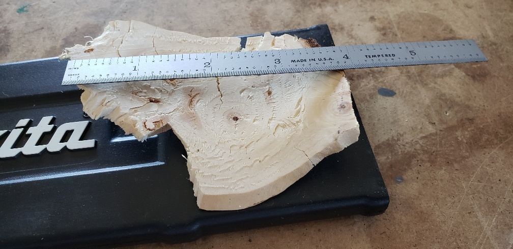

I have the woodland mills wc68.
With my 2720 or 3039R for power, they have never bogged down.
90% of my chipping has been with live spruce.
Since most of your chipping is with cedar, also a soft wood, you can most likely jump up a size in chipper with your 31 pto hp.
Here is a chip of Norway Spruce with made by the WC68 and JD 2720.

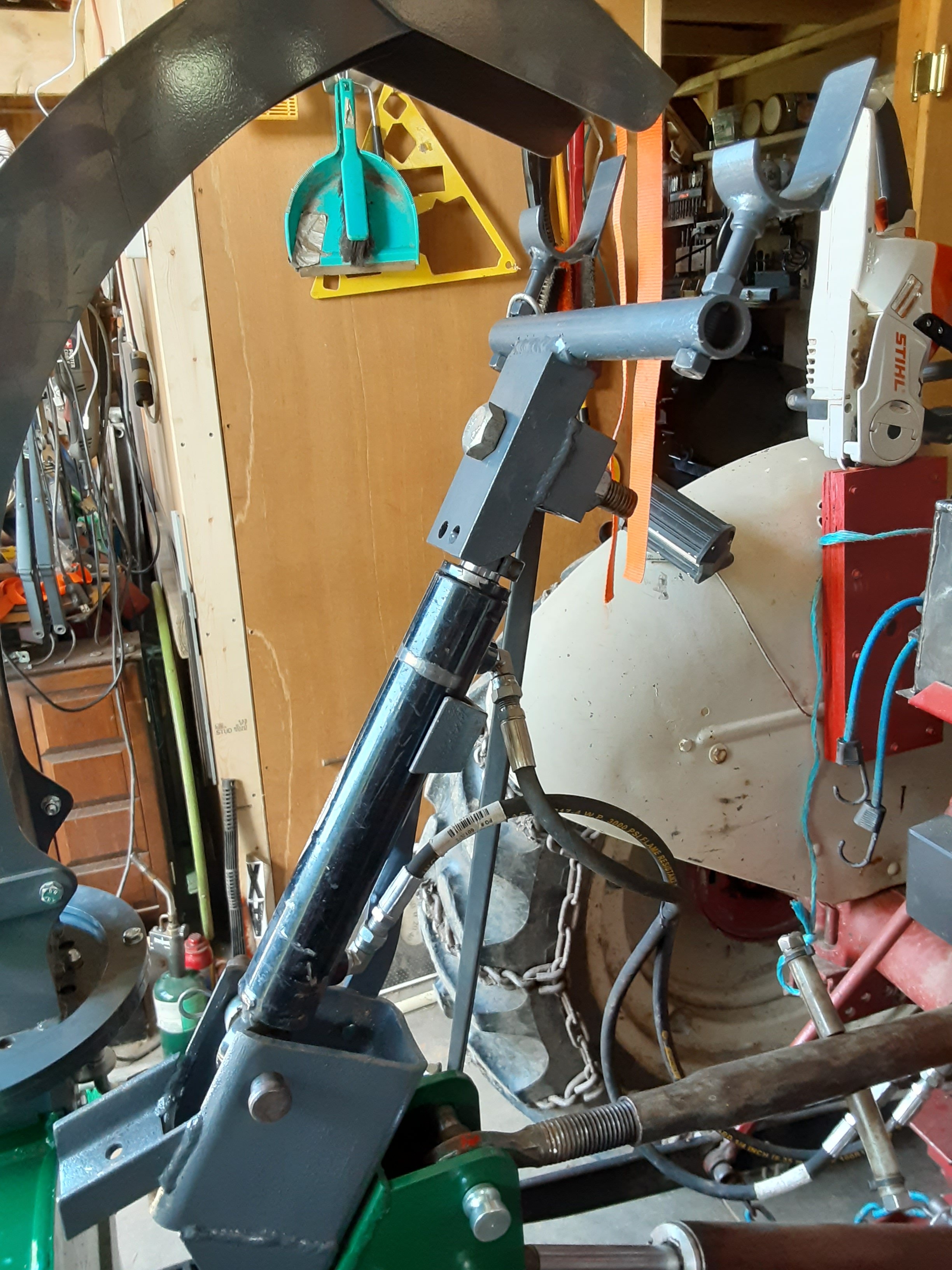

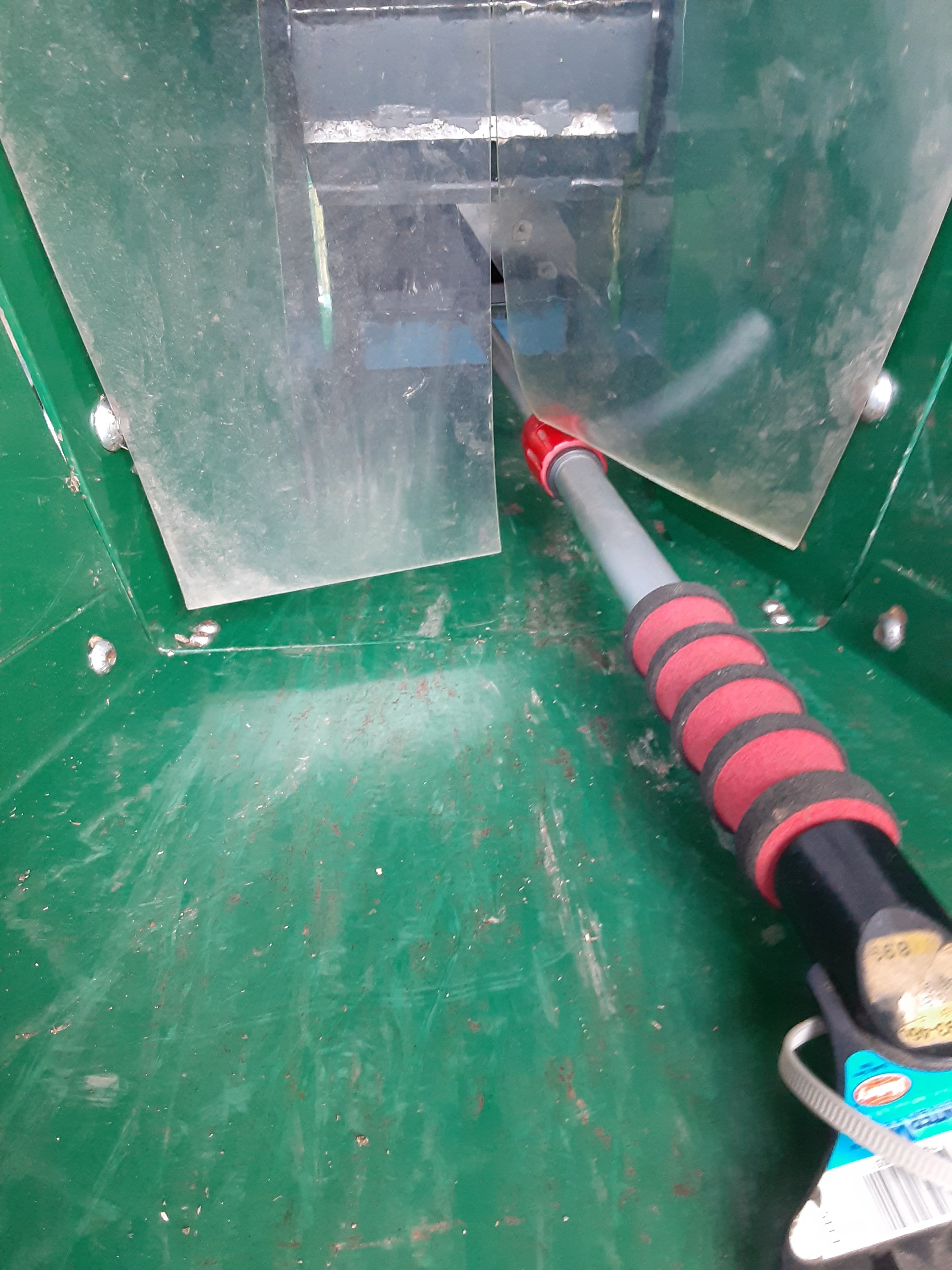

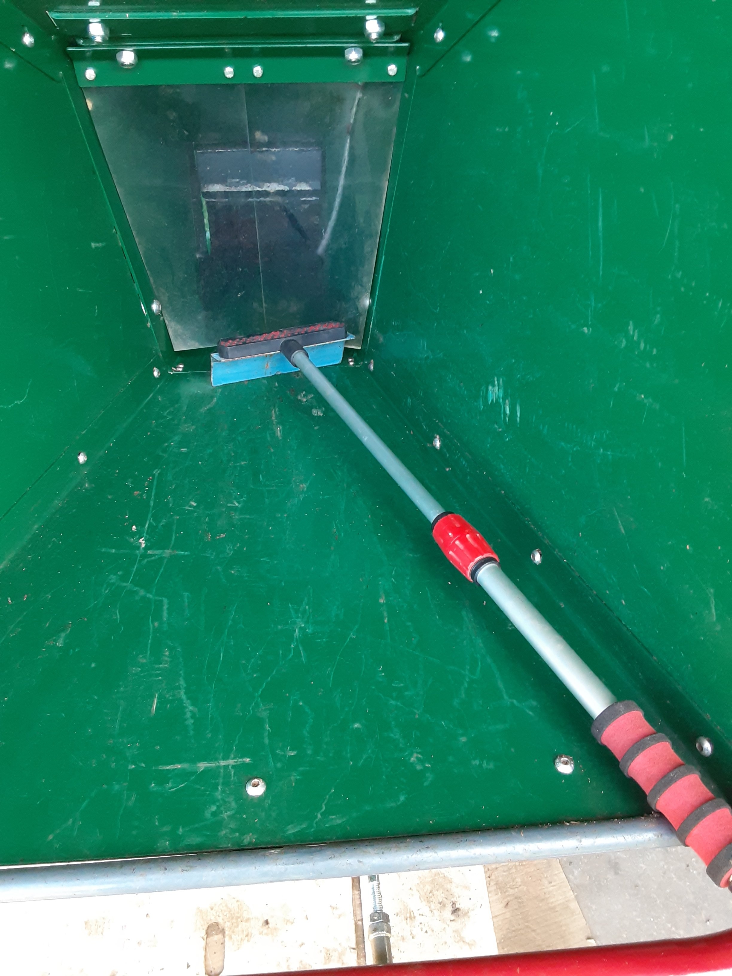

I found it plugs up a lot sometimes stalling the 8N. I haven't tired it on the Kubota yet as I have the backhoe on that a lot. I found you can use a small jack to push the roller back and up to clear a jamb of course after taking the pto out of gear.
I since made a hydraulic ram assembly to do that that just flips down and pushes. Again pto out of gear. I got pictures somewhere.
OK the jack was left over from my 93 ford ranger, the adapted snow brush with a piece of metal on it pulls the pieces out when it clogs. AGAIN with pto off and roller raised. But the hydraulic really works slick. I can clear it out in just a couple minutes without wrenches and messing with springs etc.
