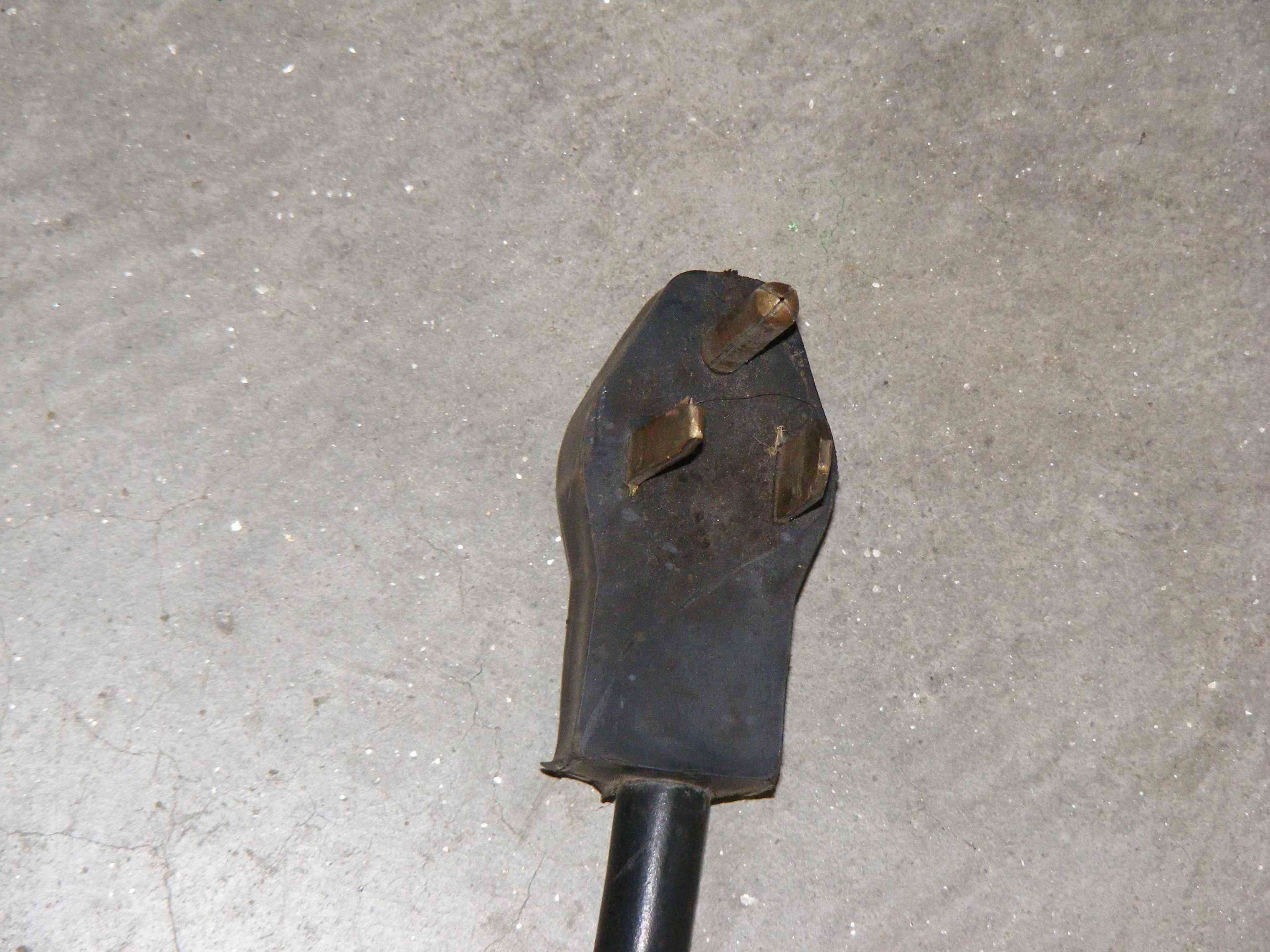

The picture is on this post. Now that I look at it and google the 6-50R one they look to be the same. So no range plug.
Yes that is a welder plug, a NEMA 6-50P which mates to the NEMA 6-50R that welders should be using.
Ah, Yup! That is what comes on the Lincoln Buzz boxes. I think I recall they are rated for up to 250 volts and 50 amps so they are "T H E T H I N G" for your application.
