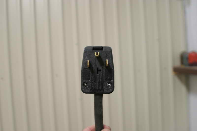

Hey Spiker,
The NEMA 10-50 doesn't have a ground, so I'd suggest a NEMA 14-50 in it's place for new applications. Any like configuration plug that has an independent ground should be given favor over the non-ground wire version. NEMA 14-50 plugs are becoming more and more common for stoves in new construction. They are also the same 50 Amp plugs you find at RV camp sites.
I just converted all of my shop's 220V outlets to NEMA 14-50 and changed out the plug on my MIG welder to match. The most common welder plug is the NEMA 6-50 as most welders don't use the neutral. However, you can wire a welder to a NEMA 14-50. Just don't install the neutral lug on the welder end. Now, I can take my welder outside and plug it into my RV outlet or take the RV inside the shop and plug it into my welder outlet. Plus, my Miller TB302 gas powered portable welder has a NEMA 14-50 outlet for the 10kW generator, so either RV or MIG welder can run off it. Heck, I might even take my kitchen stove out to the shop and plug in it. And, it's all up to code.
