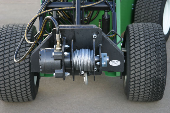

Maybe something like this 3000 psi hyd winch. Mount it on the front or back.
/ winch implement? #14
I used to have a MileMarker hydro winch on a 4x4 many years ago and I think the millitary used them on the HMMVs as well. Tow trucks use the Ramsey hydro units to pull dead cars onto the flatbeds.

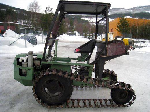

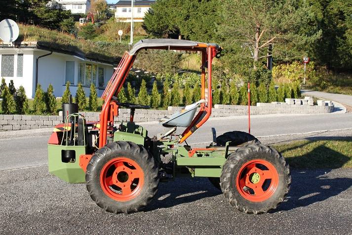

Winch on 2 wheel tractor was quite common in Norway in the period after WW2 until 1970 when many two wheeled tractors were converted to small forest machines to replace horses. The winches consists mostly one worm gear to lower the speed, the clutch brake and a drum. I have one of these machines so I can take a picture of the winch during the weekend.
These are two examples of how two wheel tractor have been modified

Wow that should be a thread all itself. I want one.
/ winch implement? #17
View attachment 357658View attachment 357659
Those are two wild machines.
