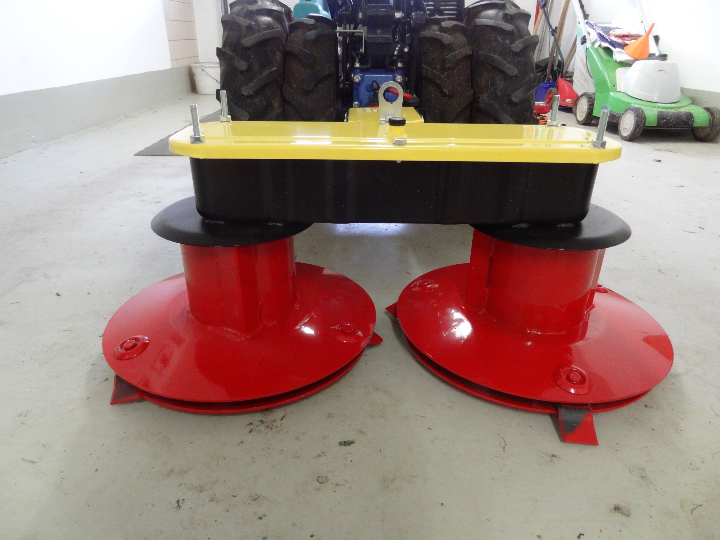

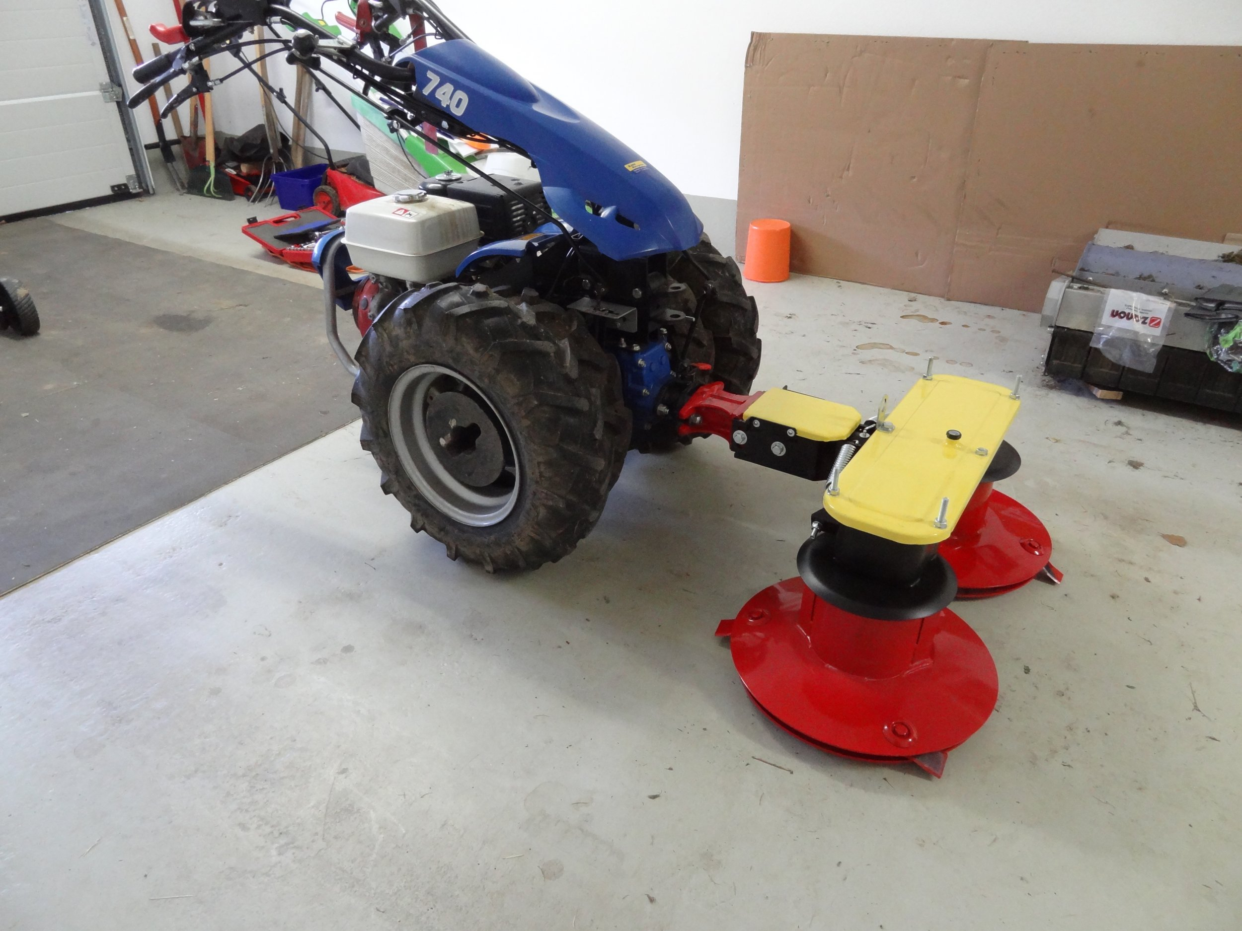

Last winter I decided to treat myself with a drum mower for my BCS 740, so I ordered a Zanon ZRF 1000 with a working width of 40’’. I plan to use the mower to mow tall grass on my own meadow, and to help friends and neighbors mow theirs. As this type of rotary mower hasn’t been mentioned much in this forum, it might be helpful with a little presentation first:
https://www.zanon.it/en/p/zrf-falciatrice-rotante/
The PTO-flange and the gearbox housing is similar to other Zanon mowers that I am familiar with, and the driveshaft housing has the Zanon-typical oscillating swivel-joint, that allows the mower to follow the contours of the terrain. The gearbox powers the two vertical drums, that each ends in a spinning horizontal disc with 3 hinged blades. Underneath each rotating disc is another disc on witch the mower glides over the terrain. The two photos below shows the business-end of the mower without the protective cover.
The entire mower makes the Zanon-typical heavy-duty impression, that I am familiar with from my Zanon ZCR lawn mower.

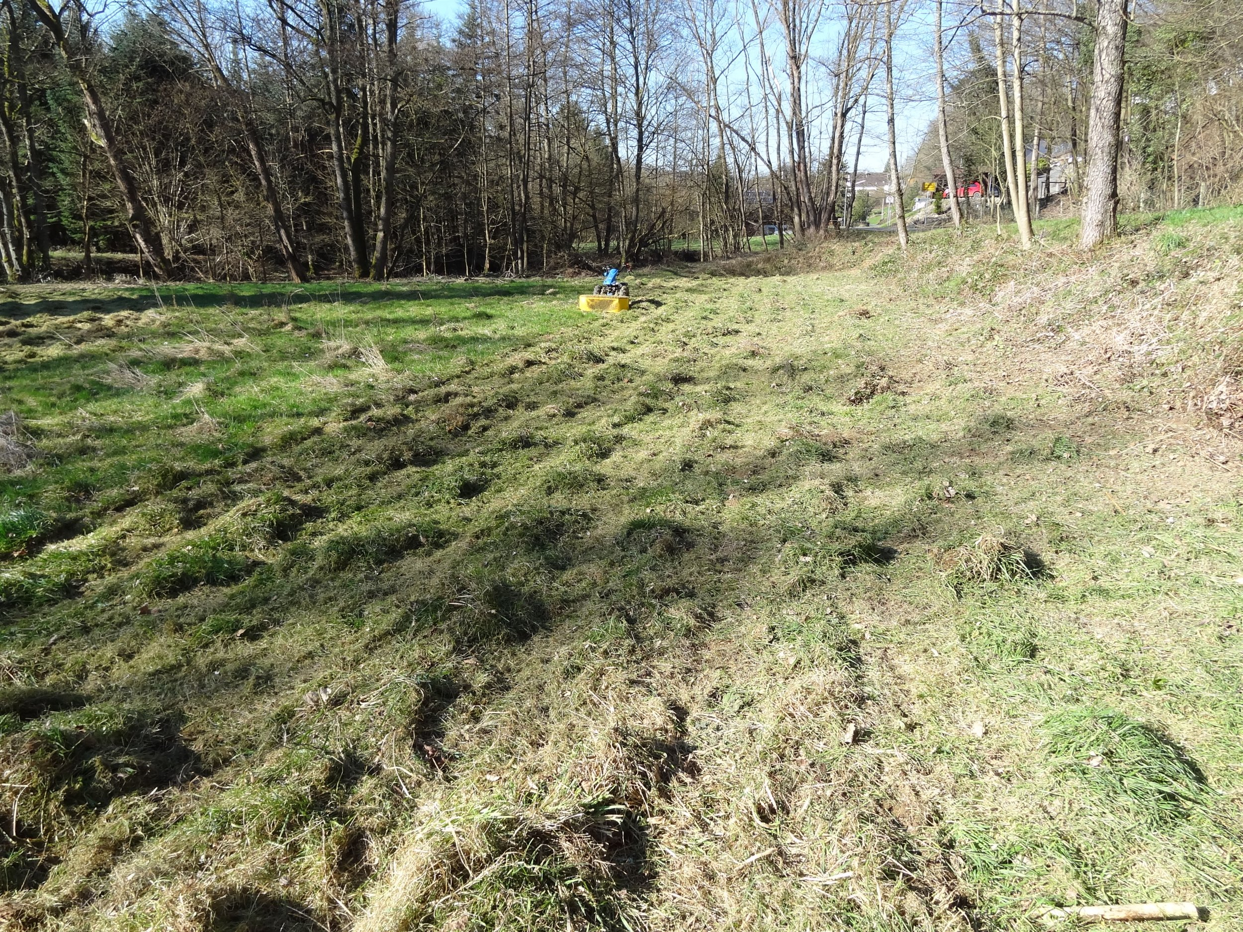

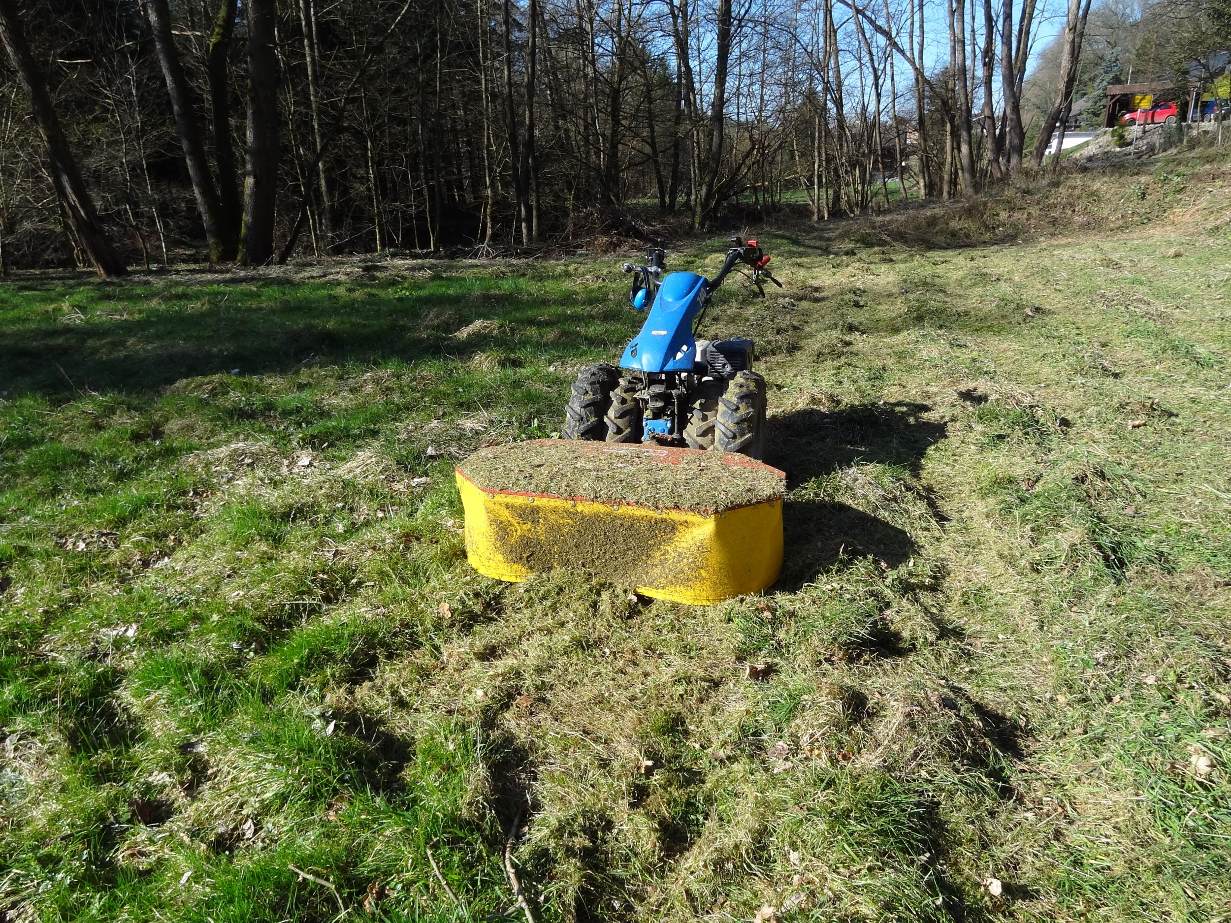

Early March I was trying out the mower for the first time, mowing a bit of my meadow.
The drum mower turned out to be a very power-hungry implement as expected, but I was able to mow in 2nd gear with my 23’’ tall wheels at all times. Compared to my experience with a sickle bar mower, the drum mower throughs more clippings and debris around, as can be seen on the second photo.
As with all rotary-type mowers, it is important to operate at full open throttle - or at least close to full open throttle. There are at least two good reasons for this:
  1. Contrary to a sickle bar mower, all rotary-type mowers are very power-hungry, as the engine has to keep the blades rotating at high speed. Zanon recommends app. 3/4 full open throttle, which is 2700 rpm for the Honda GX 390 engine. From this speed and up to the rated speed of 3600 rpm, the engine produces 86-100% of its rated power. Equally important is the fact that the engine operates above its peak torque at 2500 rpm, allowing a curtain torque rise should the mowing conditions get tough.
  2. The hinged blades on the mower are kept „straight“ in their working position by centrifugal force, created by the spinning discs. As the magnitude of this force relates to the angular velocity squared, a small reduction in engine speed, will give a large reduction in the mowing capacity. A reduction like the above mentioned from full open to 3/4 throttle is equal to 25%, but the reduction in centrifugal force is almost 44%, leaving only slightly mere than half the centrifugal force to keep the blades straight!

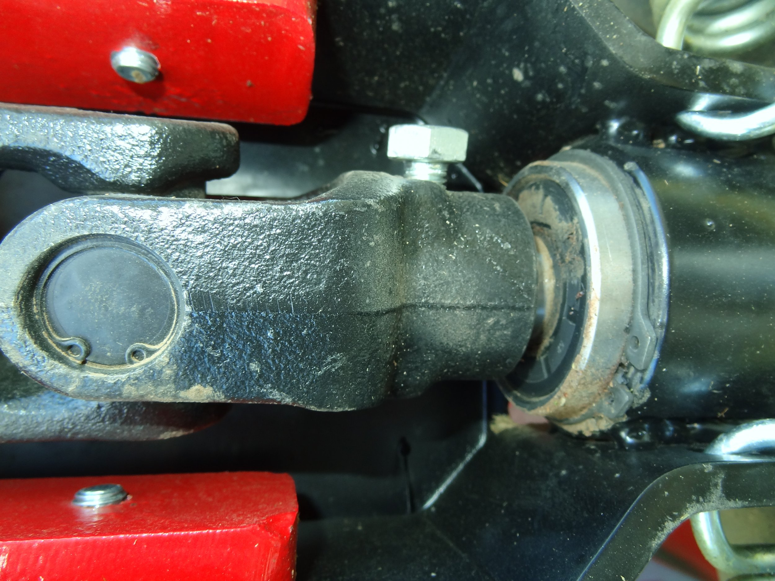

Hi ;)

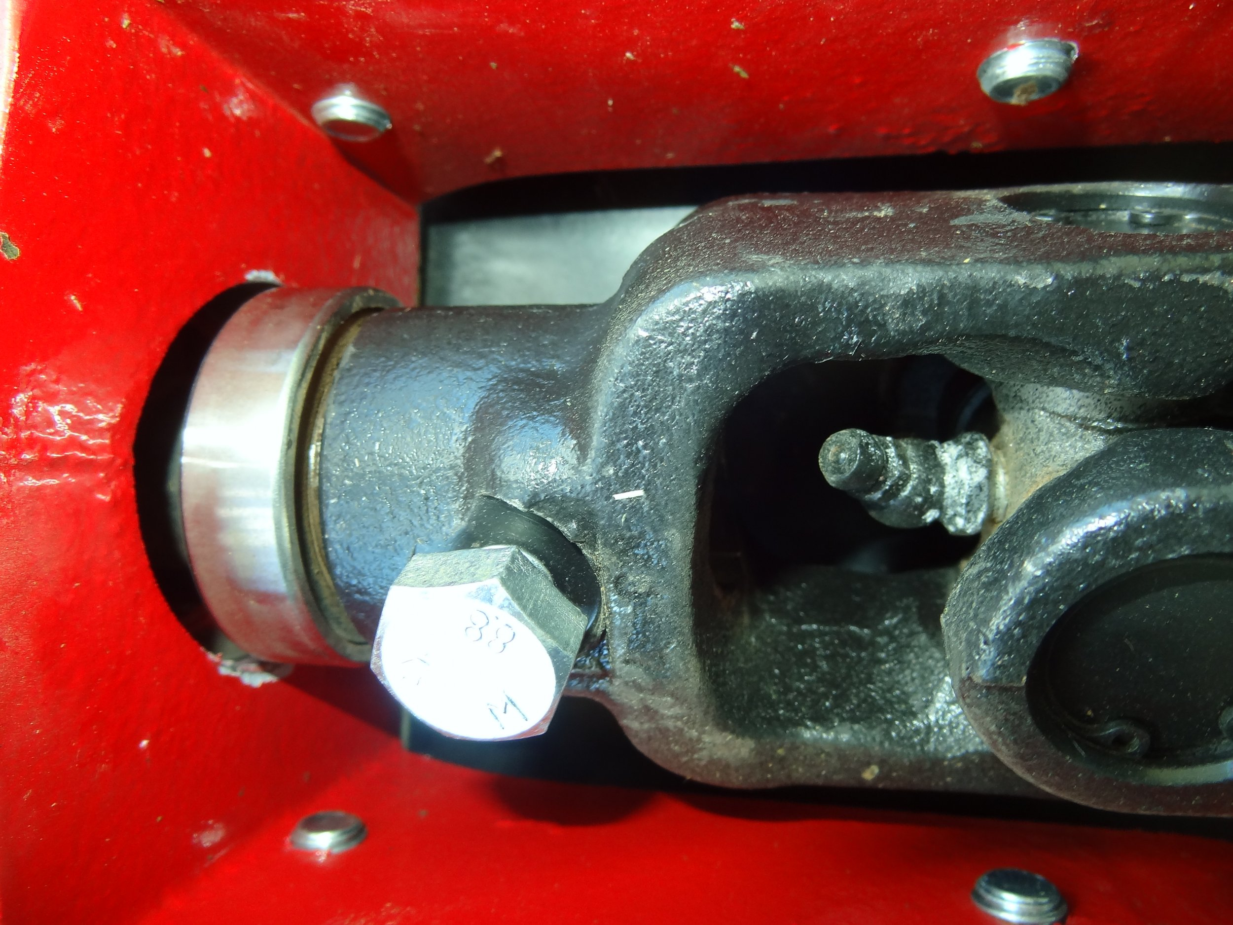

After my second job with my drum mower, I decided to give it a closer look to get familiar with the details. As I have used a Zanon ZCR lawn mower for almost 10 years, I have a pretty good idea of what to expect.
As I wrote in my original post, the drum mower has an oscillating swivel-joint to allow it to better follow ground contours. The PTO-flange can also be adjusted up and down, allowing the mower to run parallel to the ground with different wheel sizes on the tractor. With my 23’’ wheels the PTO-flange is in the center position, so I would imagine that it can be adjusted to fit wheels between 20-26’’ (y)
Zanon has sadly also copied one of the design flaws that I had on my old lawn mower :cry:
In order to allow the movement of the PTO-flange up and down, there is a universal joint in the driveshaft housing, as can be seen on the photo above. Sadly you can also see that the bearing closest to the tractor has walked out of the housing, and simply spins with the axes :cry:
I had the same problem 10 years ago when I got the lawn mower, so I am disappointed that Zanon hasn’t corrected this flaw :mad:

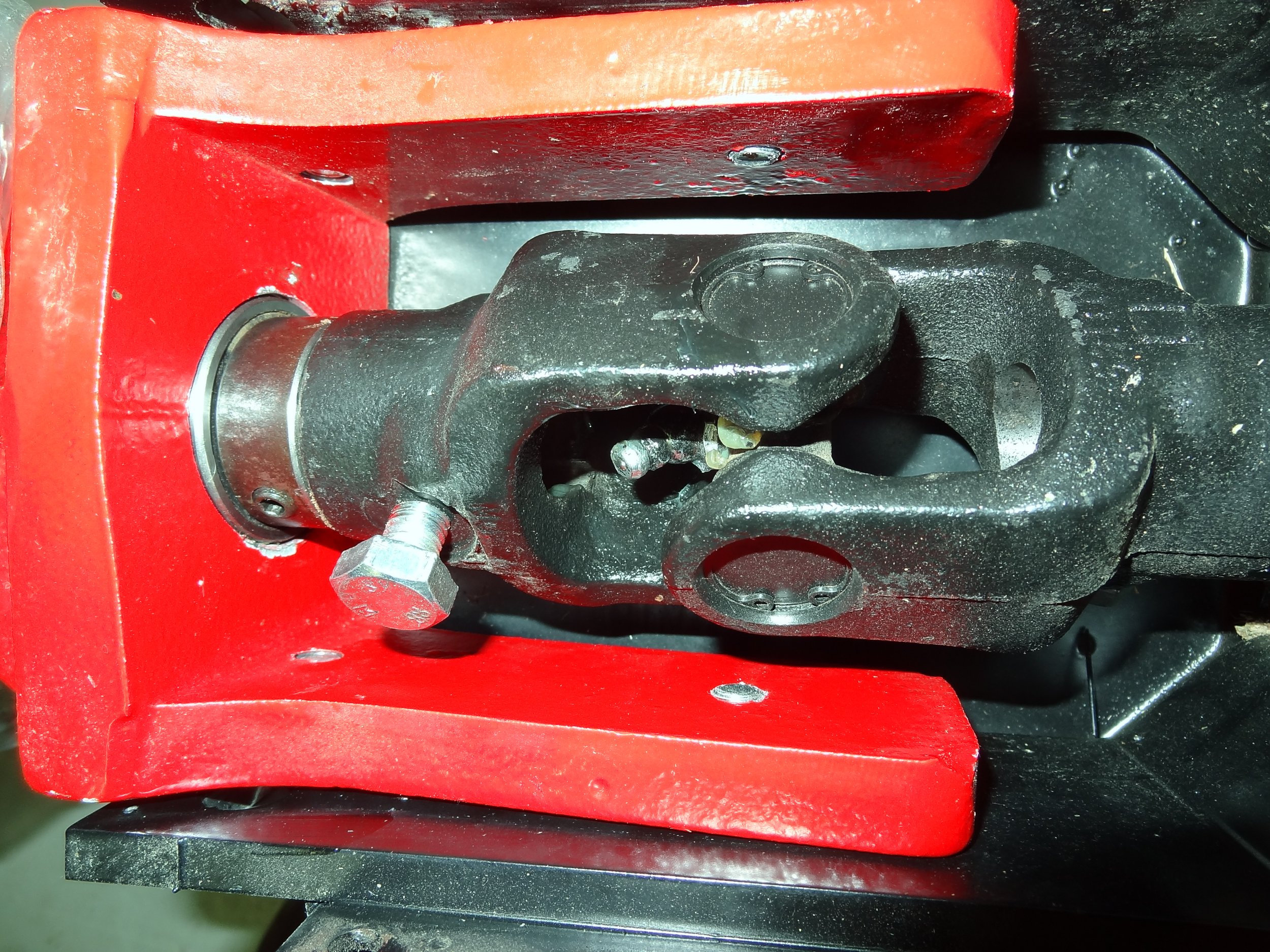

Luckily for me, my neighbor is a skilled mechanic, and he quickly made a fitting shaft collar, as can be seen on the photo below
This way the bearing is kept in place, but why isn’t this so from the factory? :unsure:
The bearing at the other end facing the mower is probably fixed, as can be seen below.
I have 2 Zanon mowers, and both of them had this design flaw, so it would be interesting to hear if other members with Zanon mowers has experienced something similar :unsure:

/ Zanon ZRF 1000 drum mower #10
Yes, my Zanon 33” Heavy Duty Lawn Mower had the same issue, I just pushed the bearing back in the housing and it has stayed there for 3 years so far. I don't use it as much as I use my DelMorino rough cut mower.

Hi joecoin ;)
I’m sorry to see that you have had the same problem too, but glad that you could solve it yourself 💪
I got my Zanon lawn mower back in 2013, and I pushed the bearing back in place again several times in the beginning as well, but it had walked its way out again after each job :cry:
My dealer fixed the problem by placing a shaft collar between the bearing and the universal joint, and I have had no problems with the bearing since (y)
My Zanon lawn mower has served me well for more than 240 hours now, and it will probably keep on longer than I will. I feel confident that the drum mower will outlast me as well, I’m just a bit disappointed that Zanon does not correct this annoying flaw :mad:

/ Zanon ZRF 1000 drum mower #12
Hello,
Could you tell me the size of the shaft collar and where it was obtained for your Zanon 33?

#13
Hi SloopCreekFarms ;)
As I have just returned from my sommer vacation, I apologize for my late reply :cry:
Just to make sure that we are talking about the same thing:
In post #10 from joecoin, he is talking about his Zanon 33” Heavy Duty Lawn Mower, and that he has had the same problem as I had, but that he was able to solve it without a shaft collar.
I have a Zanon ZCR lawn mower and a ZRF 1000 drum mower, both of which had the bearing problem that was solved with a shaft collar.
I just went to my garage with a vernier caliper to take the measurements of the shaft collar for you, and they are as follows:
Inner diameter (equal to shaft diameter): 25 mm
Outer diameter: 40 mm
Width: 15 mm
On both my Zanon mowers the shaft collars have the above size, so perhaps a shaft diameter of 25 mm is common for Zanon mowers. I can’t tell if this is also the proper size for a Zanon 33” Heavy Duty Lawn Mower, which is perhaps the model that you have?
This might be a common Zanon problem, and my dealer had the shaft collar available in his shop. If you can get hold of a shaft collar, it is pretty easy to install it yourself simply by removing the coupling and slide it onto the shaft. The collar is fixed to the shaft by a little set screw.
I hope this information was helpful, and I would love to hear what kind of experience you have had with your Zanon mower.

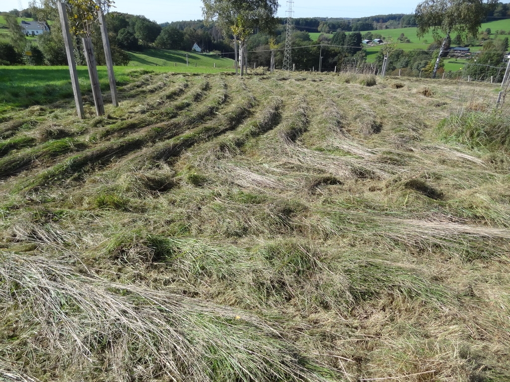

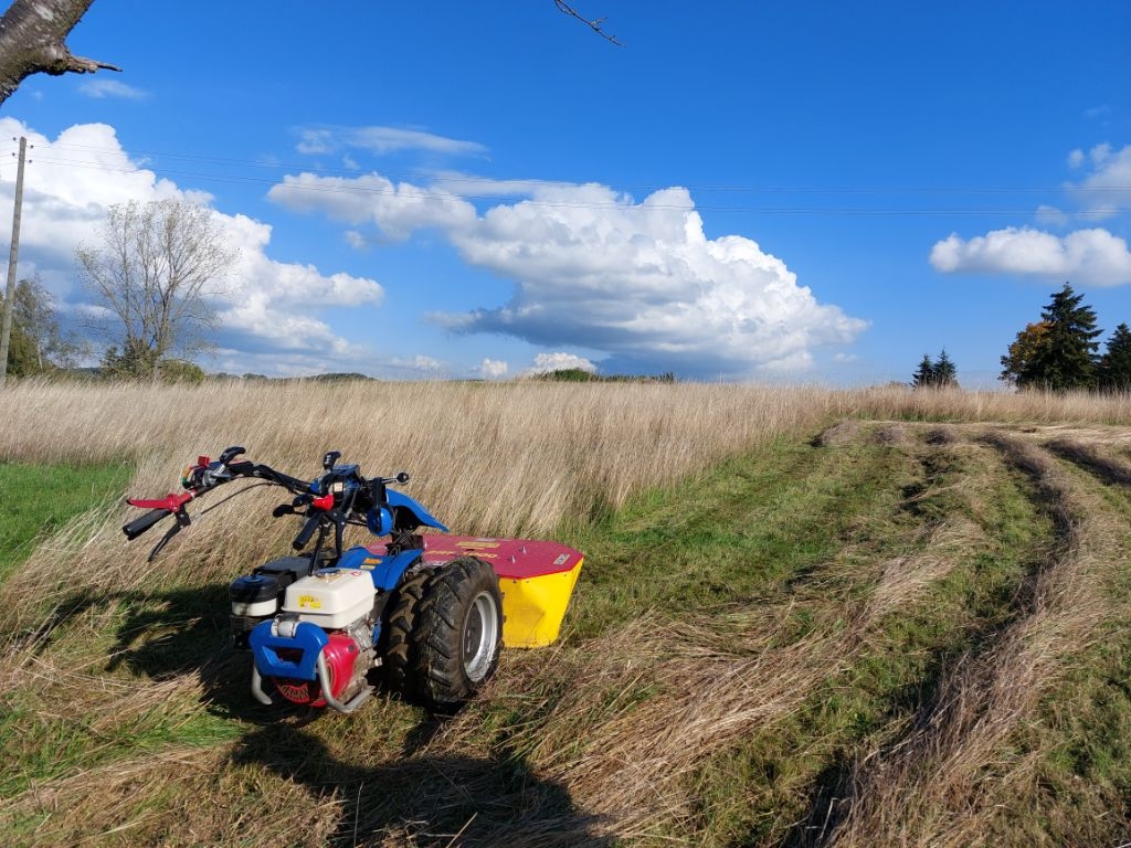

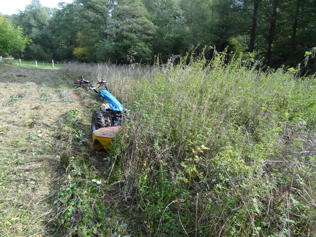

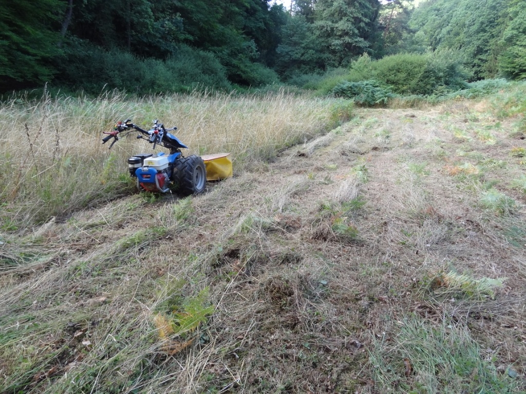

Here is a photo from a job in the autumn of 2022:
The summer of 2022 was very dry in my area, and the grass was therefore so sparse, that I could mow in 2nd gear with only my normal 10 cm (4’’) overlap.
On another job that autumn I was mowing an orchard where the grass was slightly more dense, but with around 20 cm (8’’) overlap, I could still mow in 2nd gear:
A few days later on my own meadow things got tougher, with up to 2 m (6½’) tall material, mainly stinging nettles, thistle and blackberries. Here I had to downshift to 1st gear:
In the summer of 2023 we had a lot of rain, and as I arrived at the above mentioned orchard this time, it was obvious that this was going to be a 1st gear job:
Clearly the windrows are much more dense this time, but with a little extra overlap we made it.
All of the above hopefully shows, that depending on the density of the crop to be mowed, the 100 cm (40’’) drum mower might be the proper size for an almost 12 hp engine. It is important though, that one can mow mostly in 2nd gear in order to get a good performance.

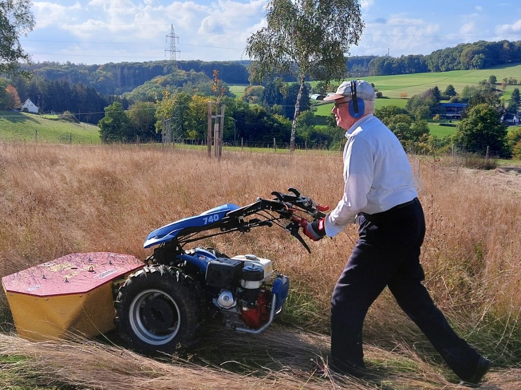

/ Zanon ZRF 1000 drum mower #16
Seems like it would work better if you took the cover off the front of the mower Jens. Looks like it's pushing the grass over. It's simply two small bush hogs. No lift on the blades.
#17
Hi Nibbana ;)
You are probably thinking of the third photo in my last post especially?
The cover is slightly bigger than the „business-end“ of the mower of course, as it supports the yellow tarpaulin hanging from it. The cover only protrudes about 2’’ in front of the tip of the spinning blades, so there is very little „pushing-over“ taking place. A little is also no problem, as it prepares the material for falling over when cut, and probably helps in forming a nice swath with all the cut material falling in the same direction, as seen on my last photo.
When working with the drum mower, I am pleased that I walk at the opposite end of the tractor, as the spinning mower up front is quite a formidable implement. As I wrote in post #7, the tips of the blades are traveling at almost 150 mph when the engine is running at rated speed, so they deserve to be treated with respect. The cover probably can’t prevent accidents from happening, but I still consider it as an important safety device. After a job, the inner side of the tarpaulin is often covered in quite a lot of clippings, and I wouldn’t like to know how much of that would be flying around my head without the cover. Should one hit a small stone with the tip of a blade, I also wouldn’t like to imagine the damage it could do to an eye or a tooth, with a bit of bad luck.
It’s a great and powerful tool, but as most implements we use, it has to be treated with the utmost respect!
The old man mowing at 3.54 km/h (2.20 mph) with the engine running at 3600 rpm, and the tractor in 2nd gear:

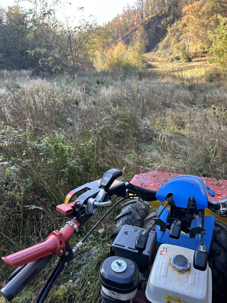

For the 13 years that I have had my BCS 740, I have been fortunate to have had very few breakdowns and no damage done to neither tractor nor its implements, but that all changed some 3 weeks ago :cry:

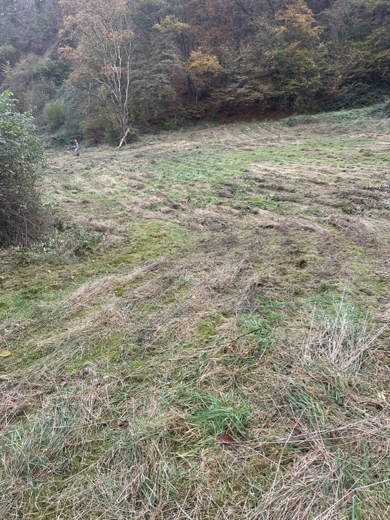

My last mowing job with the drum mower this season, was a large 2-day job in a former quarry, that has been transformed into a nice nature reserve some 30 years ago. As so often before, I was mowing the larger inner parts of the area, and a friend of mine took care of the edge area with a brush cutter. I took this photo of the already mowed area, shortly before bad luck struck:
The photo shows roughly half of the area to be mowed, and for reference one might see my friend in the upper left corner.
The following photo shows a part of the plot that hasn’t been mowed yet:

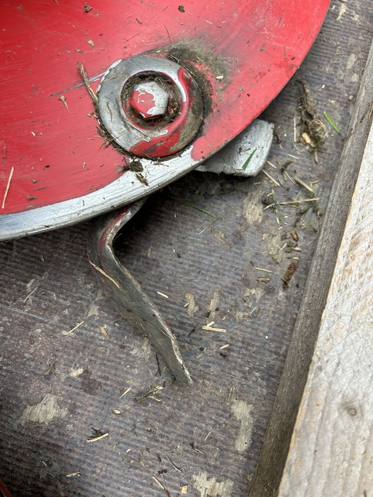

When mowing, there is always the risk of hitting some hidden rocks, tree stumps, fence post, barbed wire or other obstacles, especially when working on an unfamiliar plot. I have found that the drum mower with its hinged knives is less sensitive to such foreign object than a sickle bar mower, but more sensitive than the flail mower. That said, there is of course a limit to what amount of abuse it can take, and as I hit a stone so big, that I later just barely could carry it away myself, the drum mower lost the fight. This was the result:
The hinged knife gave way and survived, but the bracket holding the knife in place, was ripped off and bend :cry:
My neighbor who has worked all his professional life in a machine shop, offered to help, and the next day he straightened the bend bracket and welded it back on, allowing me to finish the job (y)
As we have had a lot of rain this summer, the tractor, the drum mower and I were pushed to our limits, but the costumer was very pleased with the final result (y)
