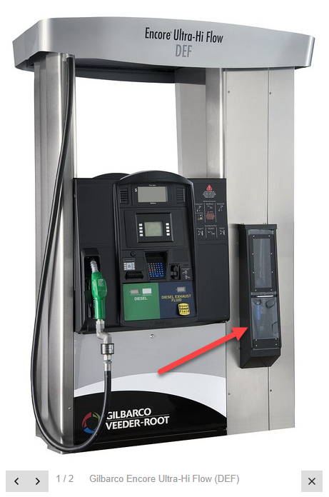

THANK YOU ALL! For saving me from a very expensive mistake. I agree that it is awfully odd to have one hose and a tank that dispenses DEF or regular diesel. I'm going to drive back and take pictures, which I'll post. I'll also talk to the store personnel to see if they can explain it to me. Thank you all again. I will follow up in a day or two.

I revisited the station. The manager was not there and nobody could give me any information. I'm attaching photos and a closeup of the instruction on the pump. There is only one hose, but it looks like the pump offers DEF and diesel. Two prices are on the pump as well. I tried pushing the DEF button and nothing happened, What do you all think?
I think after someone buys DIF there is a Lot of Water in that Hose....if you only filled a 2 Gallon you would be buying a Lot of water. This is Not right and should be Reported.

I filled my cans at a station that apparently pumps regular diesel by default, but if you push the button, it pumps DEF. I was confused by this and put about half a gallon in my 5 gallon can. It's hard to get a clear answer by searching online so I thought I'd ask on here. Do you think it's safe to use this can that is 90$ diesel and 10% DEF on my Kioti CS2510?
If you look at the pump, there is another hose behind the door on the right. That is the DEF hose. If you were buying DEF, you would insert that hose into your DEF tank and then push the DEF button. I would venture to guess that the hose you used the first time was diesel only, as the hose on the left does not access the DEF. Your fuel is ok..

I'm still trying to understand how it's physically possible to get 0.5 gallons of DEF out of a diesel pump.
Either it's all DEF or it's all diesel. Reality dictates that it's all diesel...unless aliens somehow got involved in this normally simple task of filling up a can.

That pump is in the truck island, diesel is for filling off side fuel tank and no nozzle for DEF on that side.
The nozzle for DEF is probably on the other side with the card reader as most DEF tanks are on the driver side of trucks and tractors.
Unless you removed DEF hose and pumped it in, maybe it is all diesel??
If you aren’t sure what is in the can, don’t use for fuel. Fire starter, cleaning parts, wash dirty tractor, etc ……….
