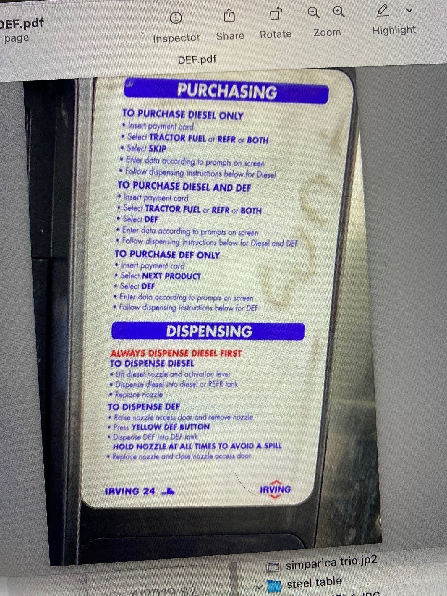

I revisited the station. The manager was not there and nobody could give me any information. I'm attaching photos and a closeup of the instruction on the pump. There is only one hose, but it looks like the pump offers DEF and diesel. Two prices are on the pump as well. I tried pushing the DEF button and nothing happened, What do you all think?

/ Will DEF harm a CUT? #11
Instructions say to open DEF nozzle door then press the yellow DEF button to dispense it.
I thought that was the case as you couldn't possibly have 1 nozzle for both! DEF in diesel is bad! Diesel in DEF is bad!
/ Will DEF harm a CUT? #13
Agree looks like dispenses both but on all the DEF equipment that I have been around the DEF nozzle is smaller in diameter.
If dispenses both through same nozzle I would buy my diesel elsewhere.
#15
You didn't get anything mixed with your diesel that you dispensed.
I see what you're saying. I misinterpreted the instructions and thought that just pressing the yellow button resulted in DEF being dispensed. Now that I know what DEF is, it makes sense that there is another nozzle, although I don't see where the "nozzle access door is". But it must be there somewhere with a separate hose that dispenses DEF, and you are correct that I did not get any of it.
Thank you very much for your explanation. I feel much better about this.

Gotta admit, just seeing the pics as presented, those are a little confusing.
