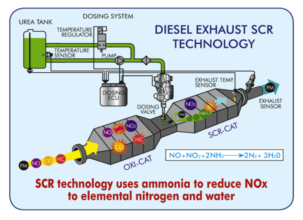

/ Will DEF harm a CUT? #58
Here is how DEF is used:
When diesel engines burn fuel they do it in an oxygen rich/fuel lean environment. When any fuel burns in an oxygen rich environment Nitrogen Oxides are created. These gases are the primary source of smog. It also is not a great substance for human lungs and in high enough concentrations can induce asthma and other issues.
Modern diesel engines have a system to reduce the amount of NOx that comes out the tailpipe as well as reducing the amount of particulate matter/soot, and reducing unburnt hydrocarbons (unused fuel).
The NOx system is composed of:
- Tank to hold the DEF fluid
- Heaters in the tank and lines to keep it from freezing
- Injector(s) to dispense it
- Diesel Oxidation Catalyst
- Selective Catalytic Reduction
- Exhaust Gas Recirculation Valve (EGR)
NOx is a gas. It must be reacted with another gas to convert the NOx into harmless CO2, Water and Nitrogen gas.
The SCR/DOC is a piece of equipment in the exhaust system. It is coated with platinum group precious metals. These are what allow the chemical reaction that converts the NOx into the harmless gases.
Anywho, the DEF is injected into the SCR/DOC when it is up to temp. The Urea in the DEF will decompose to Ammonia gas. The Ammonia will react with the NOx in the presence of the precious metals and a chemical reaction will occur which causes the conversion of the NOx into the harmless gases.
There are NOx “sensors”, glorified oxygen sensors, that measure the amount of NOx before the SCR system and after the SCR system. These readings, along with other engine performance calculations, determine how much DEF is injected. Driving style and vehicle use will greatly influence the amount of NOx created. Mashing the go pedal to the floor or heavy towing will both greatly increase NOx.
The DOC/SCR system comes AFTER the diesel particulate filter (DPF). The DPF is a cylinder like container that is filled with a honeycomb like structure with small holes. It is connected directly to the exhaust system.
As soot is created, it gets trapped in the DPF. There are differential pressure sensors that measure the drop in airflow across the DPF as soot builds up. Once the pressure drop is high enough a “regeneration” is initiated. This is where a small amount of raw fuel is allowed into the DPF where it burns at a hot temp. This occurs either through engine exhaust valve timing adjustment/fuel injection increase OR a dedicated injector (most recent diesel vehicles).
The raw fuel heats the DPF hot enough to burn the soot into ash. The ash falls to the bottom of the DPF and collects. Driving style and vehicle use will determine how quickly the ash fills the bottom of the DPF. Eventually it will need to either be emptied/cleaned or replaced.
If too many short trips are driven then the soot never gets a chance to be burned into ash. Too much built up soot can cause exhaust gasses to build to a higher pressure and cause engine malfunctions. This is why modern diesel trucks are not a good choice for people who drive a lot of short trips.
