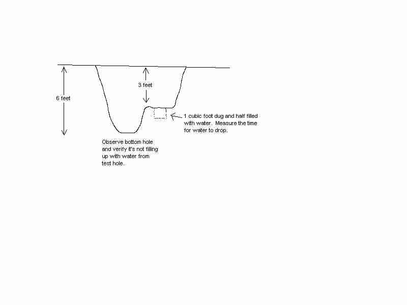

When we had our system put in, (perc tests) the inspector said slow is not good, but too fast is even worse. There was a minimum and maximum drain time for the test hole (1 foot cube, filled with six inches of water) and there were two holes dug. Each hole was 6 feet deep, with a three foot step where the 1 foot cube was dug. (see CRUDE drawing) The idea was the water should leach into the soil without puddling in the bottom of the 6 foot hole.
As far as pump-outs we were told to have it done the first time in three years (1500 gallon with six people) and get an idea of the solids that were in the tank at that time. We could then adjust the schedule as needed. The idea is to catch the solids and oils in the tank. At three years we were told at our current uses (?) we could go 4 or 5 years between pumpouts. We have been sticking to three years.

Additionally, in our area the price for a pumpout is in the range of $200. If the tank is hard to get to (alot of hoses) or any digging has to be done, it costs more.

Steve,
What is the distance the "1 cu.ft. test hole" is from the edge? {so the water wouldn't naturally flow out the 'thin' side}

It's been seven years or so but as I remember it was two or three feet from the side of the test hole to the drop off of the 6 foot hole.
Steve
