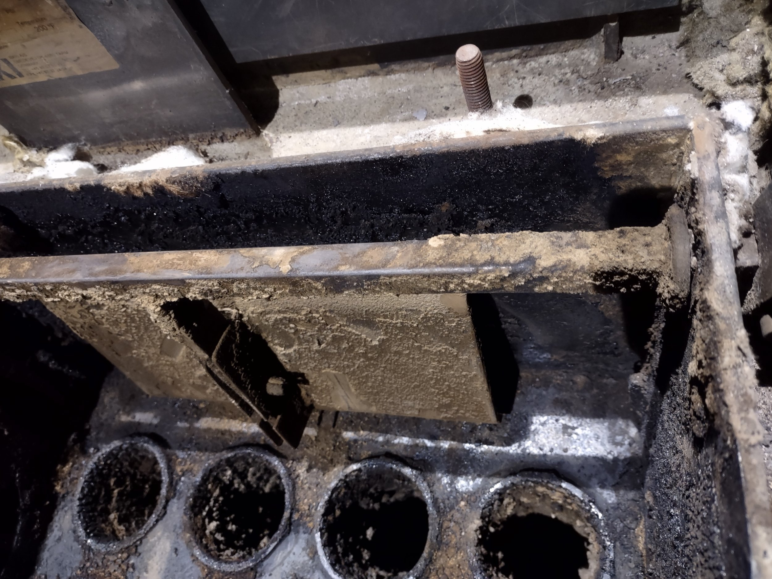

Pulled out the DHW (Domestic Hot Water) coil to look at the inside of the vessel last night, this is looking across above the top of the firebox, the two cylinders on the far side are thermowells:
Looking down the sidewall of the firebox from the DHW opening:
Looking over and toward the back/chimney from the DHW opening
The DHW coil
All in all, it looks pretty clean inside, I think the leaks are just from the welds cracking.

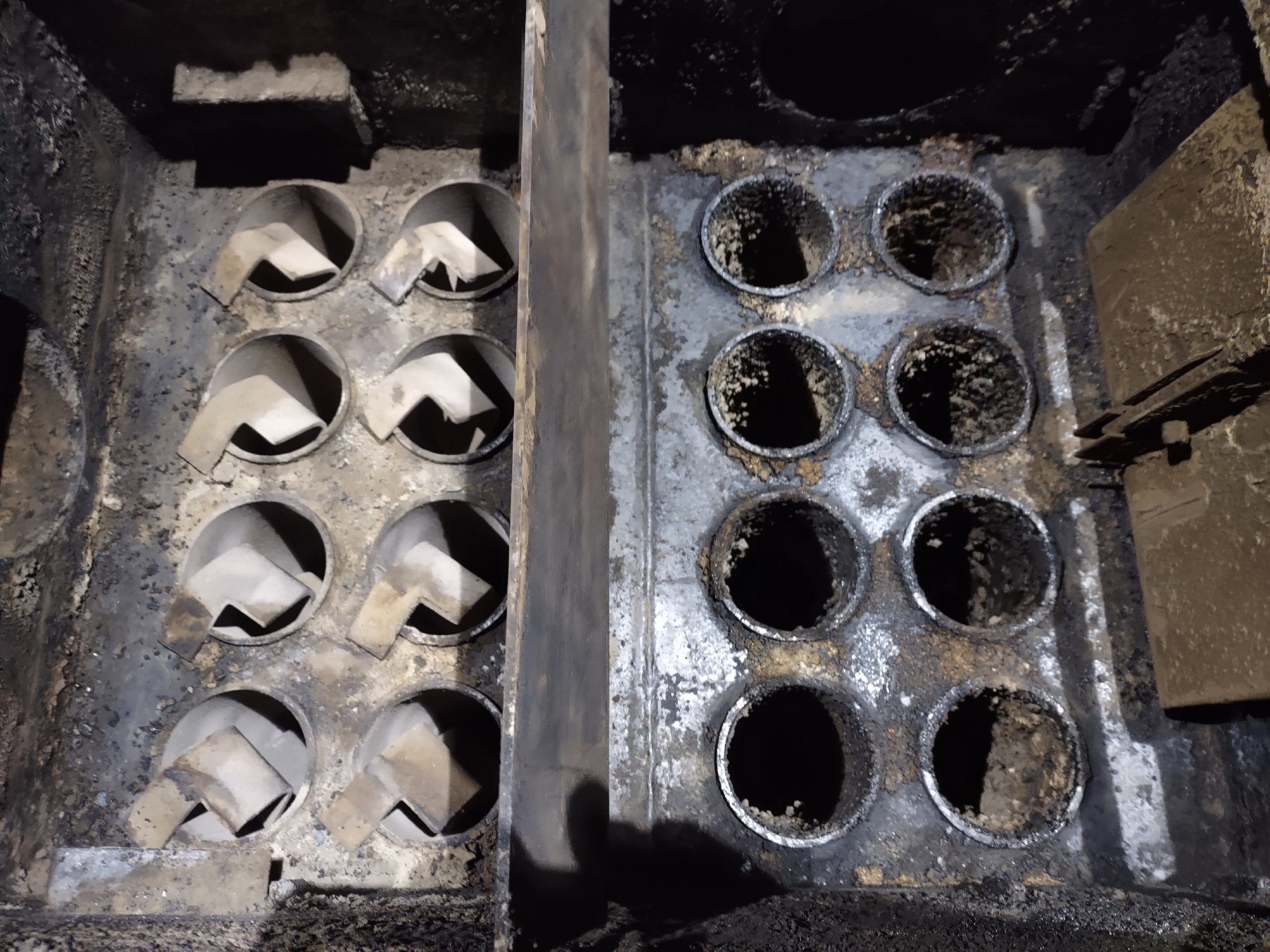

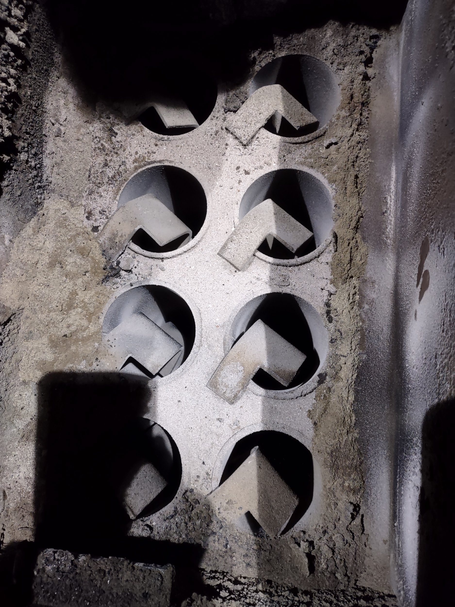

It also had the air passages in the nozzle bricks blocked off due to them being installed backwards and it appears that it rarely had the ashes cleaned out.
