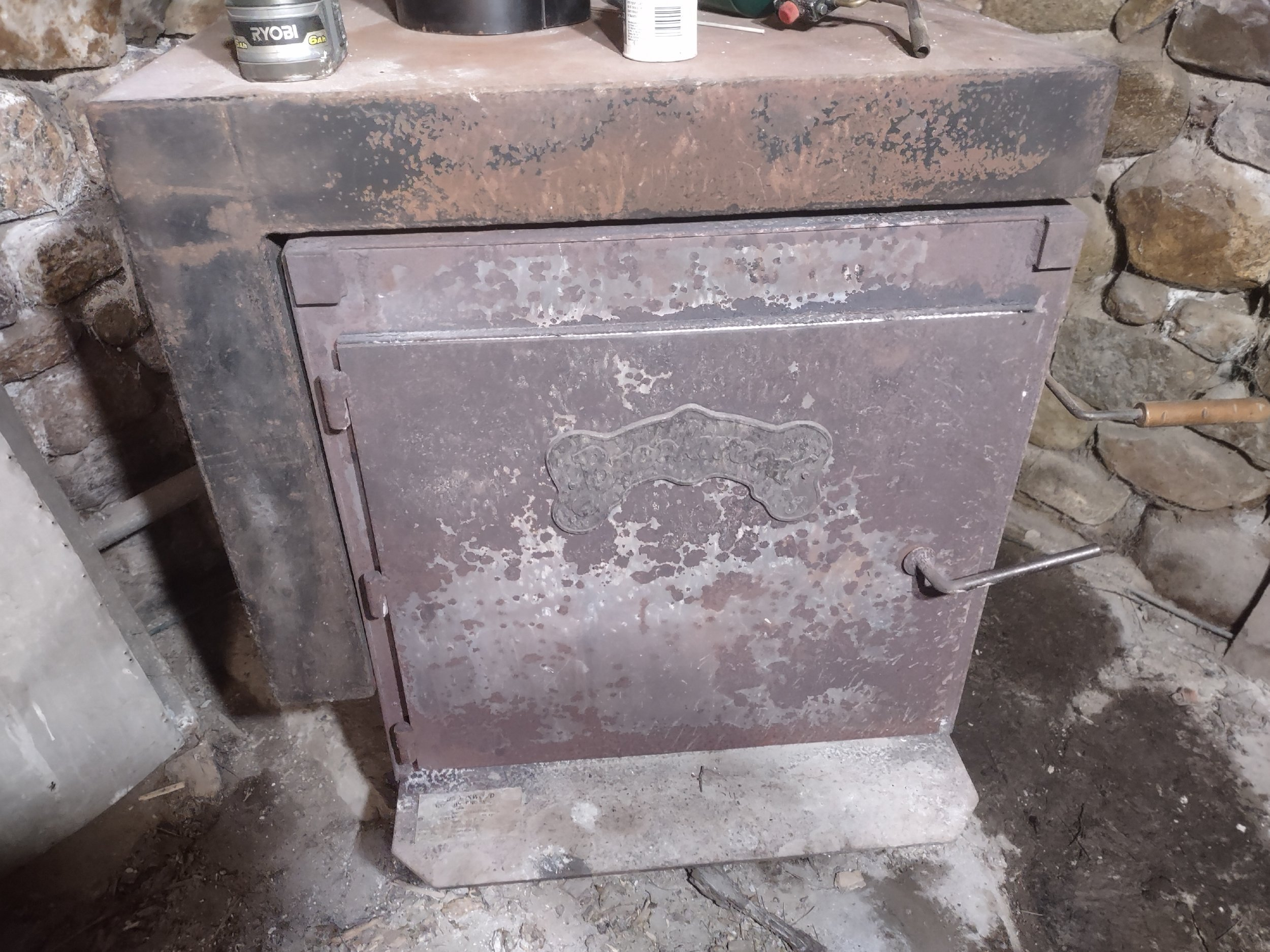

Good idea but I'd use a pressure washer with a narrow tip and do it when it's warm outside so it dries out quickly.
Good idea, but I think I will start with a wide "fan" tip so as to not erode the firebrick.
I have a bunch of extensions for my pressure washer wand so I should be able to get all the way back there.
On drying it out, I have been running a 200w heater in the firebox, once I finish washing out the lower portion I will move it down there.

Add fire-brick liner ?
Where?
The "floor" of the firebox needs some replacement parts (the two big "nozzle" bricks in the "center" are eroded and need to be replaced or have a stainless center section replacement made up).
The rest looks is ok, might need to replace a piece or two, but nothing urgent.
Aaron Z
