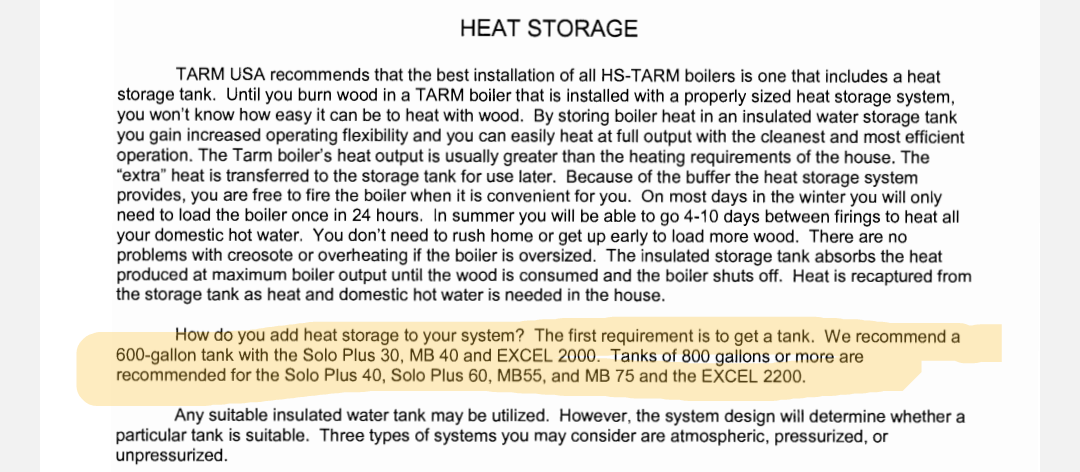

800 gallons of storage sounds a bit excessive for domestic hot water. 800 gallons for hydronic heating don't. We have forced air on the main furnace and utilize biomass with the forced air (Plus 95 Bryant) as the backup.
That's for hydronic heating.
Supposedly the DHW coil is plugged, it's on my list to check after I get the leak in the firebox fixed.
