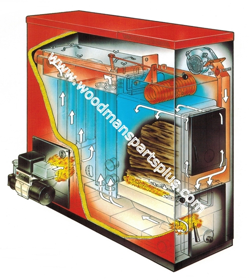

I picked up a Tarm Excel 2200 Gasification Wood Boiler this week, from the tag it appears to have been made in 2001:
It is a Wood/Oil (or Wood Propane) boiler, on the wood side it heats the wood till it smoulders, then burns the gas/smoke at around 2000F below the firebox:
Picture from: Tarm Furnace | Excel 2000/2200 | Wood and Coal Furnace Parts
