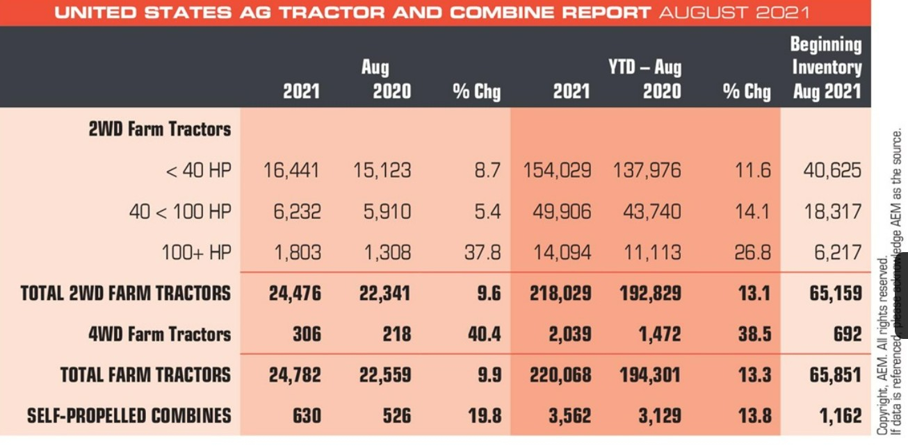

Here is an indication of how much buyers hate Pre Tier 4 emissions. Wait, it shows everything is up. I'll be darned.
In general, Tier 4 engines, if computerized with common rail injection, DOC, DEF and DPF, can get a lot more power per unit displacement because they can clean up the exhaust with their aftertreatment. In addition, the high pressure common rail systems break the diesel into much finer droplets so more of the fuel injected gets burned instead of being used to create a cloud of soot.
I think you are reading way too much into that graph, Harry. Sales are up because more people need tractors, not because they like tier 4. In fact most tractor buyers don't even know what tier 4 is all about.
