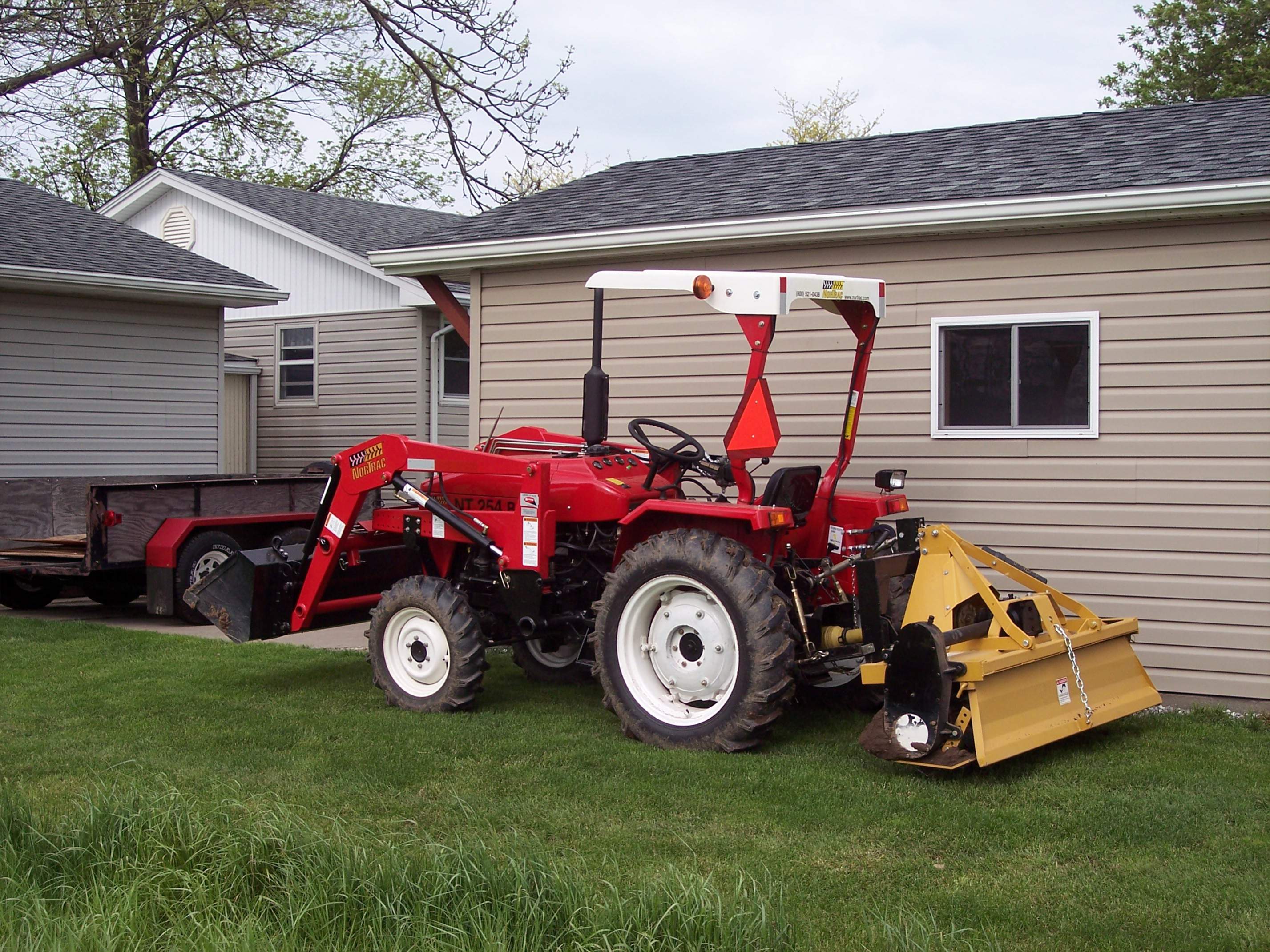

I have the harbor freight one, it works well for me. I currently have 3 implements, my 5 ` rototiller, subsoiler and a heavy hitch. the rototiller and subsoiler fit perfectly , however I did have to grind some off the top mount of the heavy hitch. I find it works rather well. 006.jpg

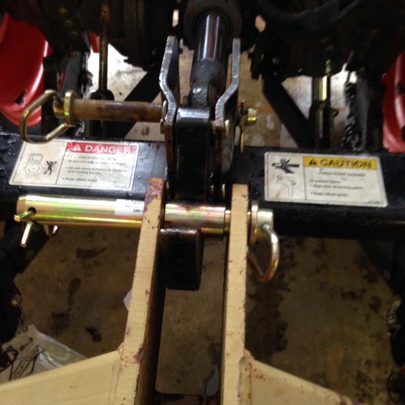

I have the Landpride QH15 for cat 1. Some of my implements are cat 2 as well and there are no issues after getting it set up.
The problem for me is my box blade isn't quick hitch compatible, and I do plan on modifying it at some point, but the reason I like the QH15 so much is because the top hook on it is adjustable up/down. So, although I sometimes need to get off the tractor and mess with the hook, it is still WAY faster and less aggravating than not having it.
Also, do yourself a favor and buy a bunch of bushings to bring your lower link pins (on the implements) up to cat 3 sizing. It fits nice and snug in the quick hitch hooks.

:thumbsup: I have the same set-up and I love it..

+1 to this. Without the extra bushings, my landscape rake and box blade have way to much play in the lower connectors. No need to buy the $35 "quick hitch adapters" at Tractor Supply -- just make your own using their $4 bushings (one inside the other.) With the bushings, the fit is perfect and there is no play.

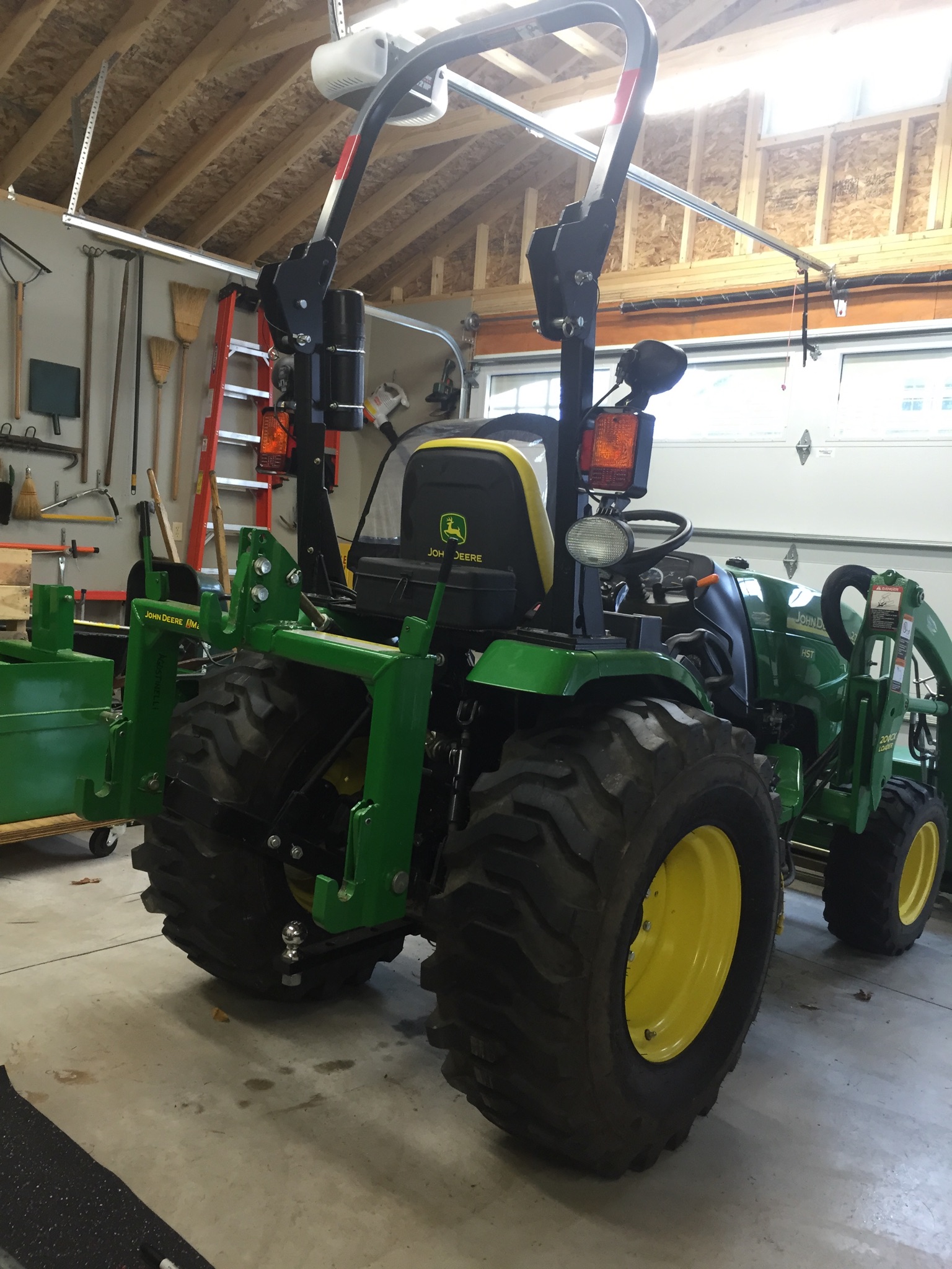

I bought one with the tractor. It makes things much easier on the back, knuckles, etc. I had to add bushings to the chipper and the dealer put them on the ballast box. I grew up wrestling 3PH arms on and off various implements behind my father's old Ford 9N so I know what it's like without it. I'd say get one if you can swing it.
