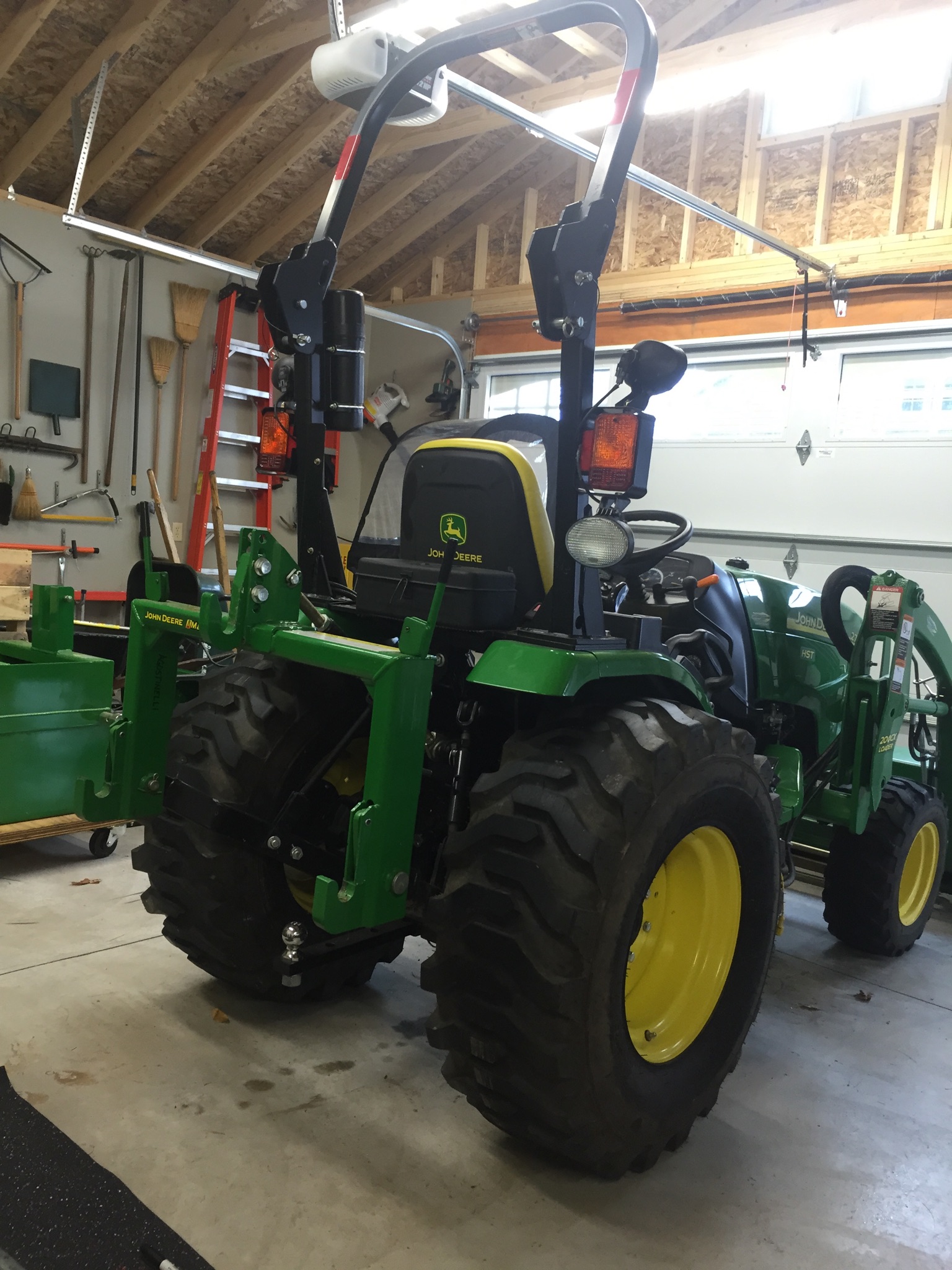

I bought one with the tractor. It makes things much easier on the back, knuckles, etc. I had to add bushings to the chipper and the dealer put them on the ballast box. I grew up wrestling 3PH arms on and off various implements behind my father's old Ford 9N so I know what it's like without it. I'd say get one if you can swing it.

thanks for the help.. BTW: good looking machine in your shop..
