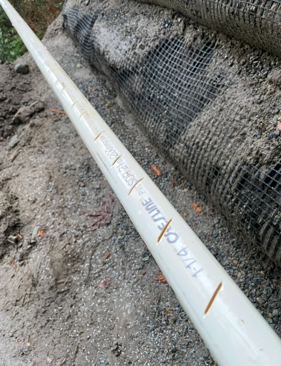

Here's what my guy said.
On your hillside it's not going to be flooded behind the wall.
You will have water coming down from above at one or two places.
If you put holes down it will distribute water over the whole base.
If you put holes up it will carry that water out.
your going to have an extra 1 1/4 of water before your drain pipe starts evacuating.
If the holes are on top, the water level has to be at the top of the pipe to drain. I've always used drain pipe with holes all around.
Putting the holes at the top creates a pond at the bottom of your wall. Basically, you have created a dam that will allow the water to remain there and soak into the base of the retaining wall.
I set it holes-down and he turned it holes up.
I was tempted to tell him what I had read "on the internet....." but decided not to because thats all I had.
I've found fantastic info on the internet opposing what the experienced practitioner does,
.....and I bet we all have.
I understand the that the internet is wrong often.
Anyway I'm curious what you guys think of his POV.
He said the water is all coming from above the holes,
in the areas where it's coming to the pipe.
Well anyway the pipe daylights.
If water is above the slots anywhere along the pipe, its a closed-bottom trough that will run any water out the visible end.
I suspect the gravel bed will be "open" for many years and by the time even one drip runs out of the pipe.... I will have long forgotten all about it.

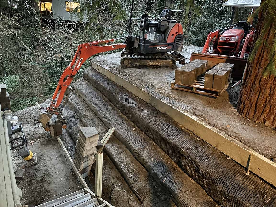

Upper wall is done, ready to remove that last form-board and add the topsoil embankment.
That form board is 4 x 12 x 22 ft long.
Note the gravel waterfall, you can see it in the next pic.
In the coming weeks I'll cover that slope with dark topsoil which will grow stuff fast.
Lower wall is started.
They poured a concrete footing about 18" deep to support the left end.
This wall will be 11 blocks high, coming up to the level of the deck
at the bottom of the stairs.
They said it should probably have 3 drainpipes and should have tiebacks but didn't have any ideas.
that black pipe is temporarily accepting the driveway and downspout water outlet.
A tight PVC pipe will be attached there.
Its up to me to figure out a way to anchor tiebacks into the geotex lifts....
I have several days before the wall builders return.

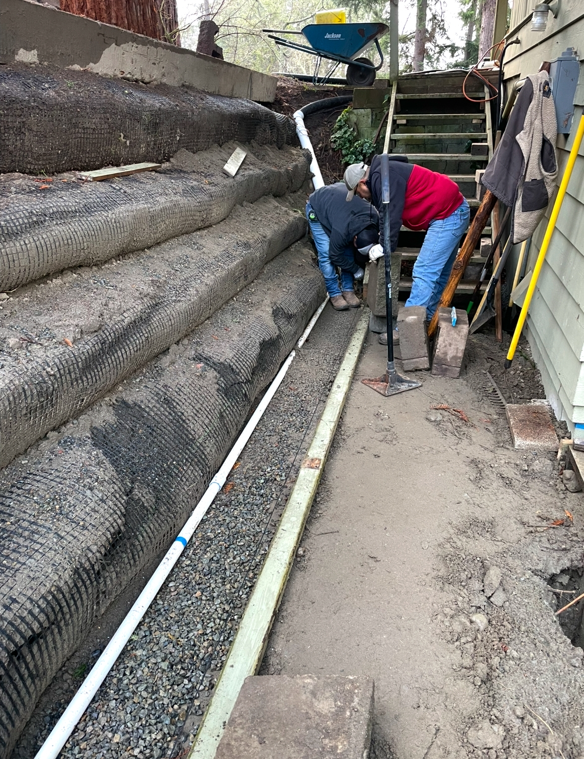

Perforated a 1 1/4 for the bottom course.
Ok it’s started.
My guy said he needs to work with his experienced partner. He said there’s too much to learn and much too slow if I was his helper. So it’s gonna cost more per day but I’m sure, less overall.
Watching them set the first course I can see it would have been a crappy wall if I was doing it. Lots of setting, tamping, resetting the first course. Each block gets moves several times. Re-packed, re-set, re-leveled. Looks strenuous.
Best money I have ever spent paying someone to build my ~100 feet of walls, like you said, starter course has to be dead nuts on, or you will have a f’ed up wall in no time.
You may have saved yourself with that 1 1/4 drainage as long as it doesn’t plug up

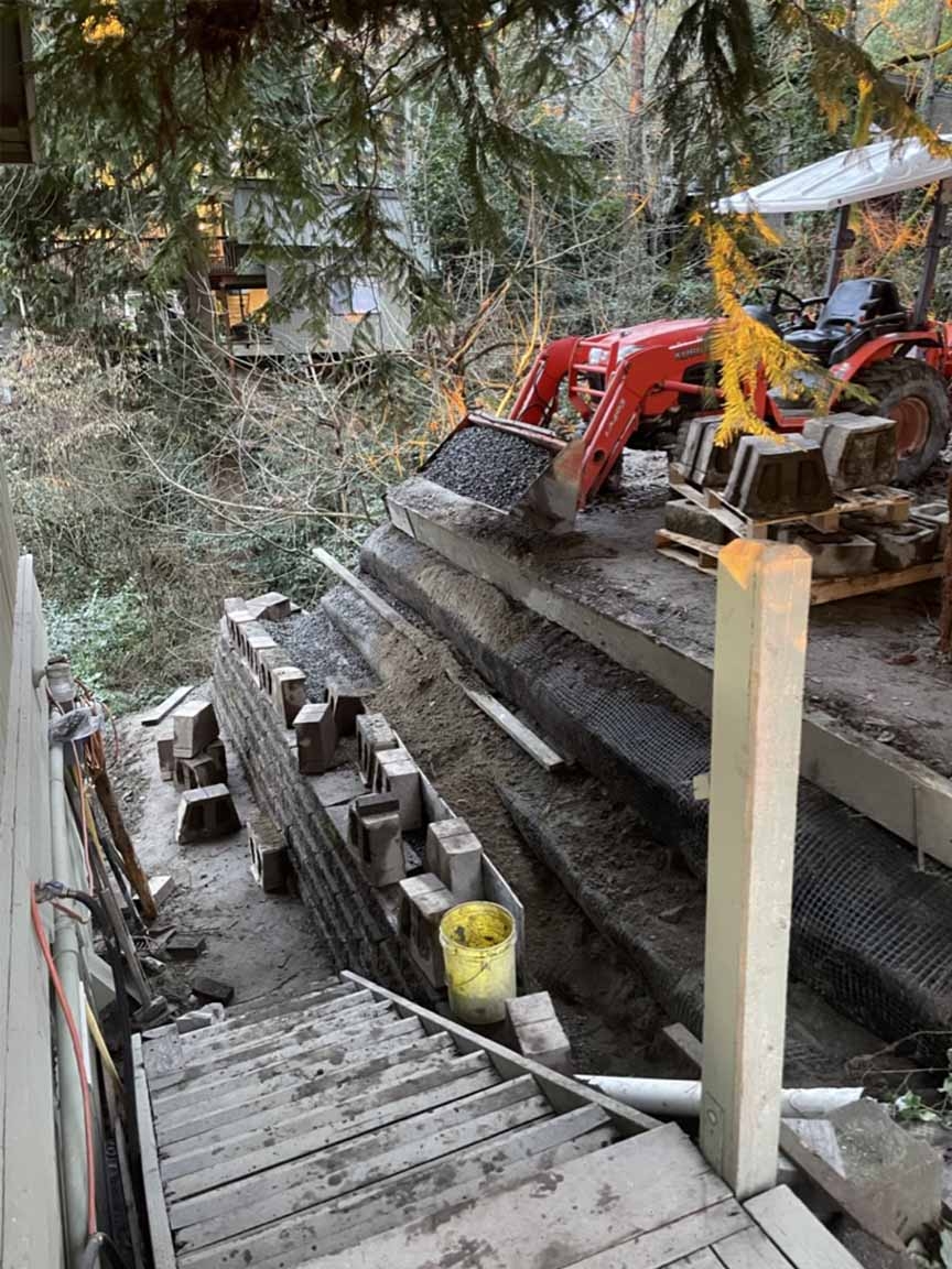

I made this image with photoshop from an install doc posted by airbiscuit.
I was real happy aircommuter asked for it - because then I had a diagram for the wall builders.
I was ready to do it all by armwaving.
A drawing is much better.
The height of the standing blocks is the final 42".
I have not purchased any top-caps.
I decided to "conserve gravel" a bit because I have a sand mine "on-site"😉.
Here it is at the end of the 1st day.
5 blocks up.
You can see the plywood separator between the gravel and the (packed) sand.
No fabric between the gravel and sand.
I'll put a level fabric sheet ontop below the topsoil.

I have free-draining gravel behind the wall, from bottom to the top row.
My wall-builders said it was required too.
I put a 1.25 pipe in clean gravel at the bottom, with its slots on the bottom.
Wall builders rotated it to slots on top. It's buried now.
The water has to be one inch deep to get into the pipe, but water that gets in..... drains all the way to the outlet,
Rather than charging up the ground a foot downstream of its entry point.
There are pluses/minuses to each configuration.
I don't see one inch as a wall-killer.
12 inches up (per the diagram) there is a 3" corrugated pipe (in clean gravel) that's perforated on the bottom (and all around).
It would have been nice to put geotextile tails coming out from between my lifts,
to clamp between the block rows as tiebacks
But that's 20/20 hindsight, not possible to re-do.
And unnecessary per block mfr recommendations, 7 rows, 42" high can be free-stack.
I'm real happy with the upper wall.
I'm "hopeful" that the geotextile layup is self-compacted enough, because it's "sand".
It's creating "level land" where it was un-usable slope.
This is just for parking a car and a little yard, it's not a building site.
The lower wall is only 8 feet long but it's 4 rows higher than mfr recommendations for free-standing (11 rows, 66 inches).
Here, some geo-textile tails would've been useful.
A lot of my land has been been leveled over the years. It's steep.
In one area that I was digging in some fill I found lots of rebar, concrete rubble in the fill-dirt. The garage was built in 1978 (47 years), which suggests the fill was done around then. The buried rebar (in fill-dirt) was rusty, but #5 was still solid. #3s were getting down to about #2 ;-) .
Other areas, I dig into the original sand (on the steep slope) and just a foot down or so, the sand is dry even in the winter.
Anyway I have some examples of underground steel onsite, that I think are usable to assume underground lifetime.
I bet they last almost forever in sand - if the sand drains.
I'm hoping to lock tiebacks into sand though.
Steel doesn't lock into sand like it does in soil.
Plusses/minuses....sand requires a deadman...but sand doesn't rust the steel so bad.
I see some challenges that would be nice to discuss with others who have seen similar.
I do appreciate the critical thought, it keeps me on my toes.
Some things could be better but I don't see imminent failure.
I currently need ideas for tieback methods - that can be done before wed Feb12.
