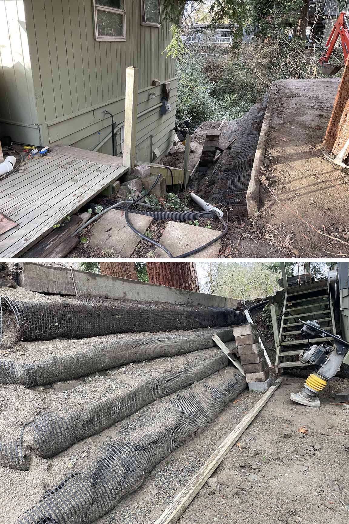

I'm putting up a stacked block retaining wall (6x17x12") blocks.
25 ft long, 7 courses, 42" high.
It's going up against an embankment of geotextile layers.
The lower 3 geotextile lifts are (very) sandy soil.
The dark layer is sandy topsoil.
Inn the end I'll just slope soil down to the 42" top of the wall.
Do I need tiebacks to the wall blocks?
Can I backfill it with sand?
You can see a test-stack of 7 blocks.
I have built many bulkhead. I don't think this will hold the way you are doing it. The best way is to either use plastic sheet piling or do concrete telephone poles stepped back as you go up pinned with 3/4" rebar every 30".
Plastic sheets will require a tieback system 25' from the wall. You will also need to put filter cloth behind the bulkhead.

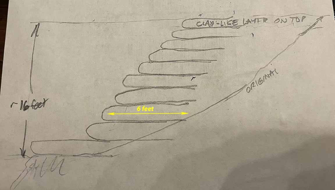

Do you have a cross section drawing of the existing geotex you can post? Were the layers of compacted material tested? Sand isn’t a good fill for that purpose. Sand fill works best in a trench where it’s trapped and can be compacted and it stays in place. What will the slope be above the proposed wall?

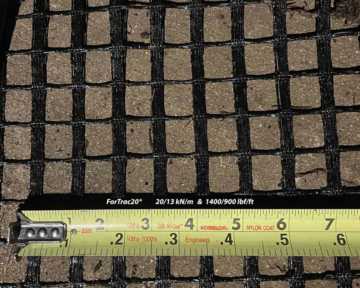

Before you start using the fabric you need to study the different types and use the appropriate type in the location/s as needed. Every type has a purpose.
I chose the fabric based on availability and price.
I had to pay $400 for a 600 ft roll. Which I thought was cheap.
I got it from a guy who bought it as surplus (for a song).
It has no current pedigree (purchase invoice etc).
It's "Huesker Fortrac20".

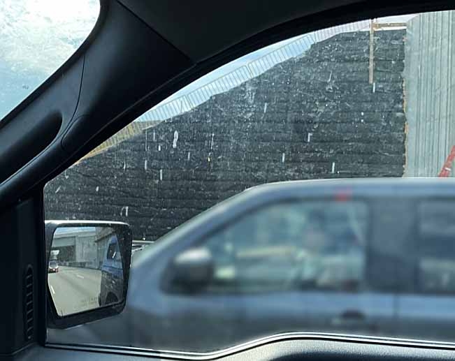

Here's a pic I took of a freeway overpass construction that I took while driving by.
Absolutely _Vertical_ layup of geogrid. Appx 22 lifts, maybe 18-24" each.
I'm guessing they will assemble a veneer of concrete panels over it.

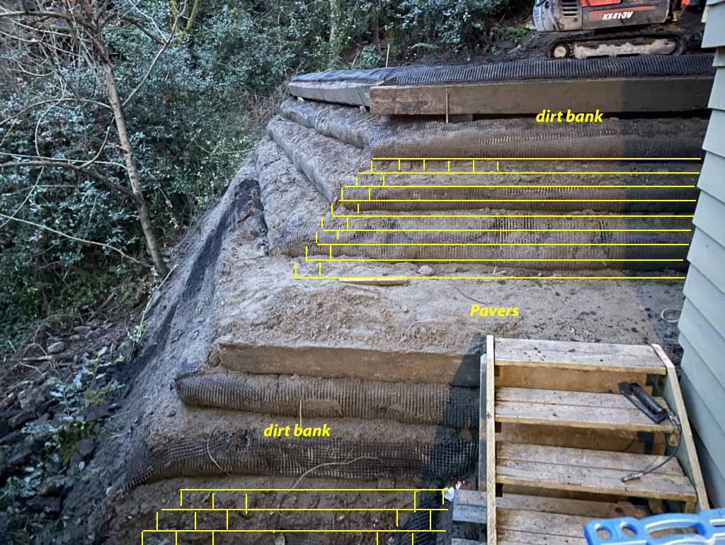

Here's the first 8 lifts.
No fill dirt dumped over the fabric (yet) in this pic.
There's a lower level 8 foot long retaining wall (48" high) too.
The 9th lift is the "claylike layer" ontop.
The noses of the geotex fabric is covered by fill-dirt dumped over the side.
It has to have dirt covering it - because any water running over it will scour the sand out of the geo-tex layers quickly.
The final dirt layer will be dark topsoil so vegetation will grow on it.
This final slope of the 'dirt bank' will be topsoil.
I suppose it will be a little shallower than 1:1.
Hope this answers some of your GREAT questions!
