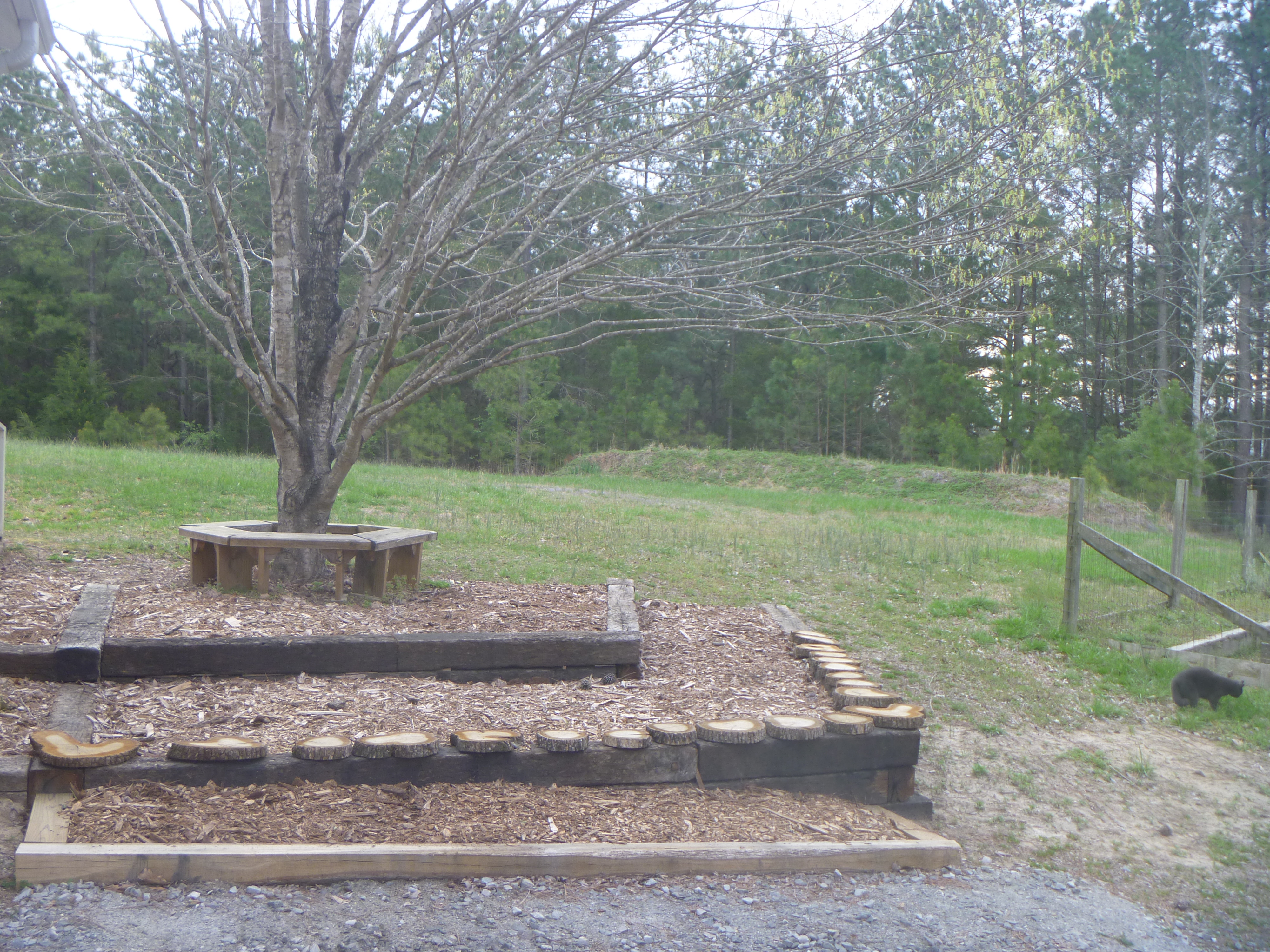

Although not as high as yours (3 courses of ties max), I had success with mine. I needed to prevent erosion under the maple w/o upsetting oxygen to the roots so I backfilled with coarse bark and topped off with chips. After a year the maple is fine. My ties were crappy - I had to insert bolts thru them to hold them together, so as said before get good ones.
