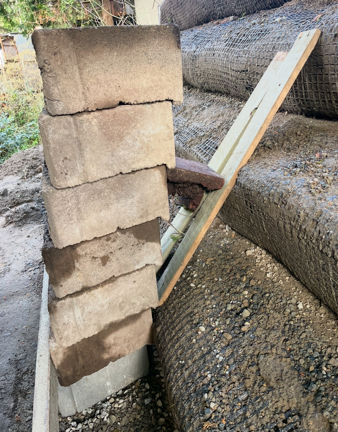

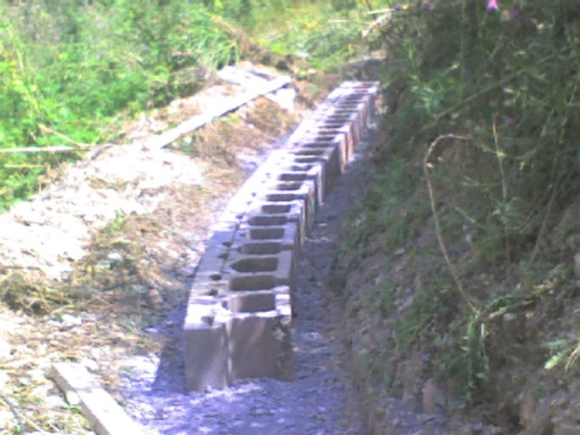

Airbiscuit showed the proper use of geotextile fabric, between the blocks, level into the fill area, to hold the wall back (useless if not attached). Not clear what your fabric would actually accomplish. My 1600 blocks are 90+ pounds each, filled in and behind with 57 stone gravel, with fiberglass pins securing the blocks together (yours have a lip on the back). Blocks with the rear lip aren't designed for high walls (some say two feet max), and I'm curious if placing geotextile fabric under the lip defeats its purpose. As LD1 stated, 57 stone is used in and behind those blocks, and you need a drainpipe at the bottom. However, my instructions stated compacted 21A stone footer 12" below the wall, which keeps the footer from retaining moisture. My four-foot and above walls required 12" below grade.
