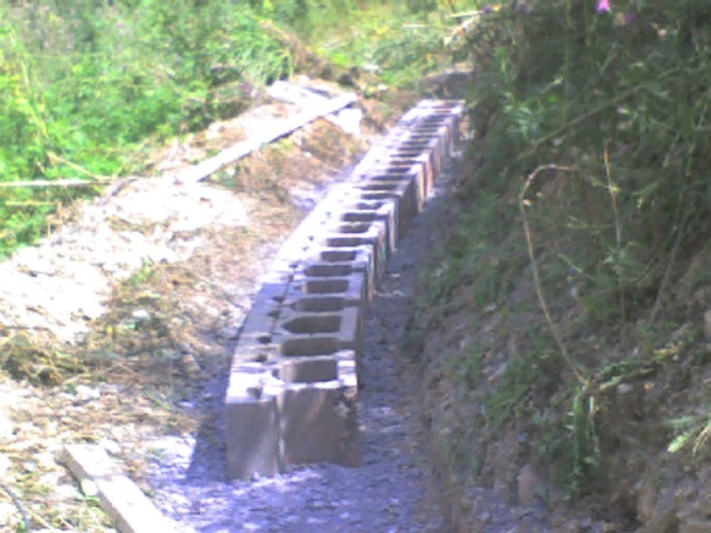

I've had good luck with those blocks and no tie backs. I put a drain tile below them and backfilled rock behind them. It's important to get the base layer really level, so they don't end up tilted out.

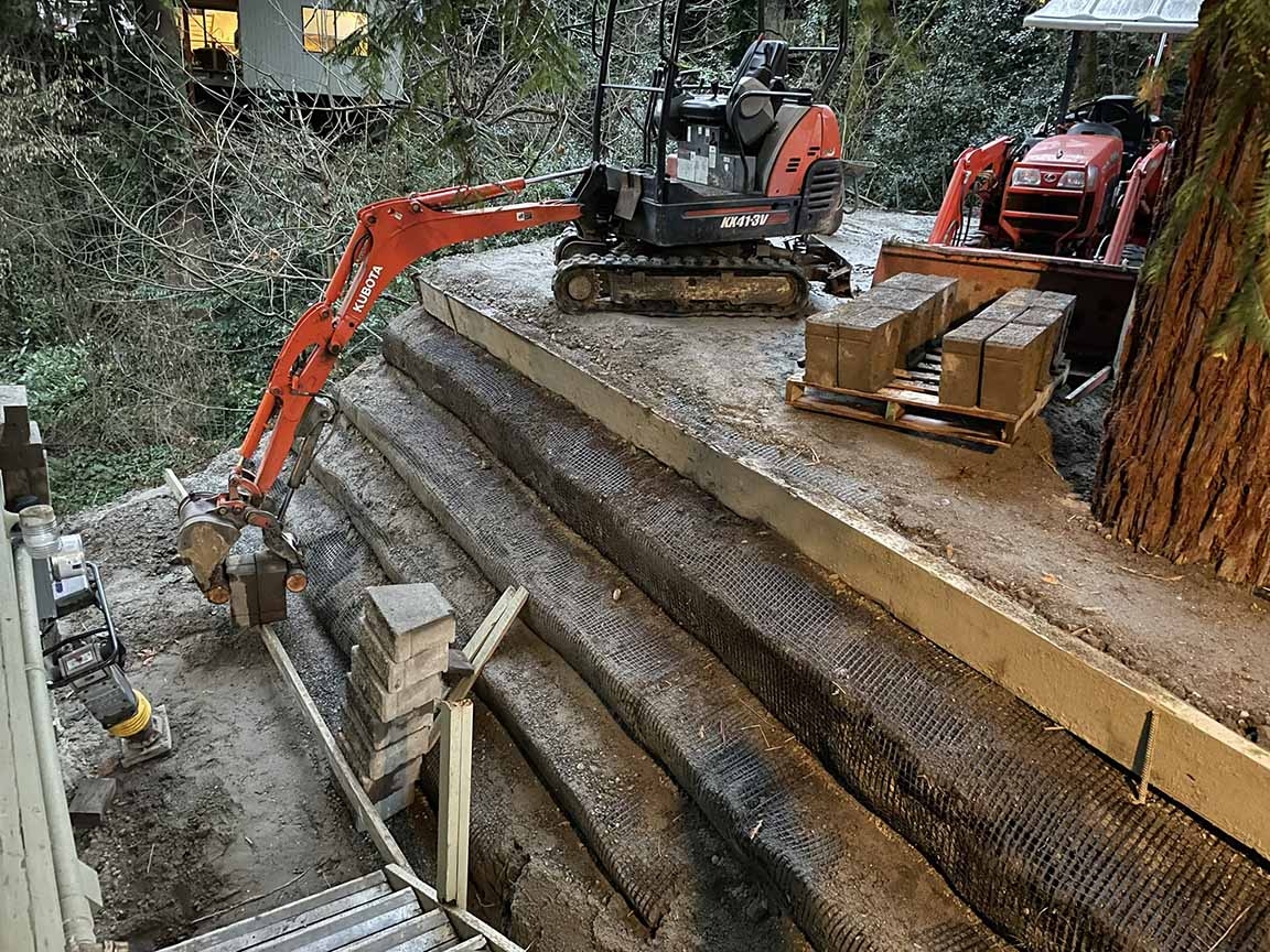

planning the project,,,,
I thought:
Just do 10 blocks in the morning
then
10 blocks in afternoon,
then go in the house,
....take a nap.
It will be done in a week.
With ease.
But looking at the mini-ex just sitting there
..... I entertained the idea ......

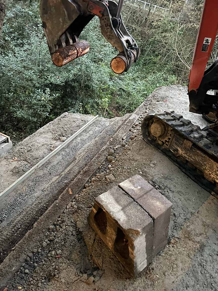

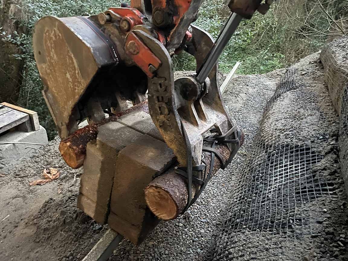

Soft-jaws for setting blocks at the bottom of the stairs.
And I get to use my favorite toy.

Clever. It would be cool if you could do a video

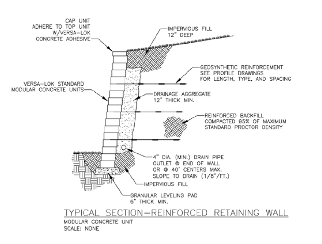

The blocks are typically designed to build a 48” high wall without additional reinforcements. The first layer is buried to key the wall and provide lateral resistance. The first layer should be installed on a well graded(not same size) gravel. Behind the wall the gravel should be free draining.

Second or third row down from the top looks like you would have room to do a "tie-back" with geo grid. Its cheap insurance.
While the geo lifts may not push....you still have alot of material to backfill. And dirt or sand absolutely will push. Its imperative that the backfill be with washed and screened stone. "free-draining" as mentioned earlier.
the top 6" or so can be topsoil if you choose to plant grass or flowers there. A layer of geo-fabric before the layer of dirt wouldnt hurt

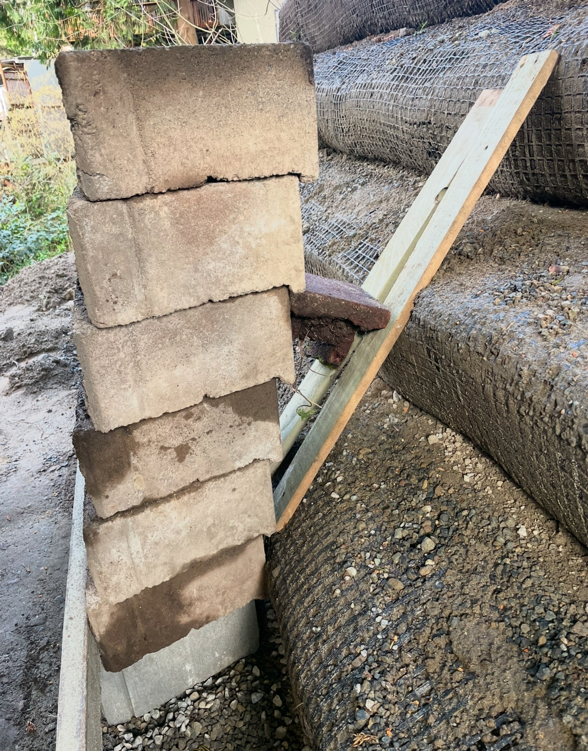

The additional picture really shows the issue much better.
Because of the amount of labor involved and never wanting to do this again, I'd check for any YouTube videos that discuss this. Fine Homebuilding might have some articles, too. Might even try calling a manufacturer's rep for whoever made the block and certainly look at their installation instructions.
From what I quickly saw, some YT videos strongly advocate using geo grid to tie the block back to the fill material, but I didn't watch enough or read enough to be confident this is the best way for your situation.

I Like your soft jaws very clever. I really would try to get a drain in behind the wall even if it is a smaller two inch drain at the bottom of the wall and then a 4 inch drain higher up. the large drain would handle most of the water and then the small drain would handle whatever gets below the large drain. you may have to make a 2 inch drain. not sure they are available commercially
