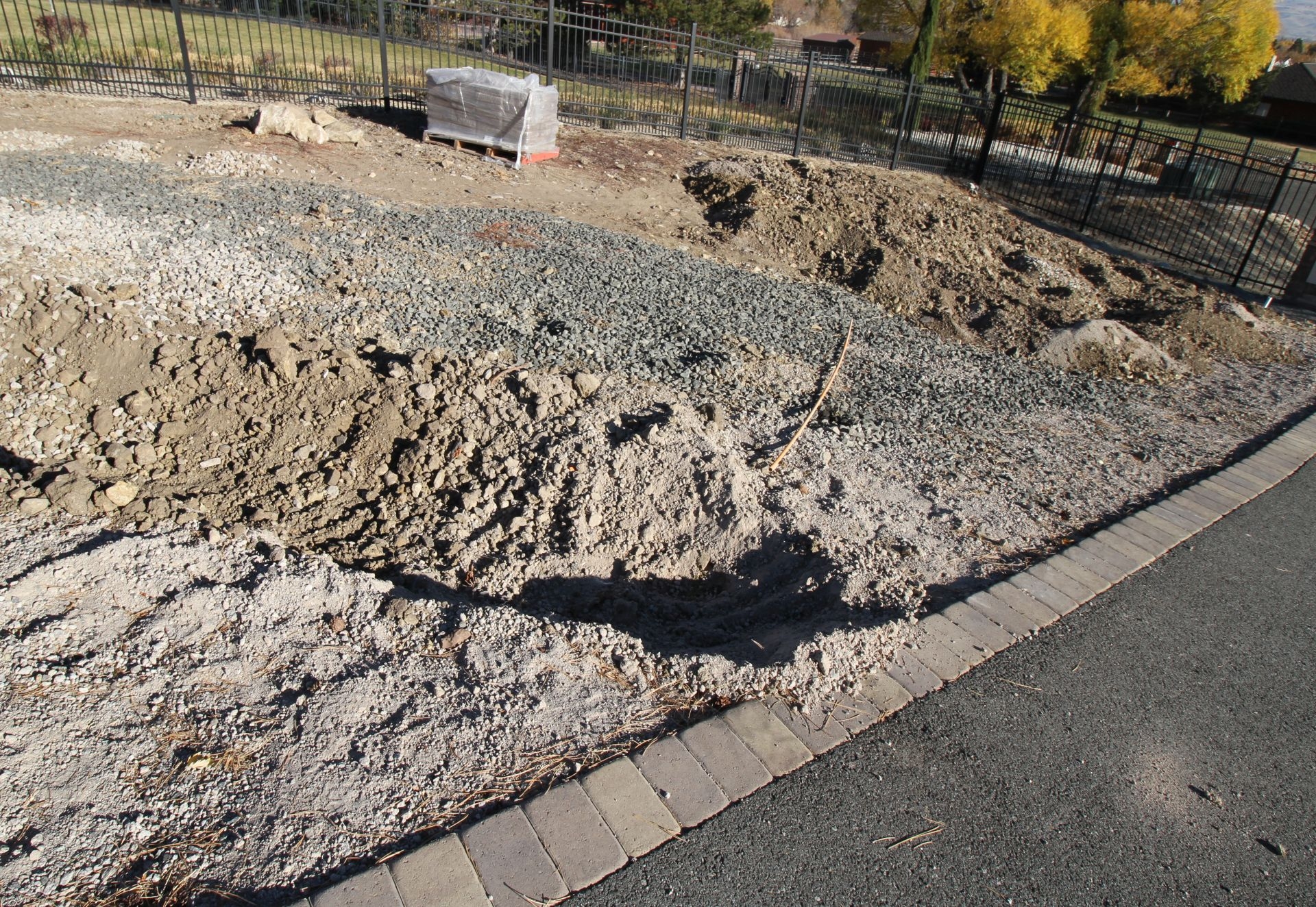

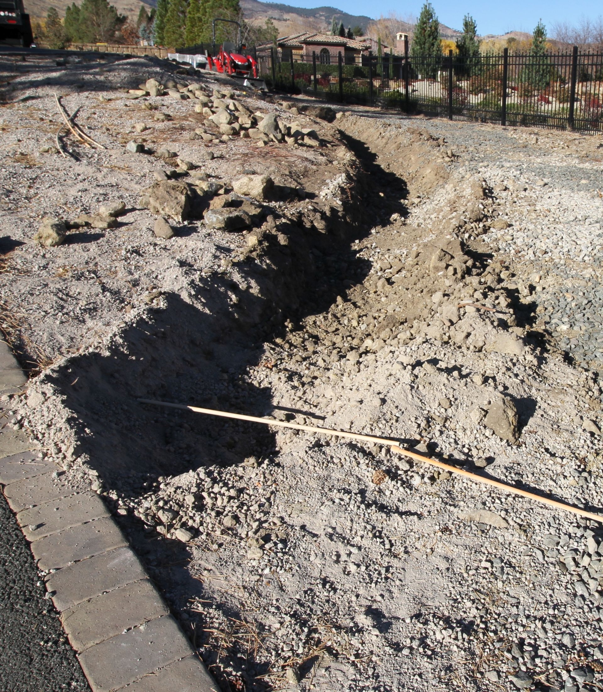

I'm building a retaining wall using stacking stones (not the kind with a lip in back.) It's kind of a lazy quarter-circle shape, slowly descending, about 100 ft long, with a gentle slope behind it.
I have excavated a trench about 2 ft wide and roughly a foot deep-- for 6" of compacted type 2 road base, then the first course of stones below grade. The top of the first course of stones should be roughly at the current grade. As my wall goes up I am planning to backfill with 3/4" clean gravel. I am undecided yet on whether to put a pipe on the back side of the wall, or whether to use fabric if I do add such a pipe. I am wondering if the gravel and natural slope will provide the drainage I need.
My concern is trapping water behind the wall. I need to get from behind the wall to daylight. I want to somehow pipe from behind the wall, through the wall, under a gravel driveway, then to daylight. I am not sure the best way to do that?
Should the bottom of my drain pipe (behind the wall) be at the same grade as the bottom of the first stone? Both would be sitting atop compacted road base. If so, this means the pipe needs to go through the wall and I am not sure how best to do that, such as cutting stone blocks. Or should I have my drain pipe even farther below grade, with the pipe embedded in the compacted base (or perhaps in embedded adjacent gravel instead) so the top of the drain pipe is roughly equivalent to the bottom of the first course of stones?
Regarding piping, I am guessing SDR 35 4" pipe is a good choice once I am outside the wall and to take it (underground) across the gravel driveway. But what about a pipe behind the wall to connect to the SDR 35? I have heard horror stories about the 4" black corrugated drain pipe collapsing or getting plugged.
Any suggestions?

Most of the time when I see it, the first course of block is put in atop compacted base, then you toss a drain tile with sock on it behind the block, cover with gravel and call it good. I dont think you would want the drain pipe within the fully hard compacted base, as this will inhibit drainage flow into the pipe itself.
Hard to tell from your pics, but kind looks like you could get away with no drain pipe/tile at all. As long as there is a drainage path on the surface, you don't have heavy clay soils, and your wall won't be too tall (say, under 2-3' high), you'll be fine. Is this in rainforest northern CA, or dry northern NV?

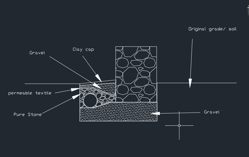

You want the water to run away from the wall and a place for the water to flow too, the illustration is how I would personally do it, now I am not sure if you want pure stone below the wall or not but I would think it be a good idea although I am not sure if I would or not. Compacted gravel like 3/4 minus is pretty impermeable so the pipe can be on that (actually better to be on gravel) but the grade should go up from there to the base of the wall like the illustration below. Now only pure stone with a permeable textile would be fine as well as long as you have a permeable textile on top... pure stone has 30% void within it but flow grade is paramount.
