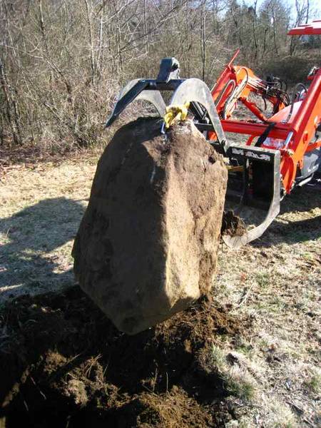

hmm, seems like the most comparable thing today is the 48" Wildkat economy. I have to see how wide that opens. As your one pic shows, I want to be able to pick up big diameter logs and rounds to split up for firewood. Regarding large rounds, I have a question. Say I have a 36" diameter round that is cut to a 20" length. If the round is set on it's side, so cut sides facing out, is it possible to pick the round up clamping on the cut ends? So tilt the grapple to full dump position, and clamp and pick up by lowering grapple onto the round from above. Reason I ask is I want to be able to work large rounds onto the log splitter like this. Hopefully this makes sense.
Picking up a 20"x36" log in the manner you plan would be easy with most any grapple. Every grapple opens more than the 20" you would need. You'd just need to have adequate vision to judge where the bottom and top grapple tines are which can be a little tricky but you could rig a temporary mirror to help if necessary.

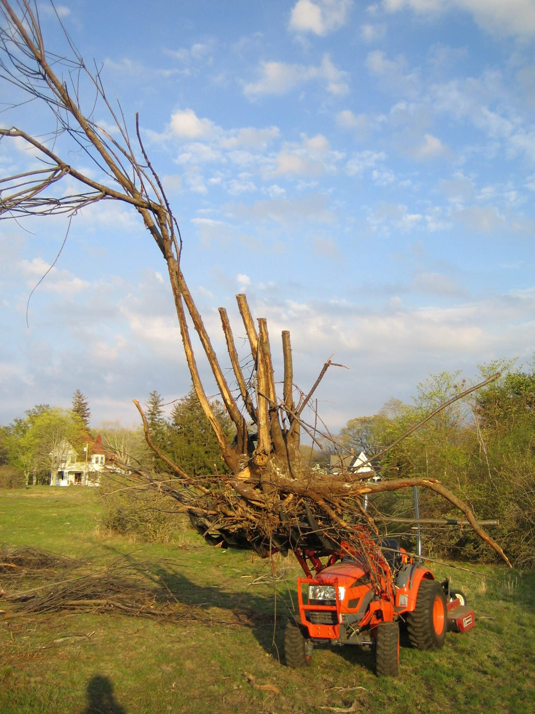

I will admit that I do not have a lot of grapple experience, but that is what common sense was telling me as well. I am leaning toward something like this for my own use OBG1 I was hoping for something I can use to move as much debris at a time as possible. I just worry about the ones with the long horizontal tines being able to get under and uproot things.
   / Which type of grapple is best suited for... #87
The grapples with long horizontal bottom tines are actually better to get bigger roots. The clamshell probably is more efficient for raking smaller roots but cannot get under the deeper thicker roots as well and cannot use the advantage of leverage like the long bottom tine OBG type can. Clamshells rake, OBG types lever. Both do well with roots generally based on TBN experiences.

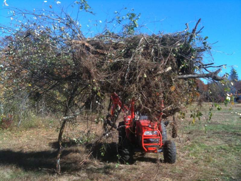

I purchased a EA 72" Wicked Grapple recently and have had a chance to use it for about 20 hours now.
I can't speak for other grapples because I have not used any of them but I will give a short review of the EA Wicked Grapple.
I went on EA's web site and decided on the Wicked Grapple based on the fact that it appears to be well engineered, light weight, strong and two independent jaws. EA's customer support is outstanding and suggested the 72" unit for my tractor.
A few days later my grapple arrived by truck, upon inspection I observed that this thing was a serious piece of equipment. It is built much stronger than I thought, and well engineered as expected from EA. As advertised those teeth are sharp and should cut though roots and grip logs well.
I hooked up the grapple on to my Kubota MX5100 and started learning how to use it. I am in the process of cleaning up large piles of logs, lumber and junk that the previously renter so nicely left for me to clean up. Anyway, after a few hours I was getting the hang of it and have stacked several large burn piles.
The grapple worked flawlessly, no problems and due to the lighter weight I was able to left more than I thought.
I then began using the grapple to dig around the base of a couple of trees that needed to be removed and pushed them over. Then I just picked them up, put them on the burn piles and then scrape up the debris and some roots.
Those sharp teeth really cut though the roots and really dug into the logs holding them firmly. The two closing lids really came in handy for those odd shaped logs, stumps and even some concrete steps.
Since putting the grapple on my tractor I have not had it off, even when mowing the field I use it to warn me of large hidden objects in the tall grass.
Lastly, I want to give EA a big Thank You for building a great grapple, great customer service, fair price and free shipping. I would highly recommend this grapple, I would buy again if I needed to.
I am in no way paid, compensated or have any financial interest in EA only a happy customer.

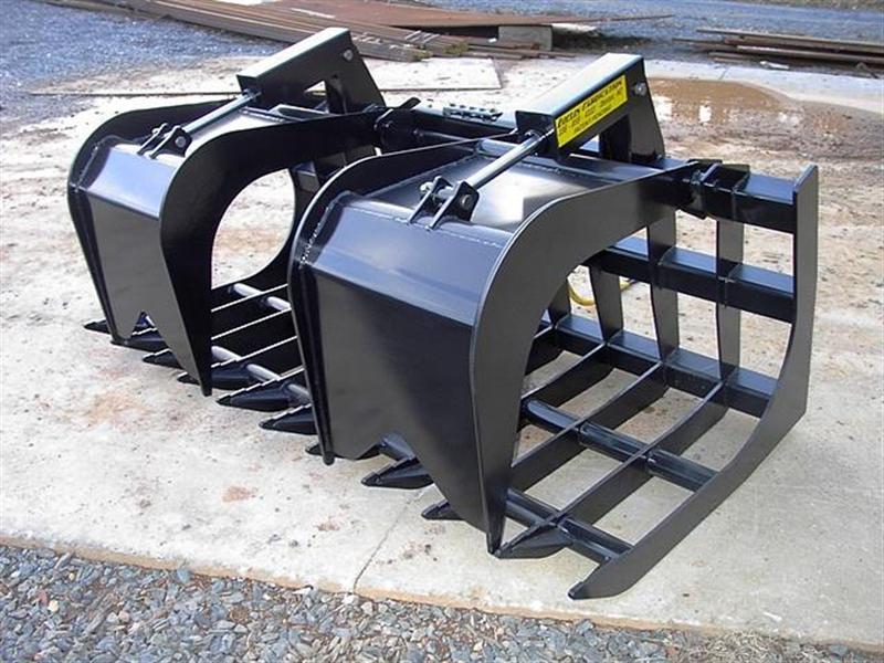

Does anyone have any first hand experience with both the OBG1 and the Everything Attachments Wicked Root Grapple for Compact Tractors ?
I am torn between the two. The everything grapple is a little bit cheaper, but I have never seen one in person. Any input would be appreciated. This has been a great threat; I've learned a lot.
The Wicked grapple is lighter than the Long grapple. I have a wicked grapple. I love it. My tractor will never hurt it.
The WR Long OBG1 opens to 47" while the EA only opens to a mere 30". This is an apples to oranges comparison. You might want to compare WR Long's OBG2 for price range and even it opens to 44". The EA grapple is too small in my book on the vertical opening which is what you need to you grab debris. In any event, I would go narrow with an L grapple.
