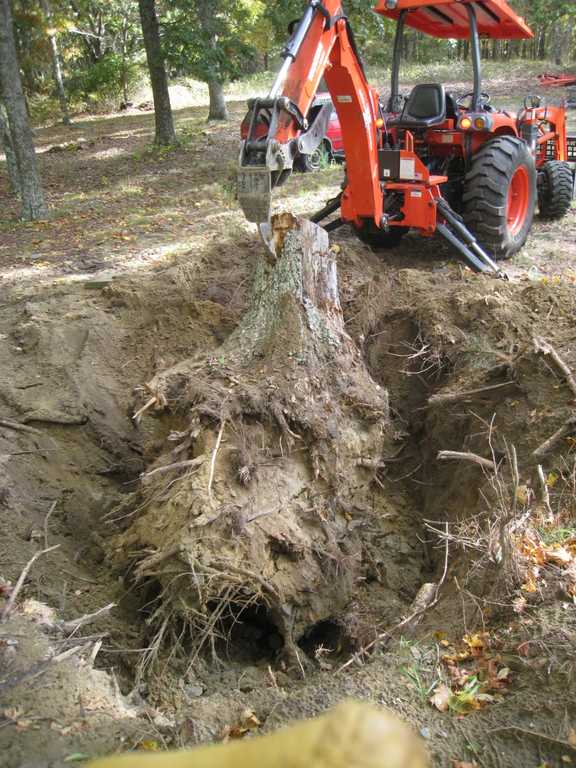

1) With regard to the photo you posted, I have lifted/clamped many many stumps like that. You highlighted a big root you presumably think would interfere with my getting a grapple closed on the stump. I doubt it would be an issue and if it was I would simply roll the stump a few degrees to get it out of the way. Never had a stump I could not clamp. Never. Period. Had a few that were too heavy to lift out of the hole but once I pulled them out I could lift and clamp them. Photo below of one such stump I had to pull out with the BH but was later able to move with the grapple.
Your grapple would have to open really wide to clamp that stump at the root. There was not any rolling this stump.

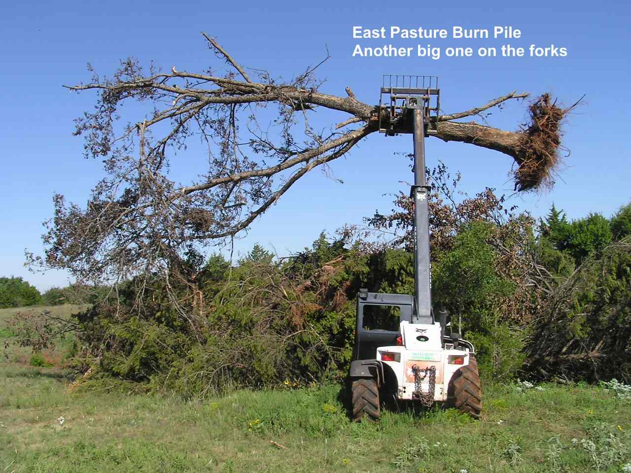

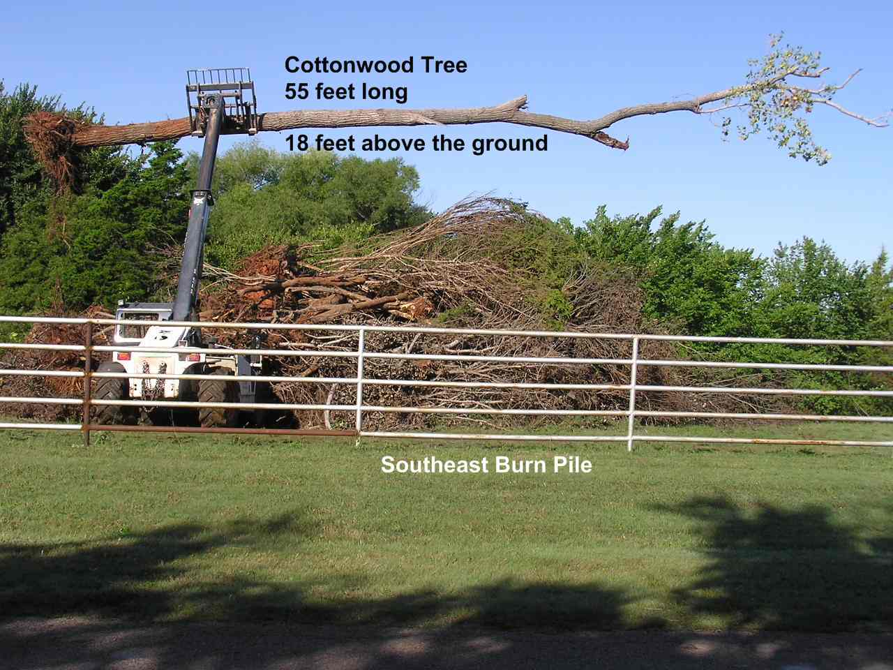

Look what can be done on forks, no grapple!
I pulled them with a chain to the pile, then picked them up and dropped them on the pile.
