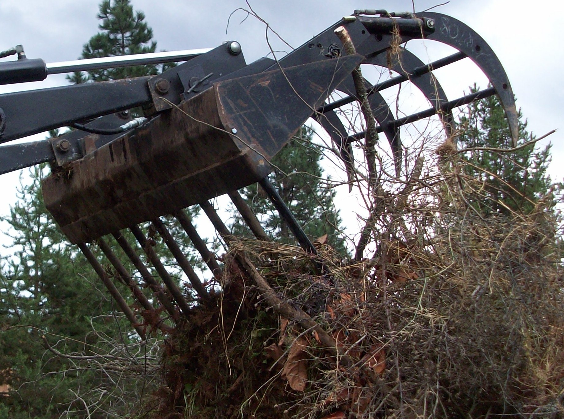

I think the EA wicked grapple is a very nice grapple. I really like mine, it is my favorite attachment.
It works good for brush.
It also works good on stumps.
Before
After

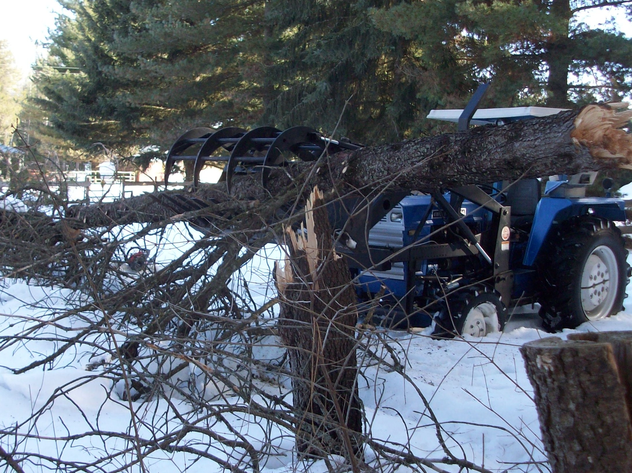

Those big grapples are great if you have the tractor to handle them. It takes a lot of grunt to really use a rock or root rake to clear land. I have a 15000 lb dozer with a root rake and it is really to small for that job. If you just need to do light tractor work or pick stuff up and move it there are lots of options
I have a 30 hp tractor with a pin on bucket so I bought a light weight bolt on grapple so I wouldn't loose to much lift. It is quite capable but not scary looking. Also, both the bucket and the grapple are always right there when I need one or both. Have had it about 8 years. I would not discount a simple solution like this. It has served me very well.
