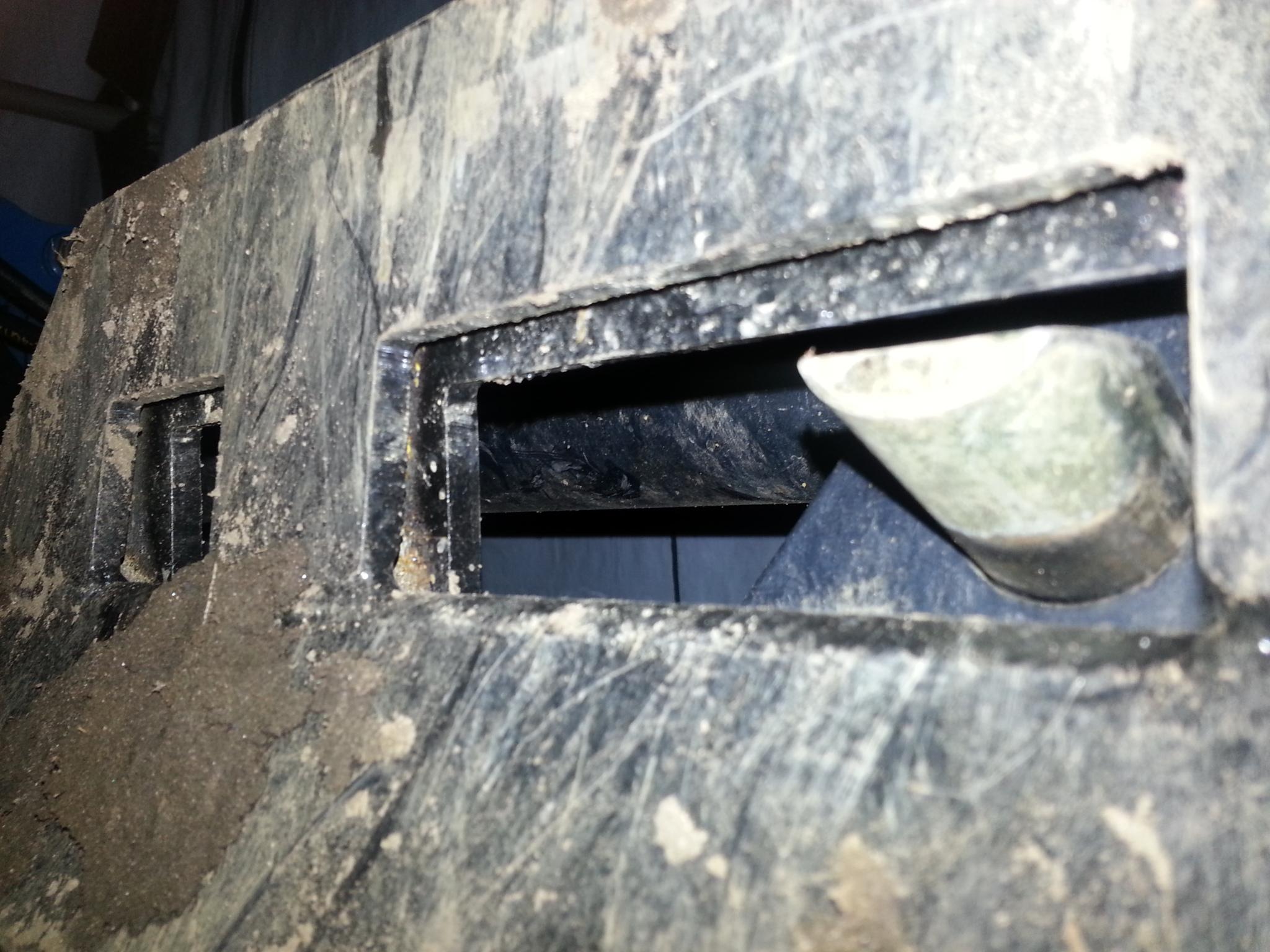

So I put an hour or 2 on the tractor tonight using the grapple. The more I use it, the more disappointed I am with it. It seems 9 times out of 10 when I pick up a pile of stuff with it, almost all of it falls out. 2 different things are causing it, 1 is the lid design, and the other is the tine spacing.
With the lid design, it never actually can pinch anything between the tines. Also, having only 2 upper tines, there is little chance of actually pinching anything.
Even 'scooping' stuff up doesnt seem to go well for me. I seem to dig more dirt than anything with it!
I can see it working just fine with pile of brush, but I am dealing more with deadfall and firewood type chunks.
I also discovered today why it 'clatters' so much when adjusting the roll of the bucket, or up/down (anything really that jerks it in general). The quick attach openings are too large, and I have almost a 1/4" gap between the pin and the 'locking' side of the opening.
I know some of my issues are possibly still adjusting to using it, but I can see some things are not going to resolve with experience.

   / Which type of grapple is best suited for... #266
I forgot the picture that shows the gap I am referring to....
I would fix that gap pretty quick with a welder and some steel. Show the photo to the manufacture, and if you don't weld yourself , take it to a local weldor and see if the manufacture can pay to have it done.. Should not be much money. I would be afraid with it shifting around, it might pop off on one side and twist your SSQA. I really think you ought to fix it.

I plan to fix it - problem is, I only have my dads 110v MIG here, and my trailer axle has sprung a leak so to speak.....
<img src="http://www.tractorbynet.com/forums/attachment.php?attachmentid=317391"/>
110v MIG running fluxcore would be fine. You just need to put in spacers. Tack welds would probably work so a bead of 0.030 fluxcore would certainly do the trick.

I fixed my Wildcat grapple and forks with putting 1/4" spacer plates on the bottom brackets. Works great and the implements fit tight now.
