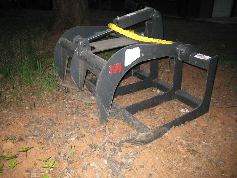

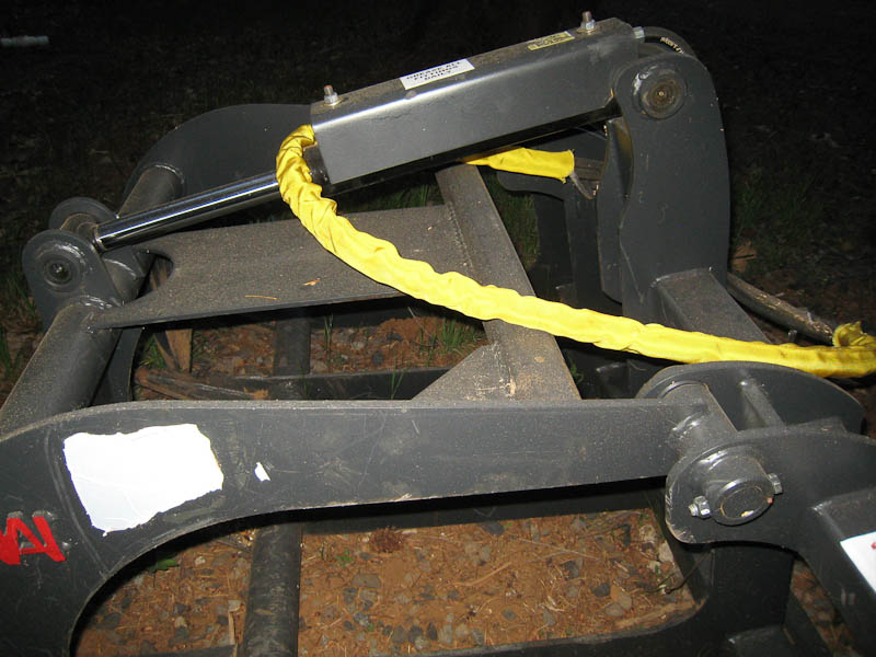

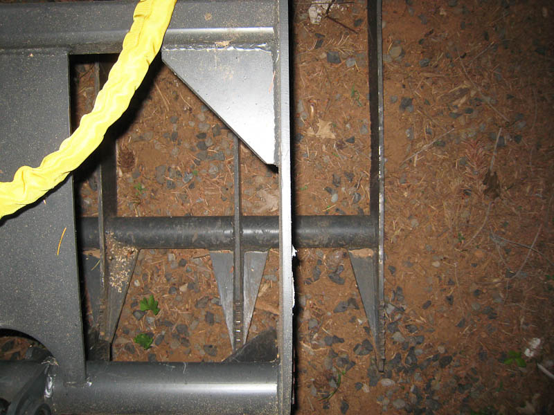

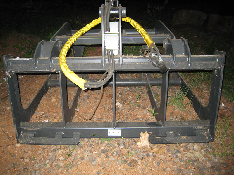

Caspar, when did you buy yours, I recently got a quote for $1016 plus $145 shipping. I noticed the grapple pictured in the link you posted has 7 bottom tines. Is the one pictured the 48" I thought the 48" only had 5 tines. I also noticed some photos so the bottom tines are straight while other are curled up, is this an option.
I sent them an email in August for a quote and they gave me $820 plus shipping. When I called in January to order, Stella said about the same $1000 price. When I mentioned the $820 email quote she immediately said "OK, I can do $820". Of course my shipping was more... about $400 to get to the west coast. :( Ugh.
Yes, the 48" has 5 bottom tines. All of them are the same shape and turn up a little at the ends. It appears to be very well made. These pics are after is started getting dark, so maybe not the best view. I'll try to remember to get some action shots tomorrow. Got some big logs to move and buck.

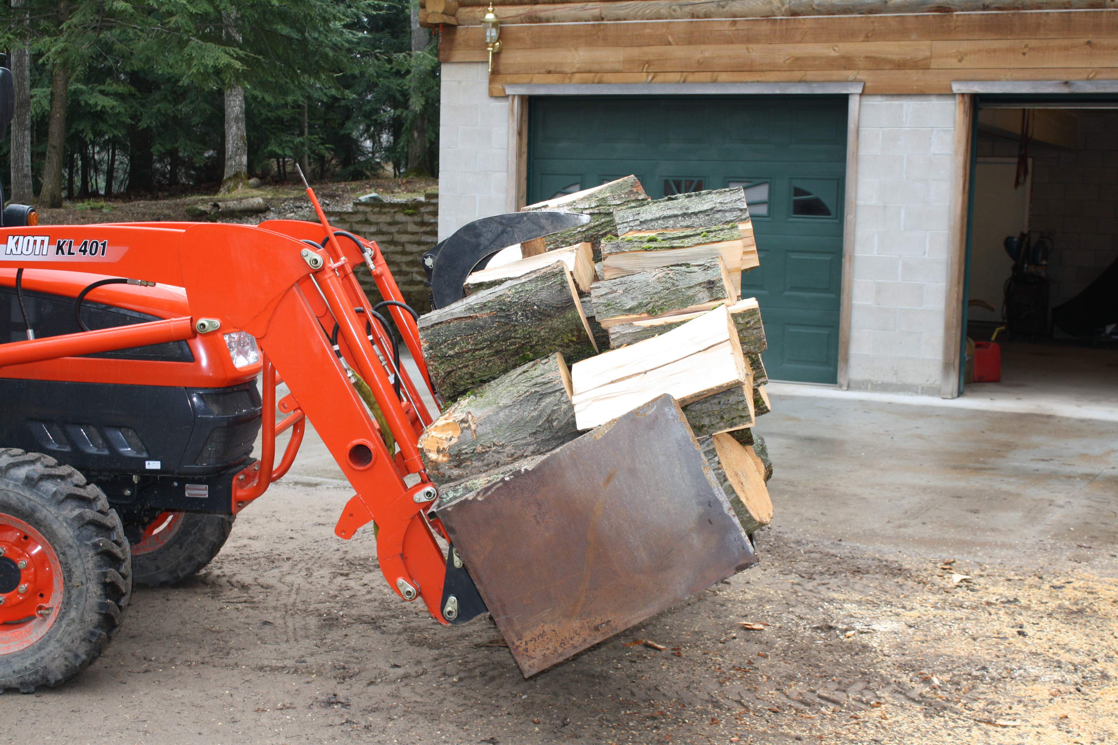

Those are some nice grapples you guys have. One question though; Will those NIA and similar grapples bite down hard on a small log like 12" to 16" or do the logs rattle around in there. I know my grapple has limitations being the bolt on type but one thing I like is that it holds any log I pick big or small firmly. It is also easy to pick 2 or 3 and it holds all of them tightly.
It is possible to clamp that size log but I usually just hold it in the bottom by curling and closing the grapple arm to keep it contained. So long as it is reasonably balanced it doesn't move. However, I usually have more than one such tree in the grapple at once and in that situation the load is generally compacted by the upper arm.

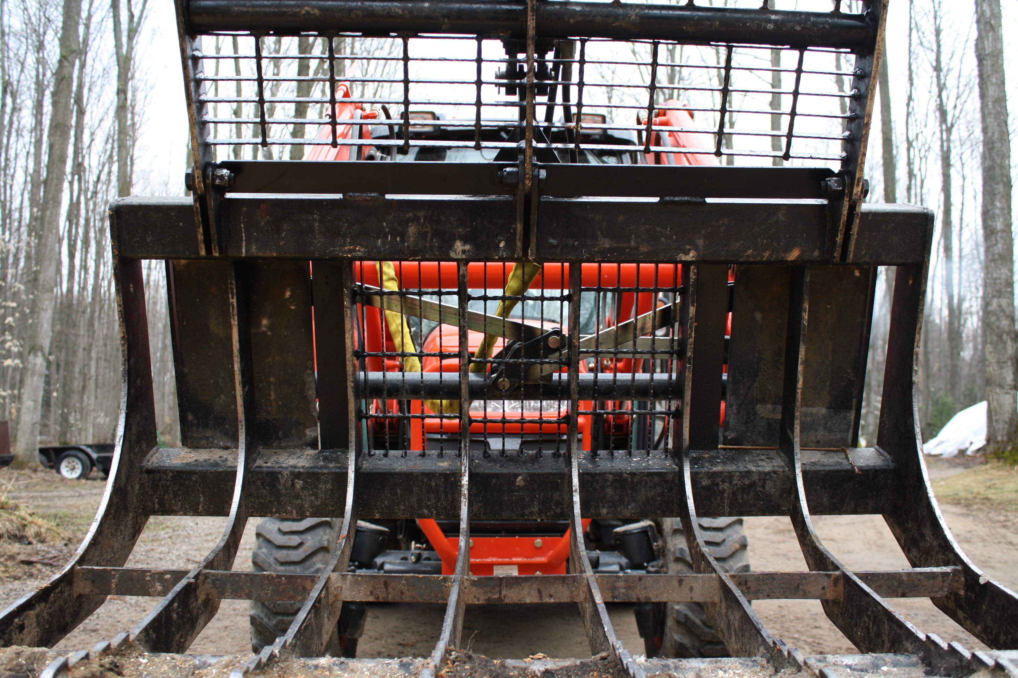

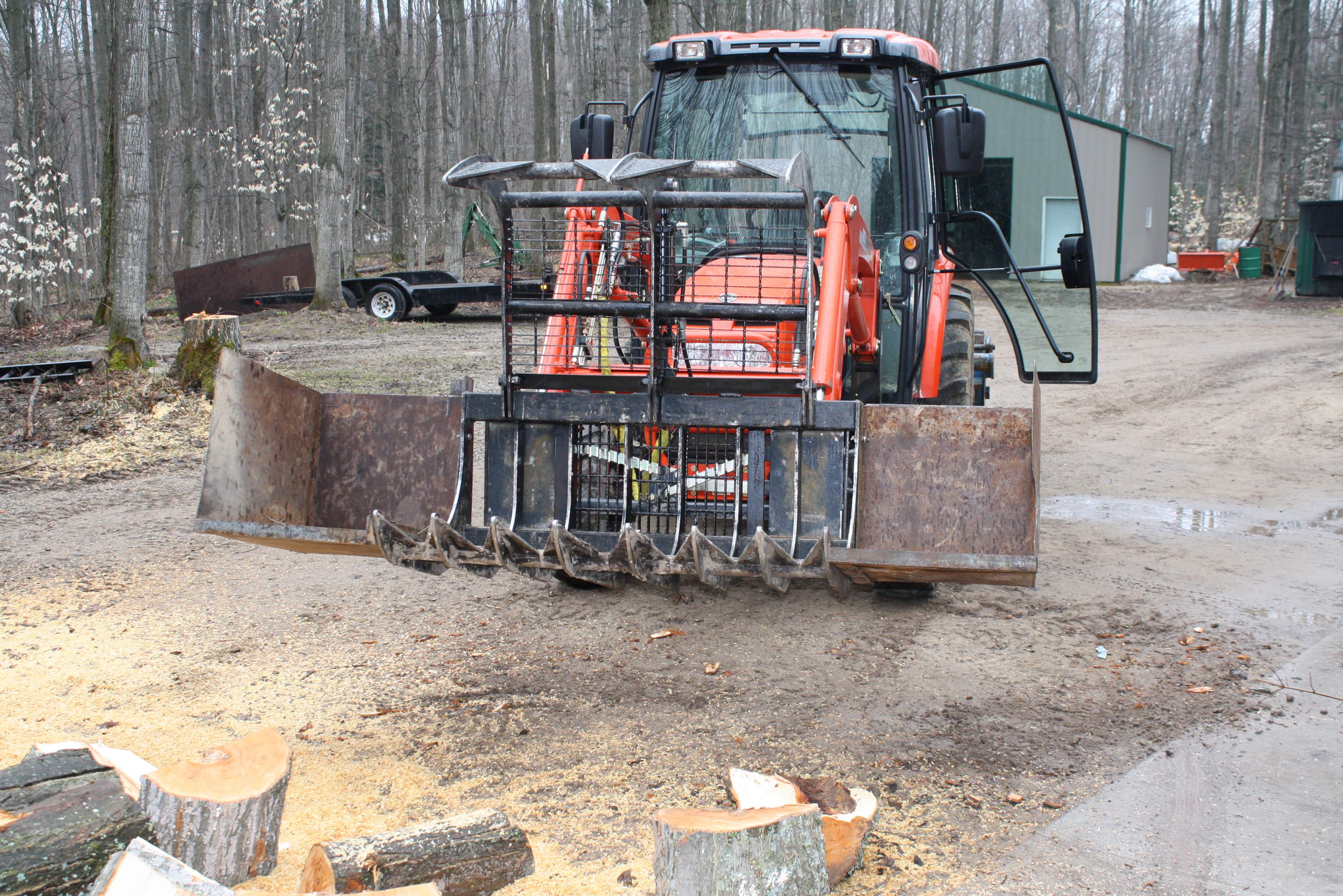

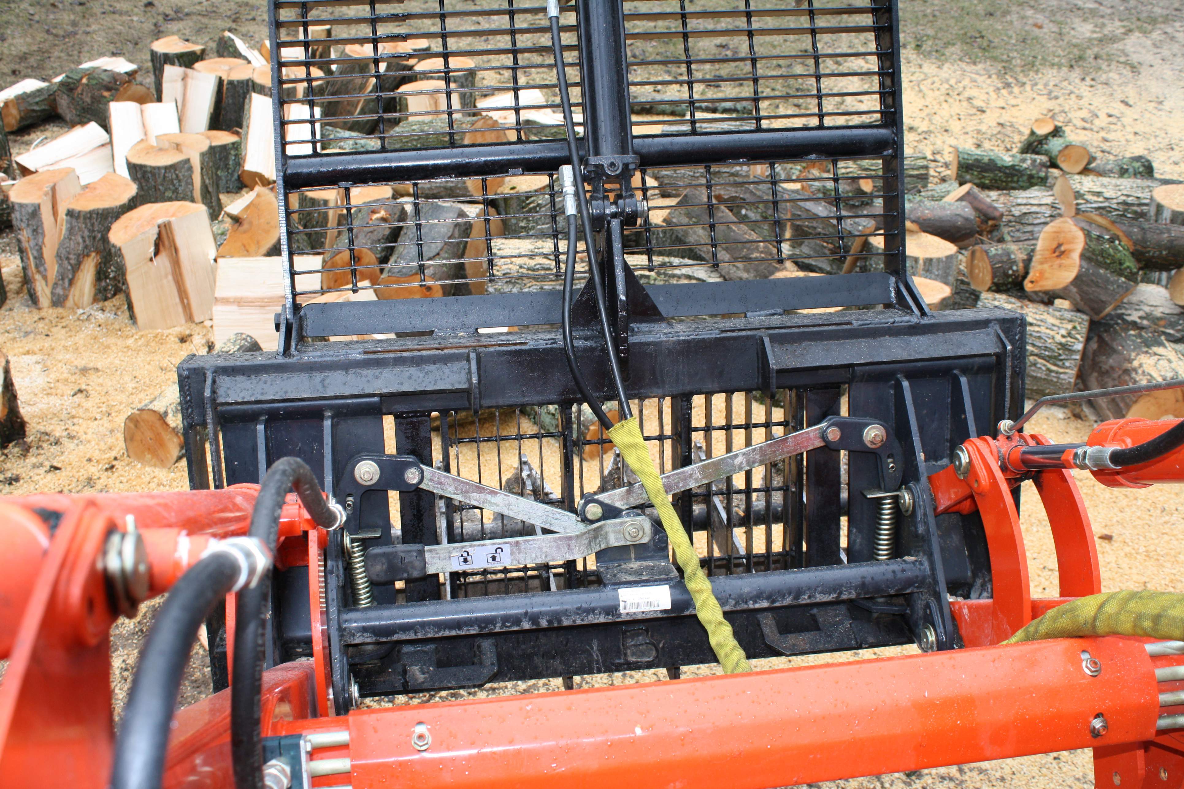

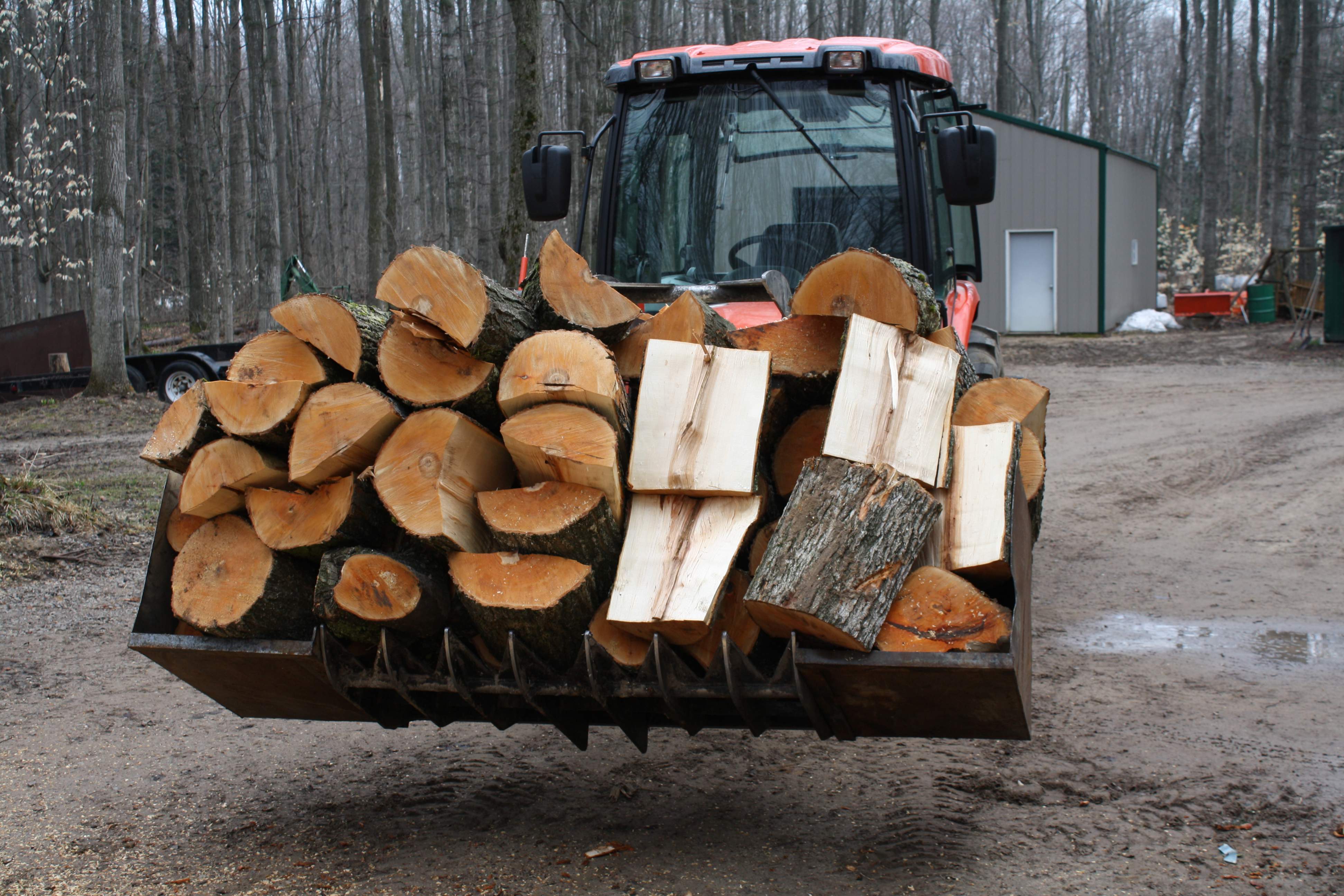

1st and second pic you can see the added bars on the bottom to keep the wood from falling through and the walkway grating and added steel straps at the back. The 3rd pic is with the sides on [I know they are not painted but they work] The 4th pic is loaded with 2 rows of green hard maple [yea it's heavy] The loader will lift it about 5 feet. Here is a pic of the added bracing 2x3 angle and top gussets.grapple 002.jpg and another of the front loaded.grapple 005.jpg
