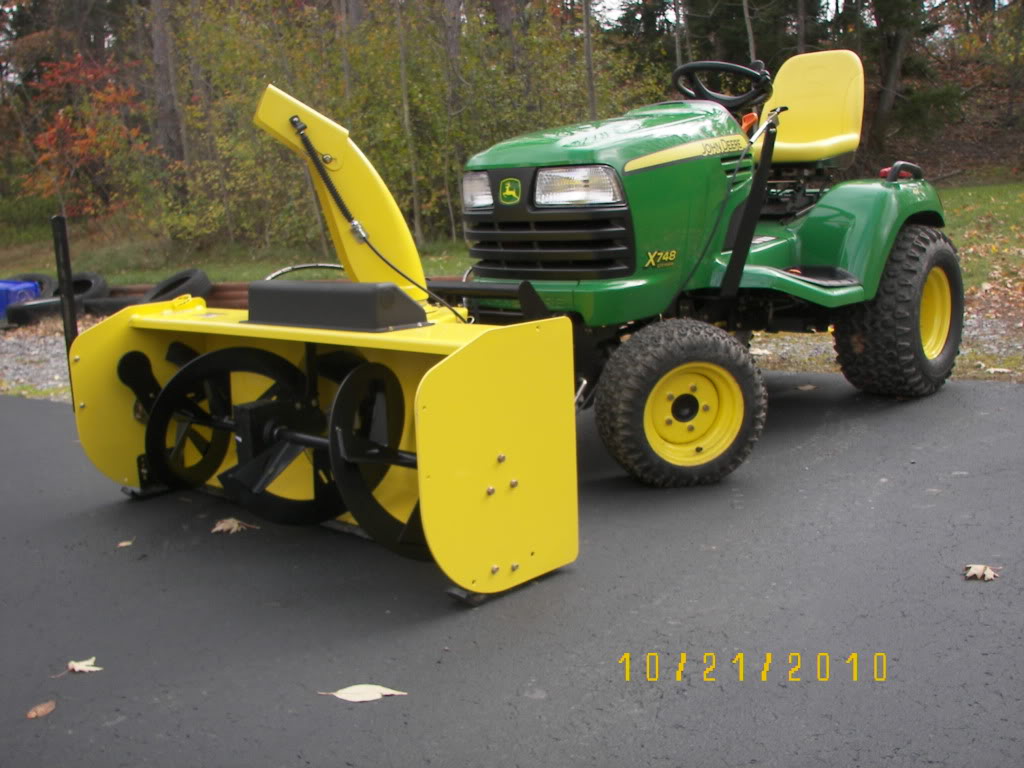

/ Which model for snowblowing 500' driveway? #9
This is what you need to go look at.
