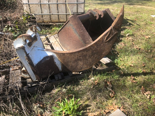

Here's another option for you and your land. This is the one that I recommend to friends with new property and little tractor experience...
1. Most important: Simply hire a skilled operator with a bulldozer to rebuild your existing roads. He will do more for less money than you can even imagine. He may even make you a few new roads. It's what bulldozers do, and they do it remarkably reasonably. Slopes don't bother a good operator.
2. Then after the bulldozer leaves you will have gained a few years which you can spend maintaining rather than creating and can simply go with whatever tractor you like best. Your world of usable tractors just expanded tremendously because most all will work. Larger and older will be fine. Get a nice FEL and a tractor you feel comfortable using. Most people with 40 acres or more end up with a tractor plus a dedicated mowing machine.
You will need one special rear implement for the tractor, so be prepared to spend real money for a heavy back blade with adjustments for angle, tilt, and offset - and also get the optional shoes and endcaps, That back blade will cost in the region of $2500 for a six footer, but it will maintain a dirt road nicely AFTER the bulldozer makes the road. Rhino and perhaps Land Pride and a few others make that sort of blade.
Unfortunately, you cannot make the road initially even with that nice back blade behind the tractor because the tractor will be pulling it, whereas the bulldozer pushes it.
No FEL has the same versatility as a bulldozer blade - That's because FEL buckets don't have tilt and angle capability independent of the tractor. And even if they did have that capability and a front blade instead of a bucket (which few do) then tractors simply do not have the traction to push a front blade like that.... something that a bulldozer does with ease.

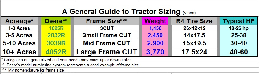

I like these HP tied to acreage charts. They make me giggle.
Seriously, probably a good idea for a first time buyer to look at so they can narrow their research but beyond that I think it quickly looses its utility because there are so many other variables. The primary uses of the tractor far outweigh the number of acres the tractor is used on.
The point of that chart is to get newbies to consider factors other than HP, like frame size, weight and tire diameter = TRACTION and ground clearance. It also says YMMV
