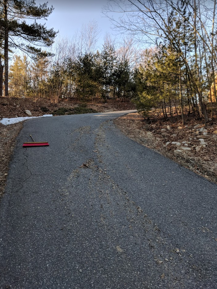

That's a 70% grade - sounds frightening!
Any pictures?
Yep, you nailed it. Here's a picture. I have realized it is impossible to capture hills with cell phone cameras
