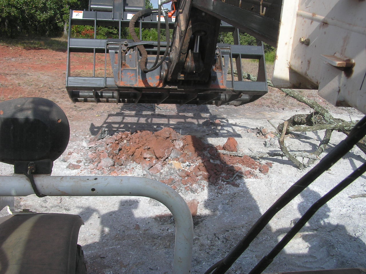

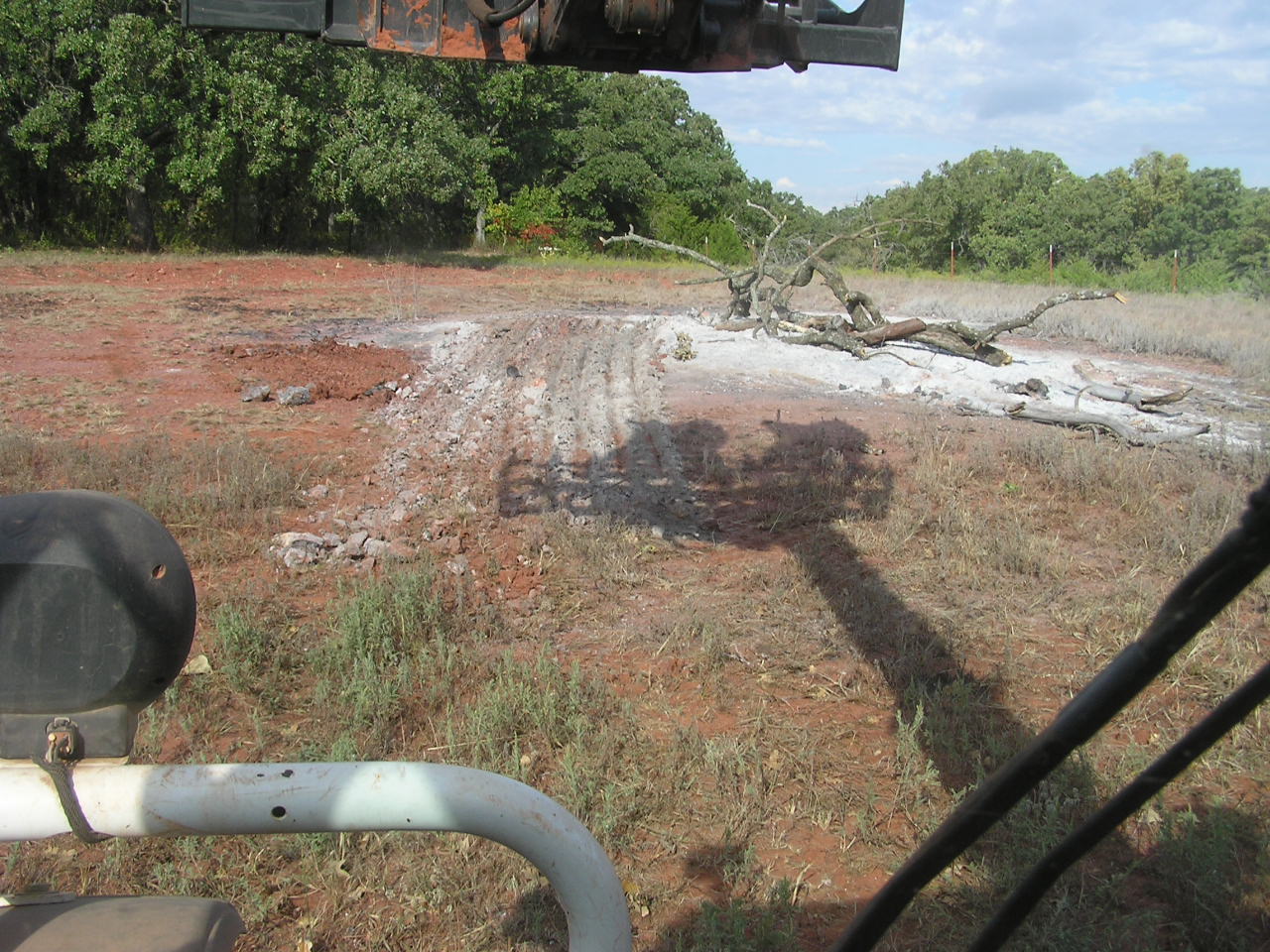

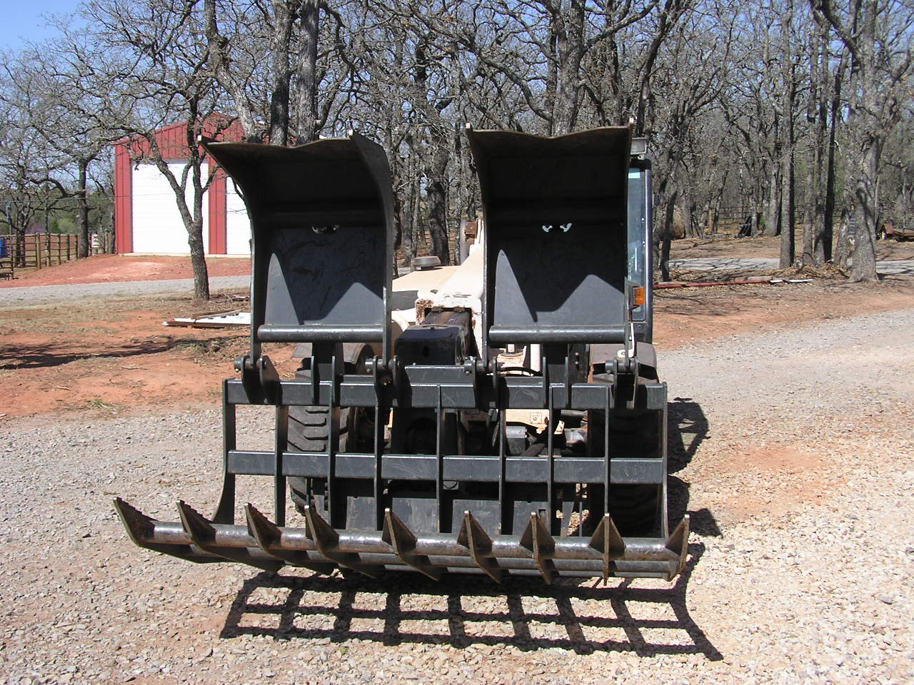

It is 72 inches wide and covers the tracks of the V417:
I have used it a few times back dragging to level something:
For a V519, unless you need to remove plant growth with the 8 footer, the 7 footer will cover its tracks and the 6 footer will be much better than no grapple. :thumbsup:

For me the width has never been an issue. I don't use it for pulling vines, bramble or brush.
View attachment 532746 View attachment 532747
