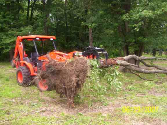

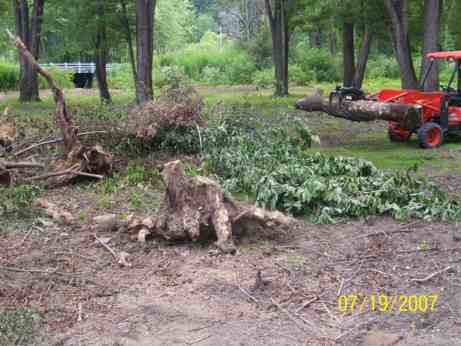

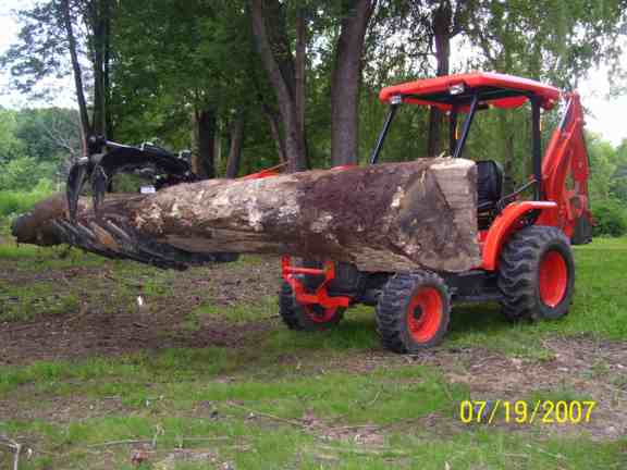

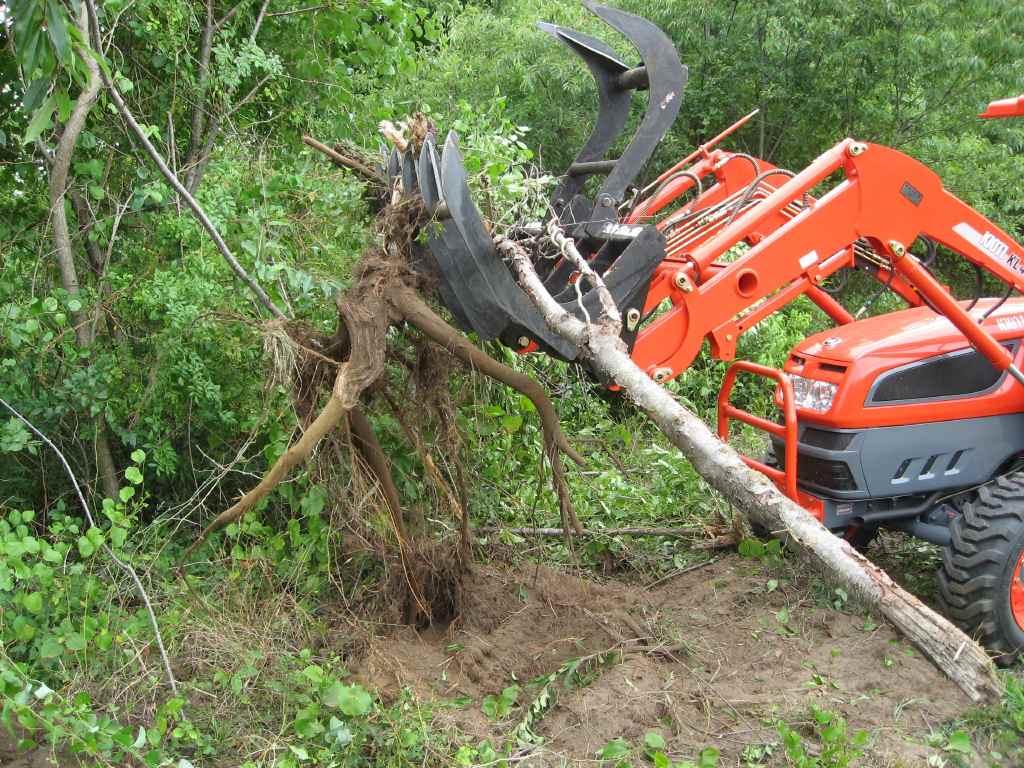

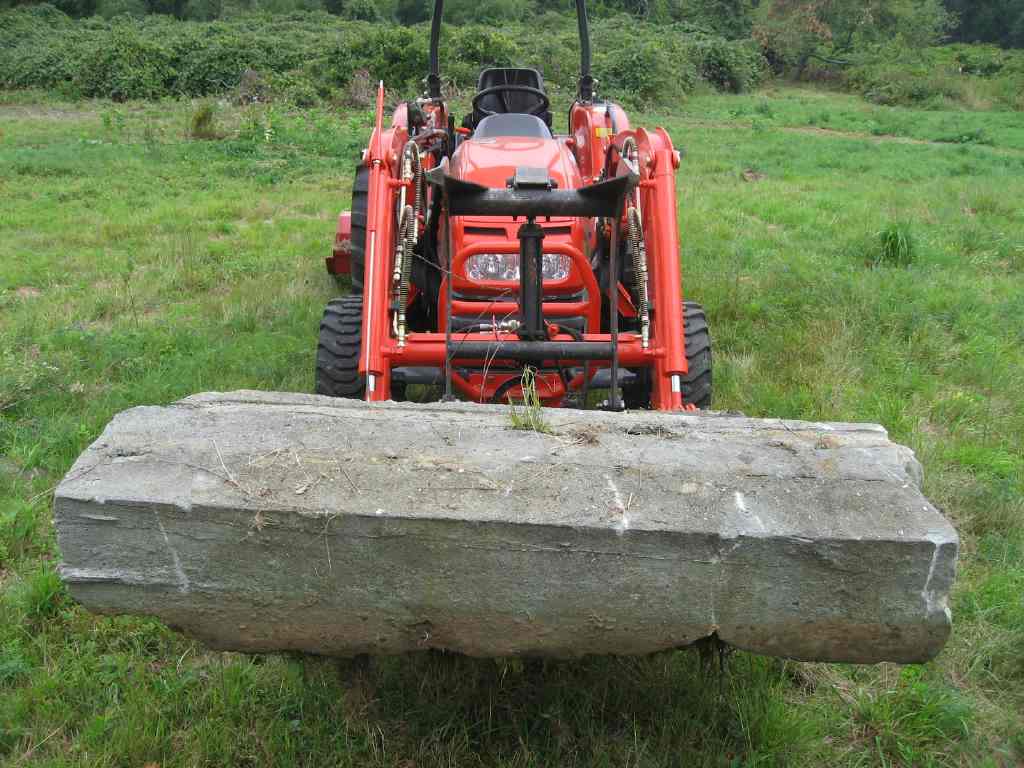

Whoever is advising you to buy a grapple as big as your bucket must never have used a grapple for brush clearing in my opinion. No, you don't want to be left with 1400lbs of lift weight on a tractor that size. You don't want a grapple that big because it a) cannot hold any more material, b) is unweildy whereas a smaller grapple can be placed more precisely, c) the larger grapples tend to have two arms (complex, costly) d) with two grapple arms you have no grapple arm in the middle of the grapple which is exactly where you need it. If you want to grab a bush or small tree head on to rip it out you don't want to have an asymmetrical load on your loader. With two grapple arms on either side you don't have a choice but to do that. A single grapple arm allows you to snag the bush midline and lift or push without torquing your loader. Finally, e) a bigger grapple is heavier and that means less net load capacity.
I had a 280lb 48" single arm grapple (Millonzi 48LD) on my 21hp tractor and when I upgraded to a 41hp tractor with an FEL that lifts 2700lbs at the pivot pins, I just moved the grapple to the new tractor. Today I used that grapple to lift a concrete barrier that weighed so much my rear end got light despite 600lbs counterweight. I could not have lifted that had the grapple weighed 600-800lbs. I then stuck the grapple under a 9 foot bush clamped and curled it right out of the ground then took it away in one piece.
A 48" "light duty" grapple is more than adequate for just about any CUT FEL out there. It also costs significantly less than these premium grade grapples made of T1 steel. Compare about $800 to about $2500+ for some of these fancier grapples. They might make sense for someone with a larger skid steer who does construction demo all day long but the big expensive grapples are just a waste of money and lift capacity for someone clearing brush/trees with just about any size CUT.

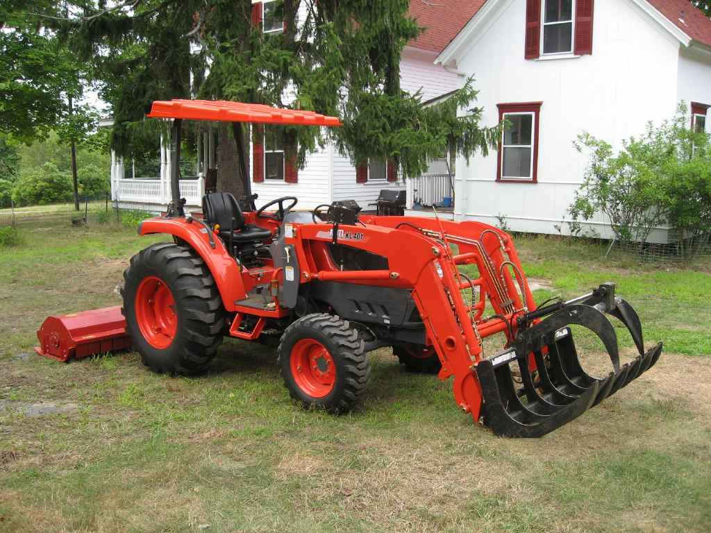

Others may be superior but I have a Millonzi 48" on my L39. The FEL has a load capacity of 2200lbs and its nice to have 1800 to 1900 lbs of lift left after the grapple. Obviously much depends on the application but for $710 (I picked it up - no shipping) you can't beat it.
