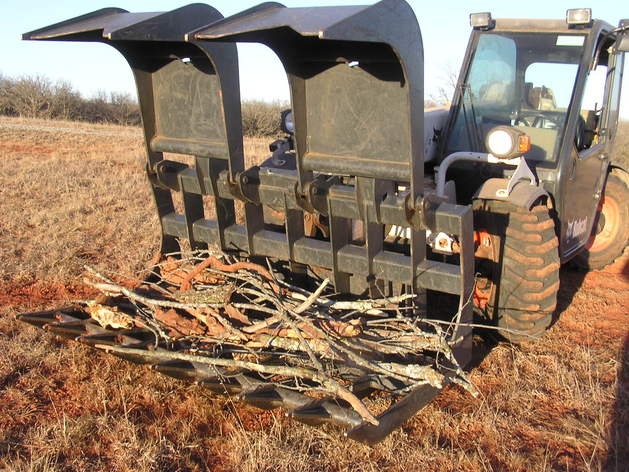

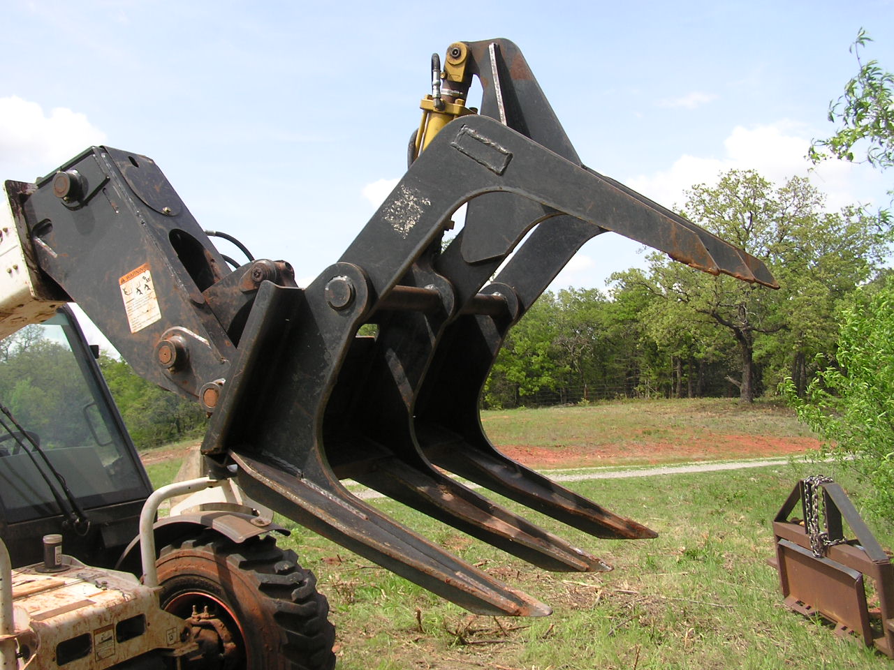

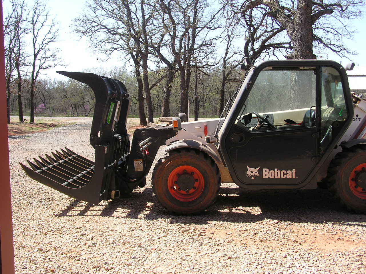

No problem. The grapples that I have won't be ideal for your tractor. The little Gorilla Grapple that I bought to pick up cut off cedar trees is 44 inches wide, 31 inch opening and weighs 946 pounds:
The Monster Grapple That I use for picking up dead tree limbs, weighs 1168 pounds and opens to 51 inches:
Can't do this with a clamshell style:
You don't need a link, just click the little "View Post" icon after my name in post #36 that I quoted above.
So, if you could only buy one, would you get the narrow one or the wide one? Which one do you use the most?
Also, do you see an advantage to having two lids, or would one center lid on the wide grapple work? (I'm thinking one wide lid would likely twist if clamping a load wider at one end, but a narrow single lid in the center i would think would be ok... or am I not thinking right?)

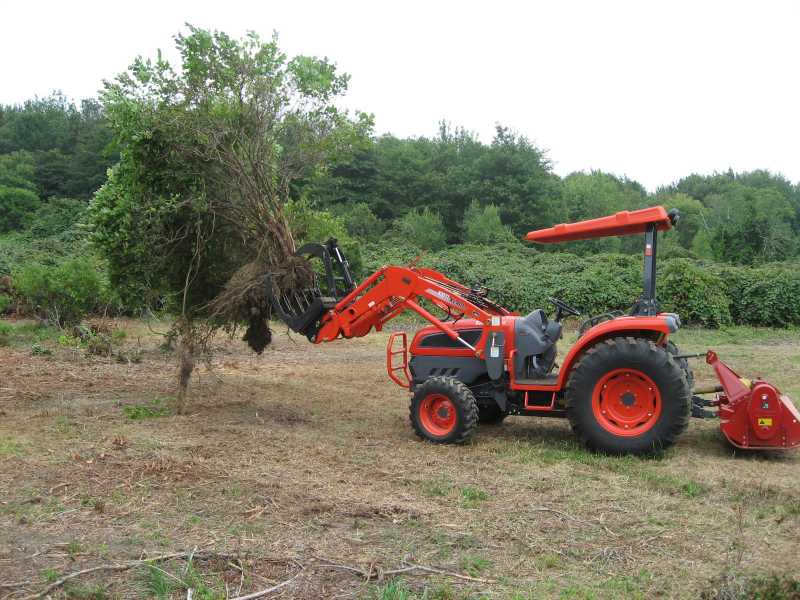

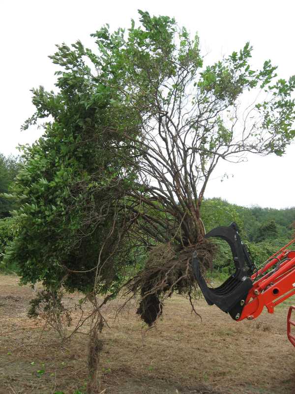

Wide one. I Use the wide one most because of the 51 inch opening, here it is picking up 30 cedar trees: http://www.tractorbynet.com/forums/...ppling-fun-picture-thread-19.html#post4343409
Picking up some cedars pulled with the tree puller, can't do this with a clamshell style:
For my uses two lids are an advantage, but a narrow single lid will work for most things.
When I move long trees with the either grapple I balance it and leave the lid up.
Here is one on the narrow single lid:
Here is one load a single lid wouldn't secure:
