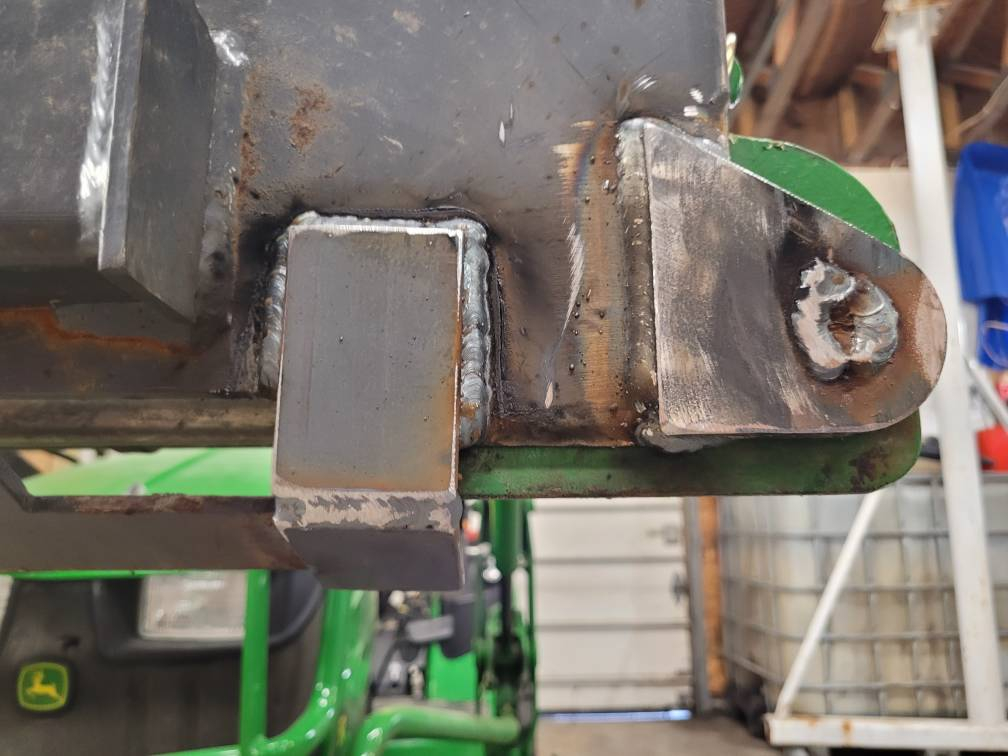

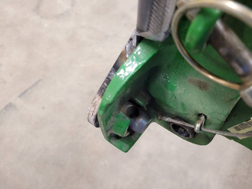

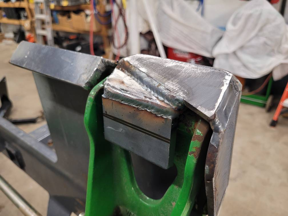

Tack welding to secure it is probably a good idea. A nice middle ground between fully welded and pinned on. It keeps the options open. Thanks for that thought. I appreciate everyone taking the time to be helpful.
I don't think I'd tack it on other than to make sure of fitment before I did a full weld. I believe that the point forces on the tacks might get a bit high, but if it cracks you can always redo the weld as long as something doesn't bend.

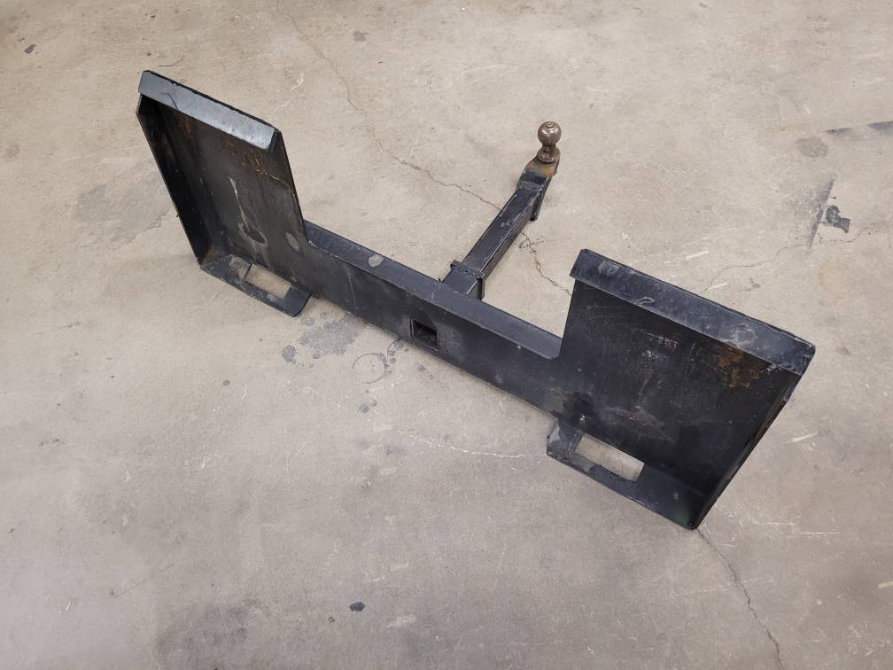

Most JDQA stuff is pretty flimsy, because the compact line maxes out at about 2500. SSQA can go about triple that. I have both in my fleet, and there really isn't any good reason to share attachments due to the capacity disparity. However, I did weld hooks and pins onto a flimsy SS trailer hitch adapter to use at a lot that has both a CAT CTL and deere CUT available to use. I mow with the deere, so now I don't have to switch machines to use the SS trailer hitch adapter to mow under the trailers.
it not going to bend, the plate is made to adapt one to the other and holding it, tack welding is just to stop the rattle or loose it between the connection... but it may eventually crack
