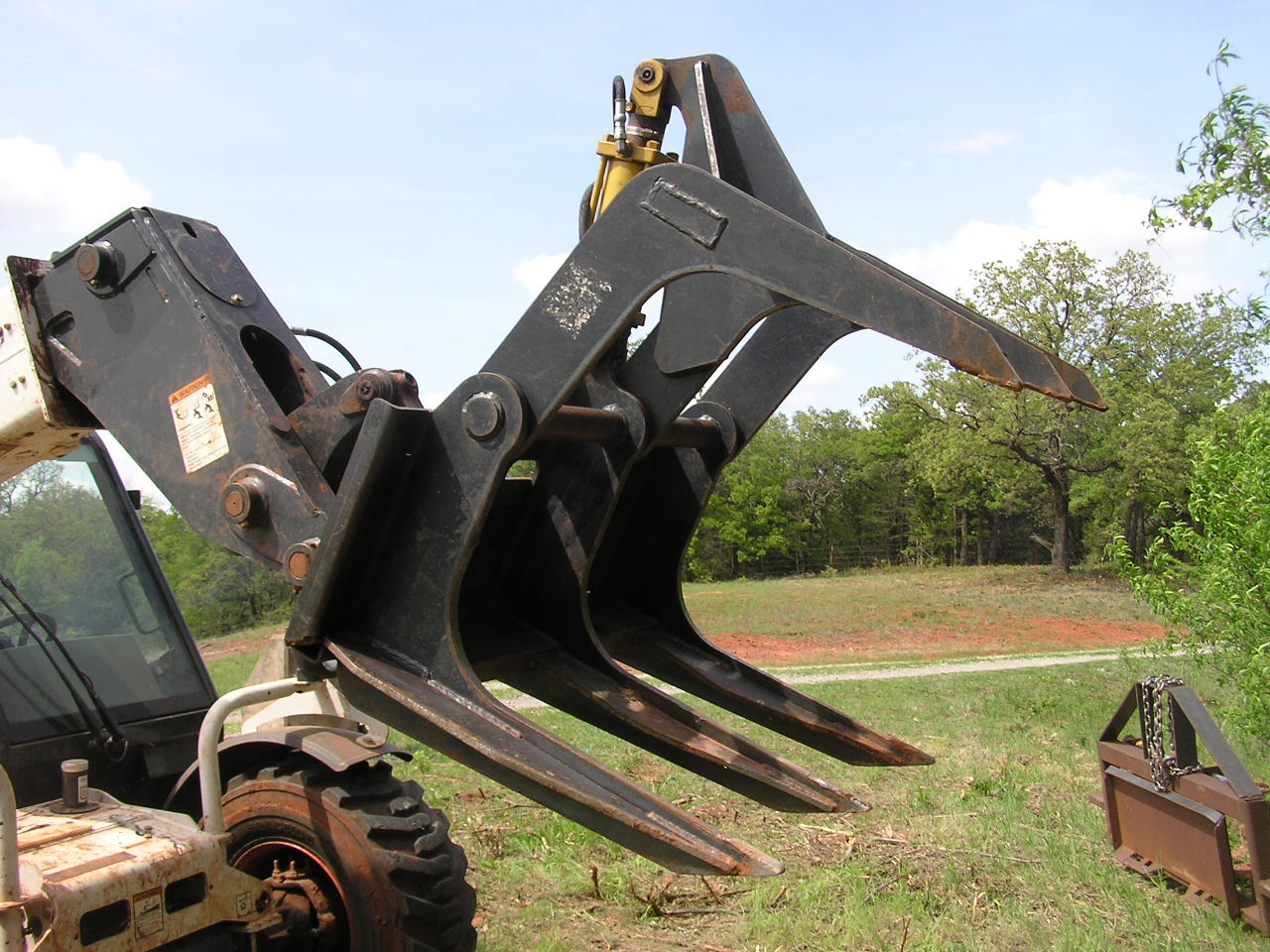

I wonder why no one can build a common sense grapple like that anymore. Wide opening, narrow, lightweight. Perfect.
Closest I see out there is the 48 inch WR Long obg2 but by the time I ship it, it is $2K.
Grapples were no where near as popular 12 years ago as they are now. Not to mention the price of 'everything' has gone up since then, increasing costs. Also, Millonzi is no longer business, so that should tell you something as well. As I understand it, the guy died, but not sure if it was a one man show or not. If so, then the profit margins don't need to be nearly as high.
The WR Long is an EXCELLENT grapple.
Armydoc, I think there is a happy medium with width of a grapple. No, you don't 'need' it to cover your tire tracks, and no, you don't 'need' a wide grapple. However, you can be more productive with one so there is an advantage.
The main reasons to go with a narrow grapple, are lighter weight (which doesn't apply to you), less cost (which may or may not), and the belief that a narrower one will dig better (which mathematically it will, however I've never had a problem digging anything, so it's not a legit reason), and you will not have any issues with digging with the power you have.
To me, it seems like the 72" would be pretty ideal. However, I'd go with whatever Xfaxman recommends since he has the same machine. The rest of us just speculating.

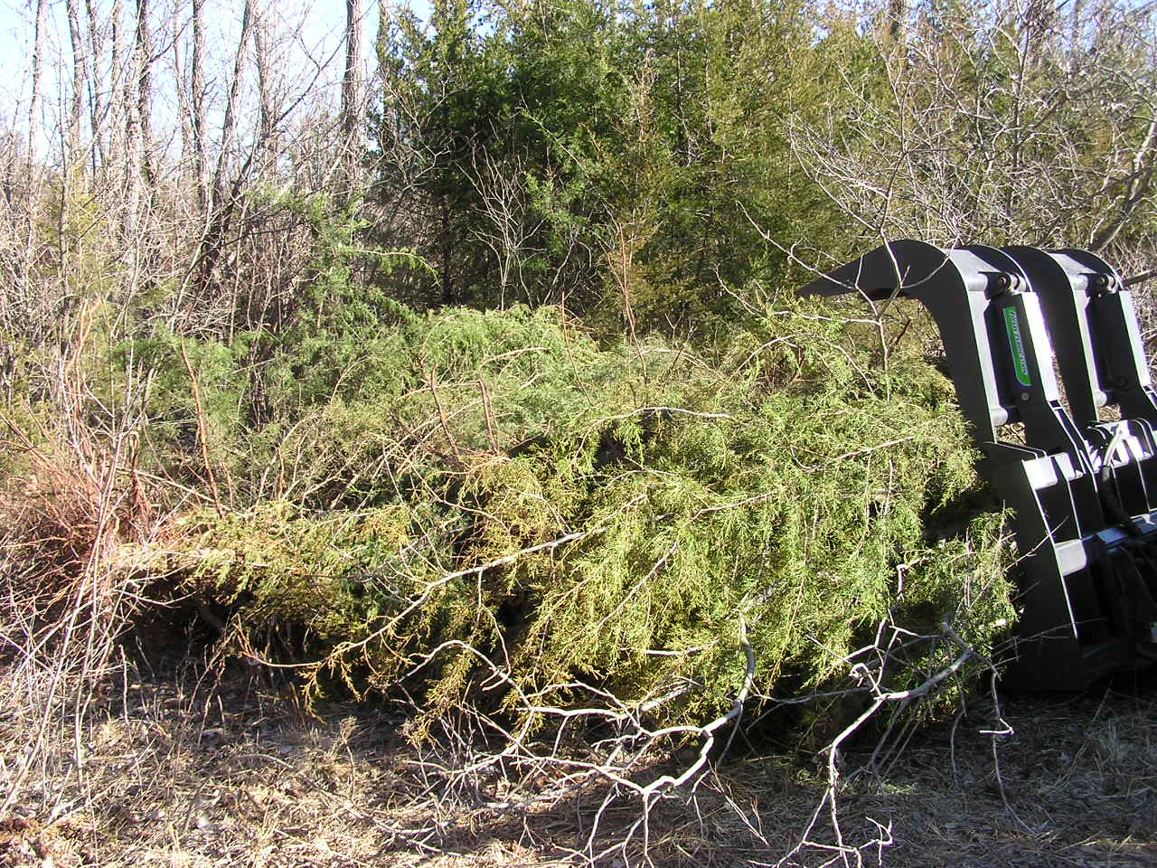

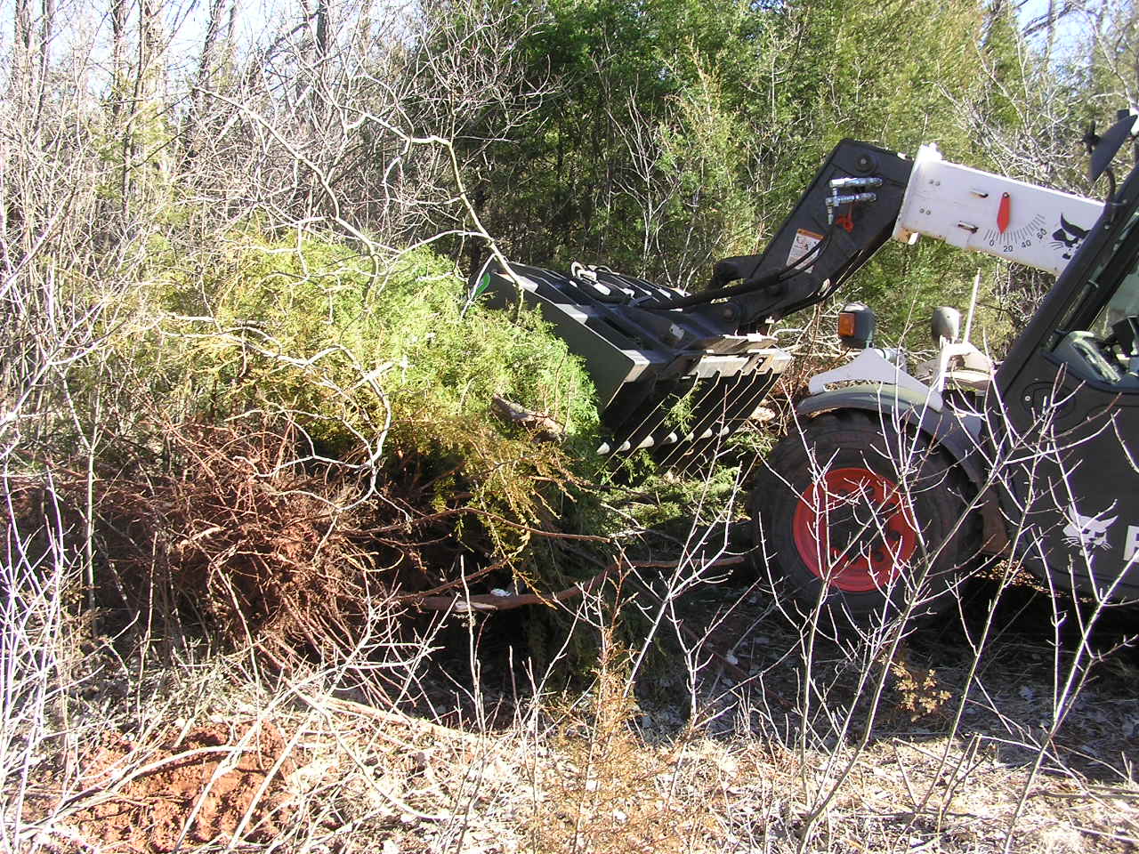

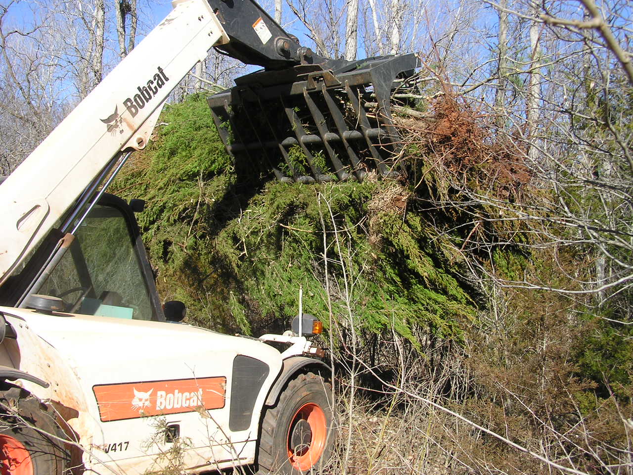

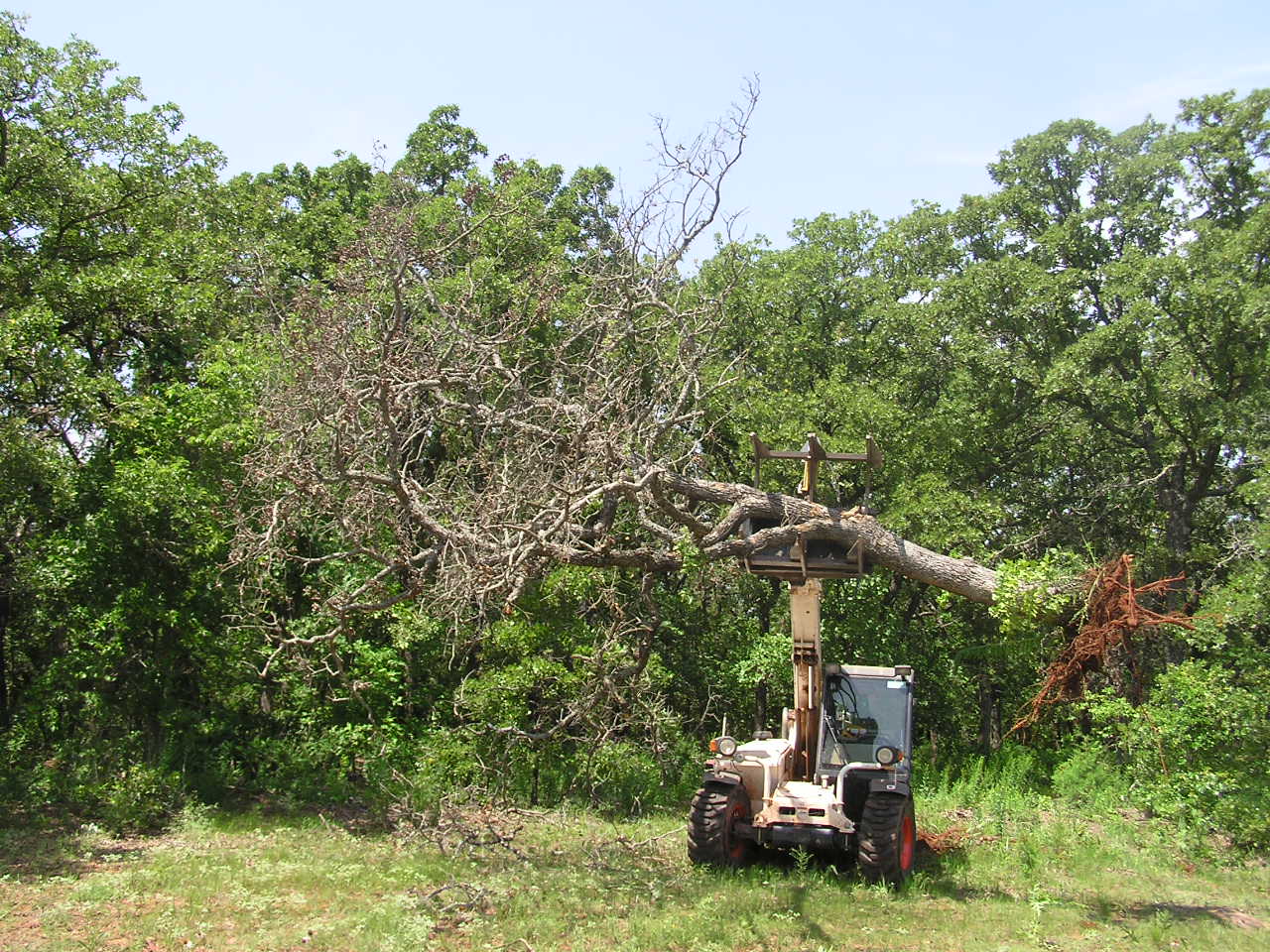

Actually my V417 is basically the same, just slightly smaller. For my uses, mostly dead trees, I have never wished for a wider grapple.
Pushed over two dead ones:

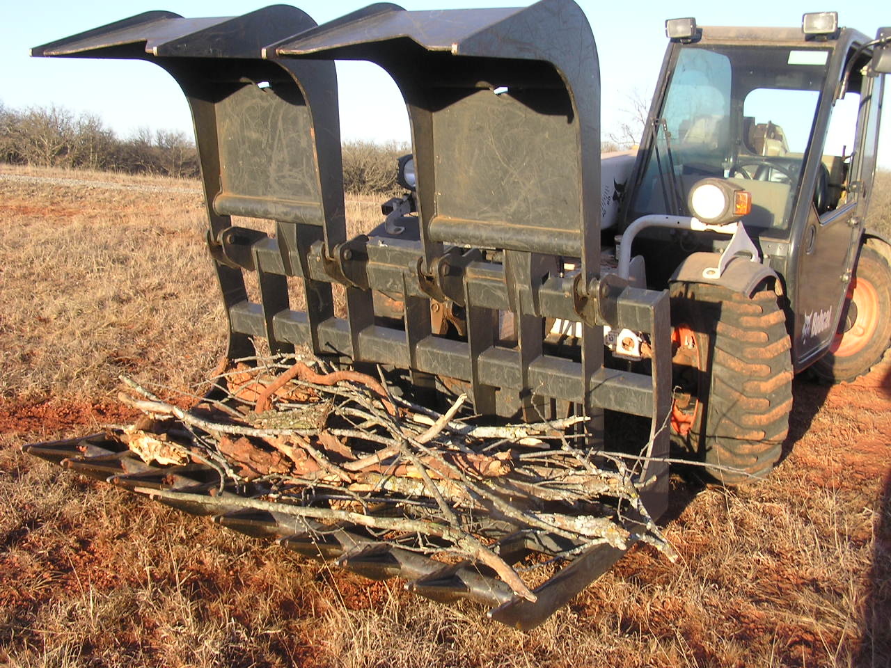

Armydoc,

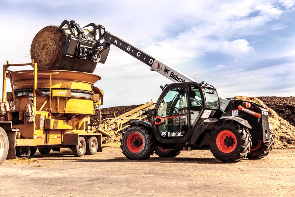

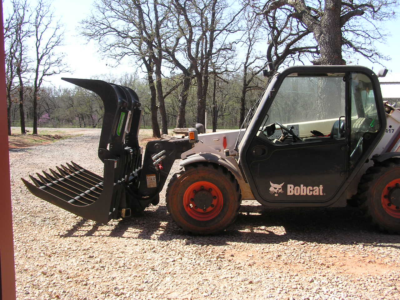

Your putting this on a telehandler right? You would absolutely pretzel a 4' wide, 3/8" mild steel grapple. Do not let anyone talk you into going with a narrow lightweight grapple with this machine. Many Many Many people have been talked into this, and it's a fine option, but for your machine, you would be simply throwing money away for scrap steel if you went with the infamous $500 Millonzi 48" grapple.
(I understand that I.T. is not recommending this, but just want this to be clear in case it's a little misleading)
Piston is right. I wasn’t aware this was to be used on a big telehandler.
/ Which grapple? #86

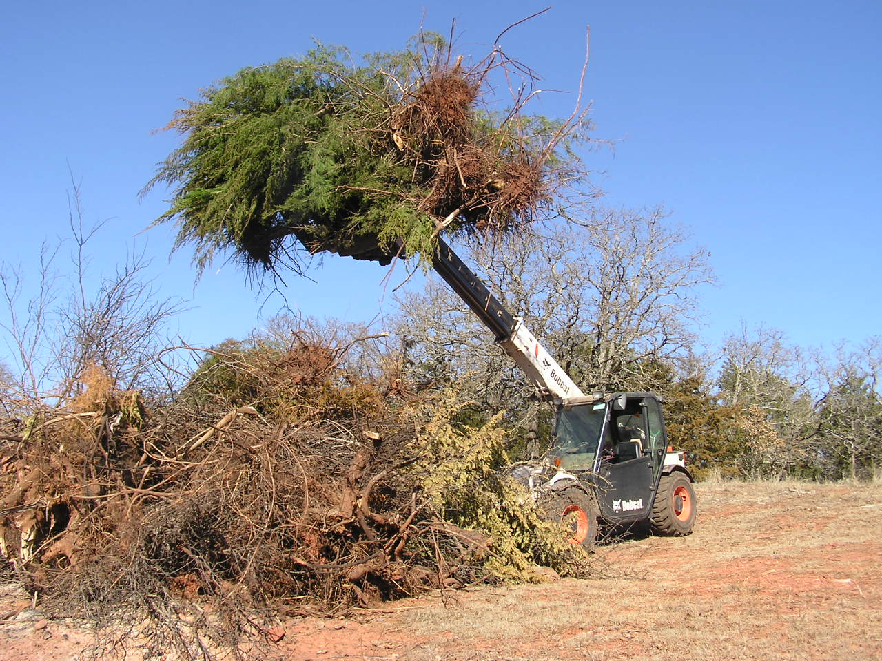

It isn't a big telehandler, it is a small compact telehandler, the new Bobcat V519. 6.9 feet wide and 6.9 feet high about 15 feet long.
Only rated to lift 5500 pounds. :D
