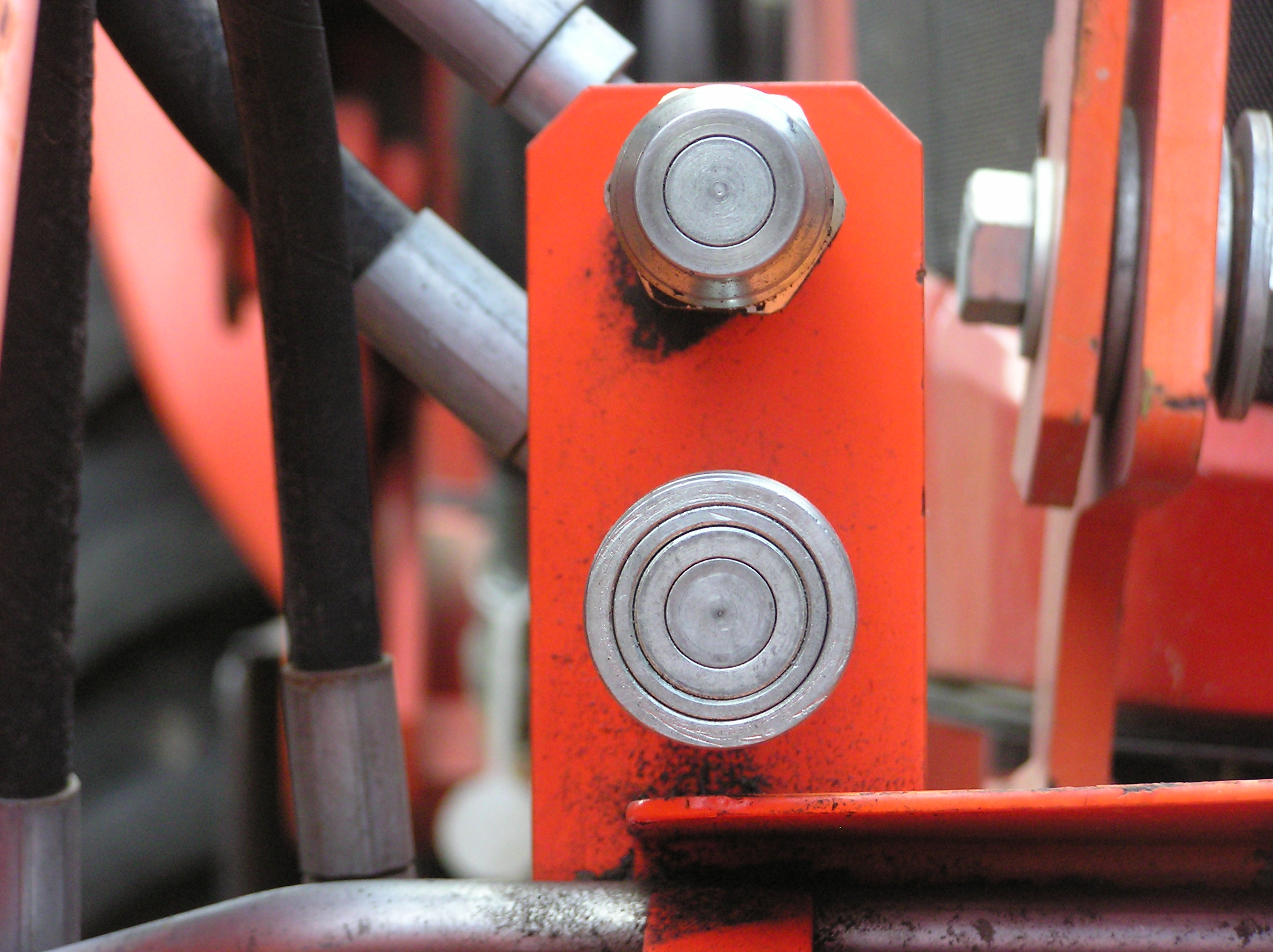

For the install on mu NX5510 I went out and bought some cheap 3/8" air hose. Garden hose was more expensive and it tended to be too big. Ran my hoses on the left side; also put in some disconnects at the loader attachment point (one day I'll put a real bulkhead in, but for now I've the hoses zip-tied). Just feed the hose until you figure you've got a good lay (free from obstruction) and then mark on the hose (mark at disconnect and then at desired full length out to the front of the loader arms (cross tube). I replicated the stress loop as found on the factory hose install on the other side of the loader mount.
Thanks, Sorry I didn't do a good job explaining in the original post. I already have a bulkhead I just need to go from it to the Grapple tee. You can see from the picture the Flat faced couplings point straight out from the bulkhead, I was thinking hoses from grapple might lay better if the Flat faced couplings were in a 90 degree position from how they are now ??

OK, yeah... (sorry, I have a hard time keeping up with all the posts :eek:)
I've been pondering this point myself, whether to face the couplers straight out or at a 90. I am kind of leaning toward a straight-on mounting as that's the way the industrial stuff tends to be; figure how you're going to be exerting force via your arms and I think it makes more sense this way- a 90 means you're going to have to apply pressure across your body, laterally, rather than fore/aft, in-line with your body. Break-away couplers also require this in-line orientation/coupling: I can't really afford break-away couplers for my use (would have to switch to Ag couplers- I have flat-faced couplers, mixed). How the hoses lay as they come from the grapple is another issue: maybe just hold them to the grapple through a bend(s) point(s) via bungee cords.

Good points, "maybe just hold them to the grapple through a bend(s) point(s) via bungee cords." Yes I was thinking Once I mount the grapple on my tractor I will use the spare hoses from my backhoe to figure the correct length for my grapple and then drive up to my hydraulic shop and have them made up.
