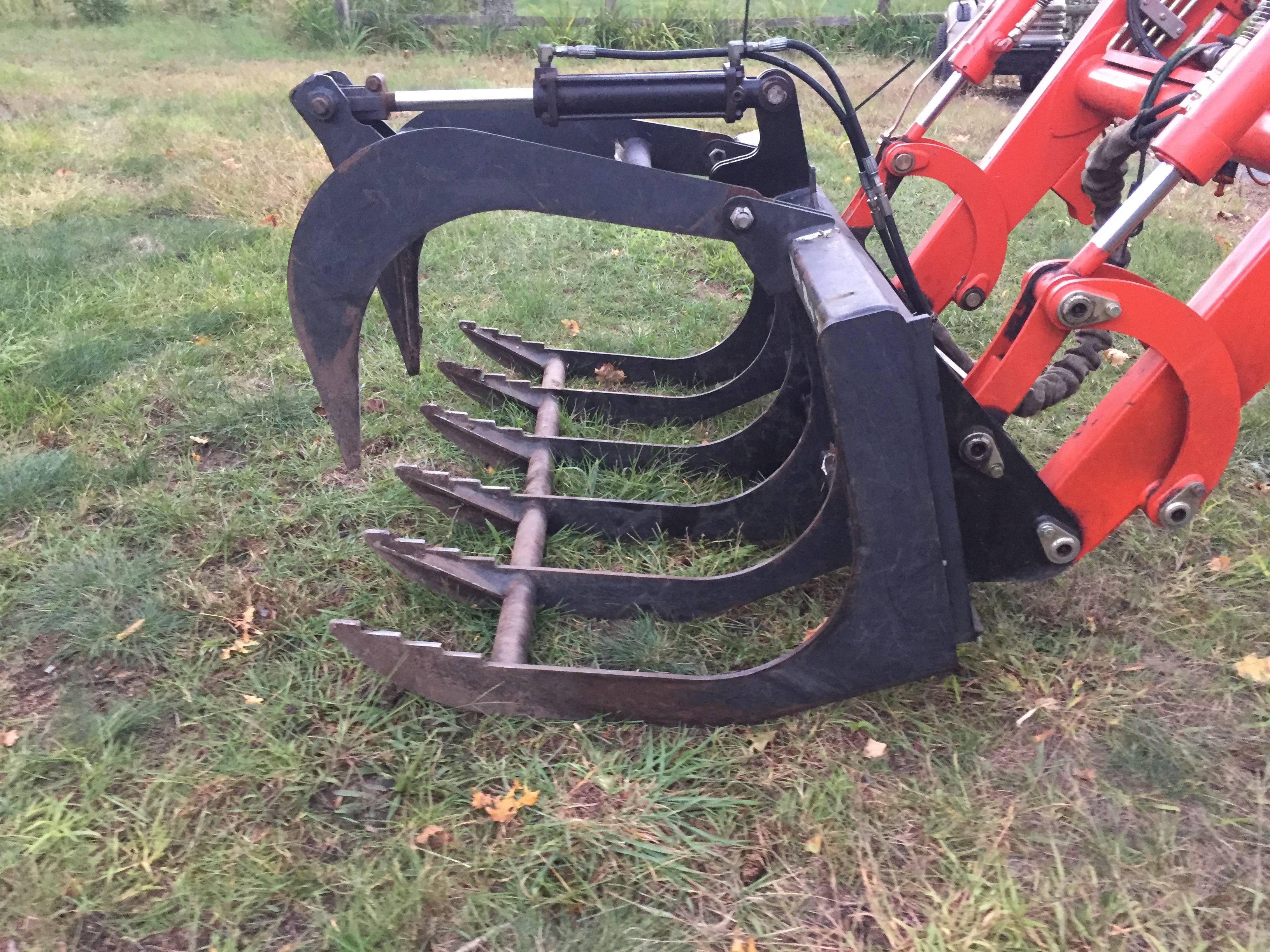

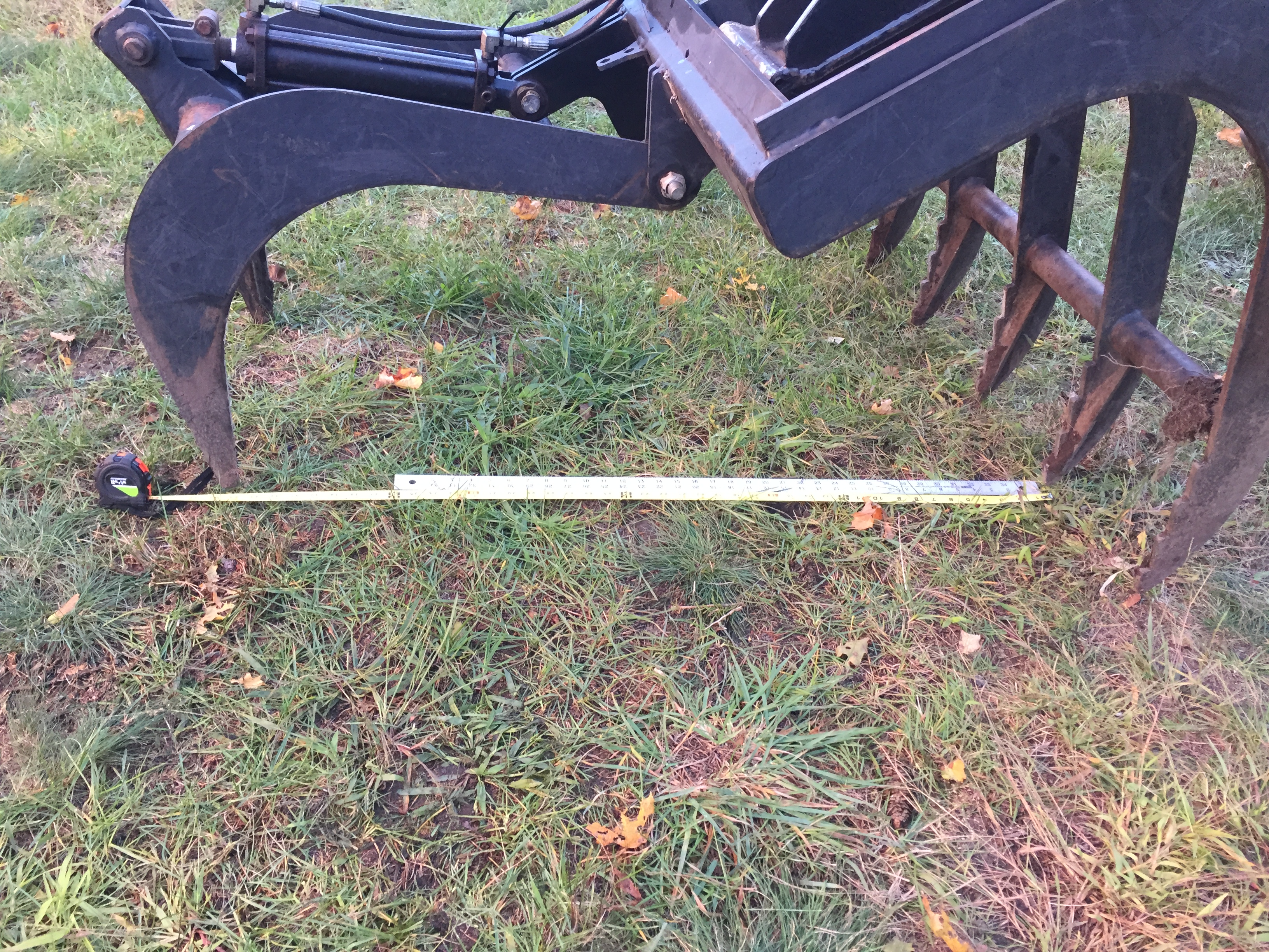

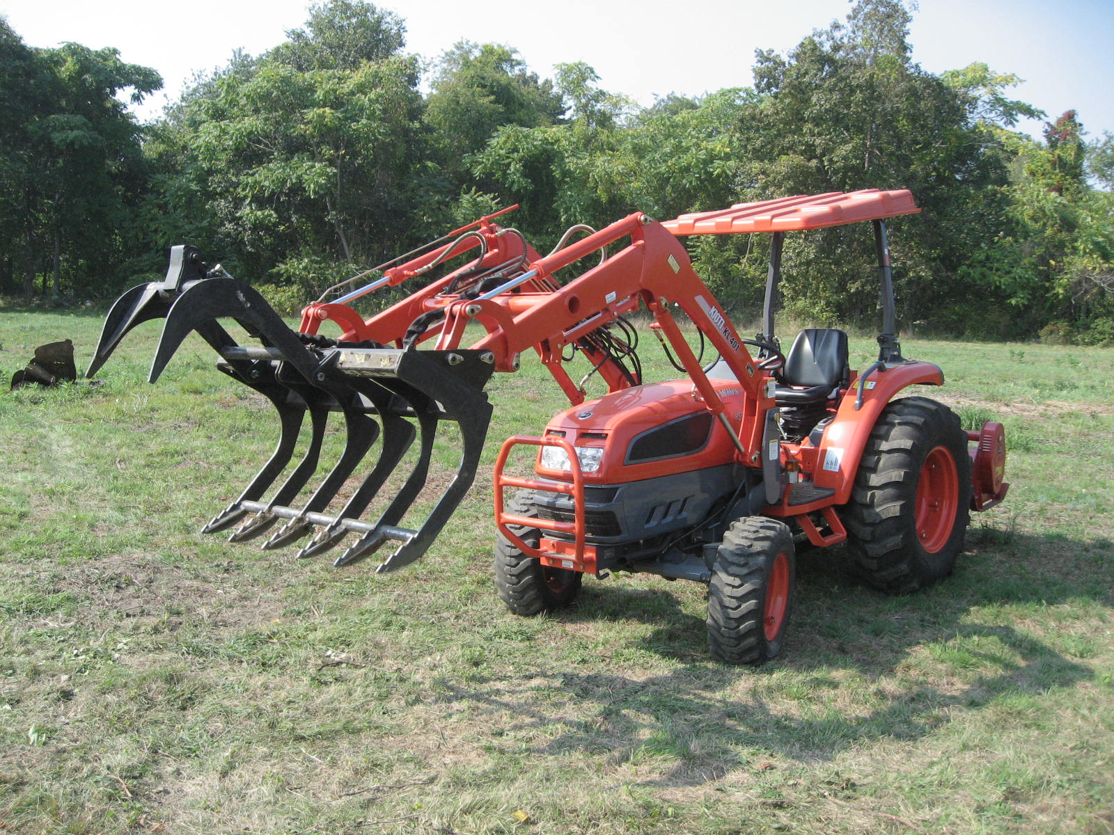

Another question regarding tines. I like the long bottom style rather than the clamb-shell style. Most of the long bottom grapples have a tube going across the front, maybe 8-10 inches back from the tine tips. (like Xfaxman's wide grapple) Another type, has thicker tines with gussets, that don't have that front brace (like Xfaxman's narrower grapple). I can see where the front brace would make it hard to penetrate brush or hay. Has anyone had any experience / problems with this?
I saw another post where they describe rolling the grapple over and grabbing from on top, so maybe it's not that big of a deal.
I will disagree with some other members ( about having the tines connected together near the front), Other than possibly bending or breaking a non tied tine
imo there (may) be some advantages.
slash piles with logs- generally full penetration is possible in a single stab
getting under old wet hay and manure when cleaning stalls- works Just like a Pitch Fork no pushing the material like a bunch of old carpet piling up.
grabbing large square hay bales by stabbing the bale and clamping the lid down on the top of the bale it is also possible to get under the bale and clamp just like a standard tied tine design.

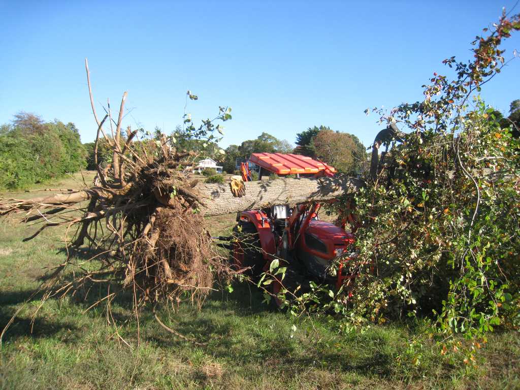

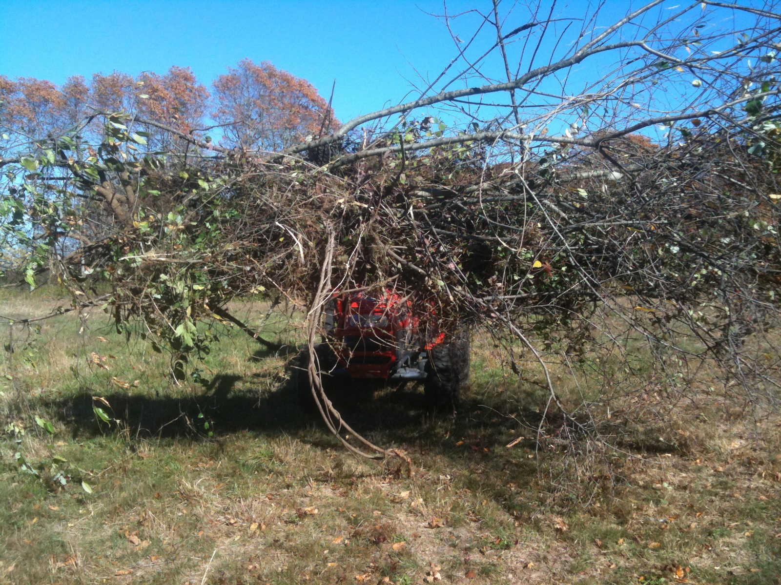

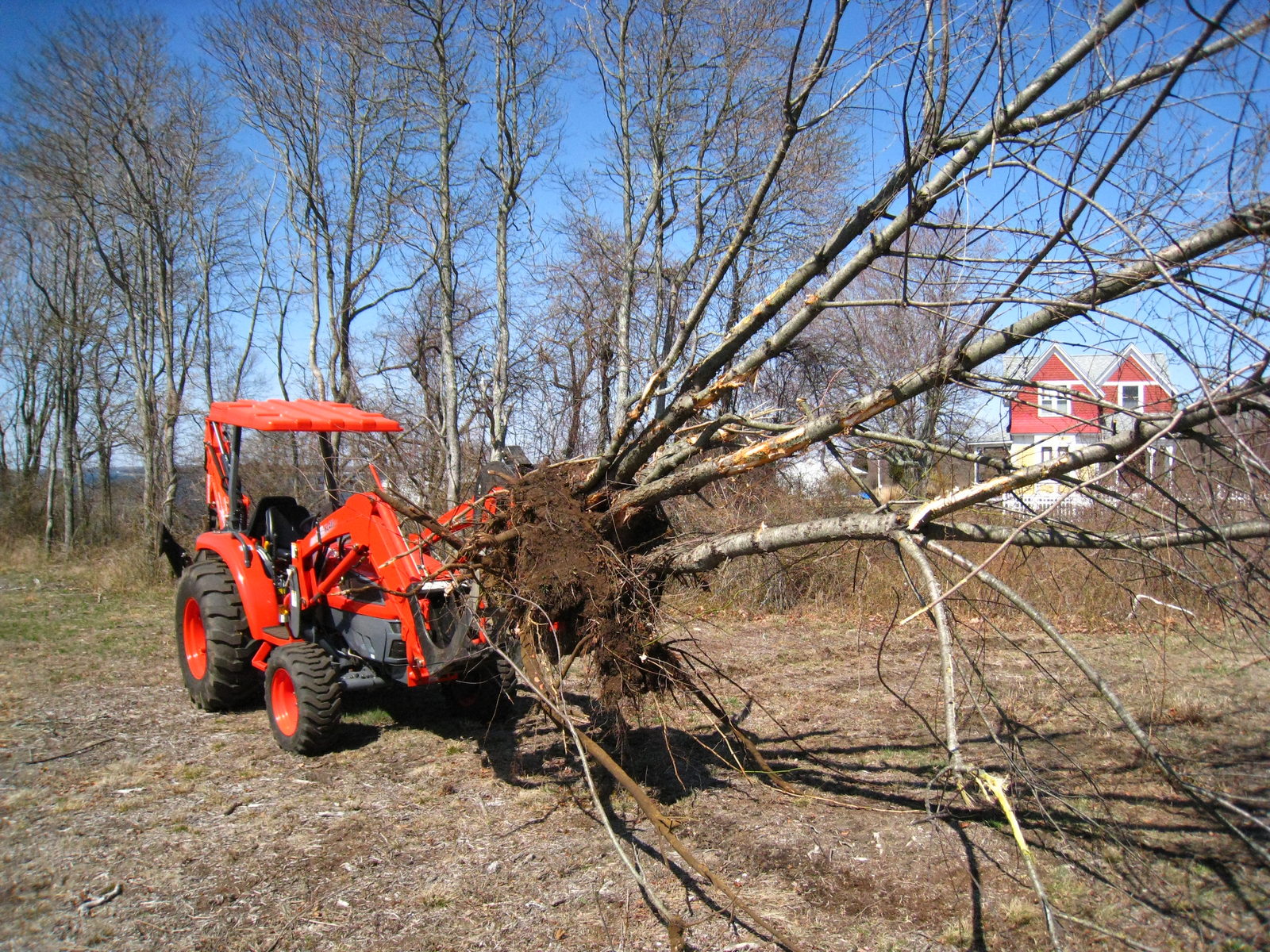

I plan to use it to:
Tree work:
a) push over dead pine trees (have used an excavator for this - push at about 15ft high, and extend the bucket -which puts a lifting force on the tree, and the tree pops right out - even 10-14" pines) I figure I will push at ~15ft up and curl the grapple upward, to have the same effect)
b) Hold said trees to cut in 8-10ft lenghts with chain saw
c) gather and haul said trees to burn pile
d) pick up trees knocked over by wind for b and c
Brush work:
e) grab wisteria off trees higher up and rip it down
f) move large brush piles of saplings (after pulling them up stacking them with tree puller)
g) pull out and move to burn pile brush (not a lot but some)
Ground work:
In areas with wisteria or a other plants with a lot of superficial roots, grub out roots using it as a root rake.

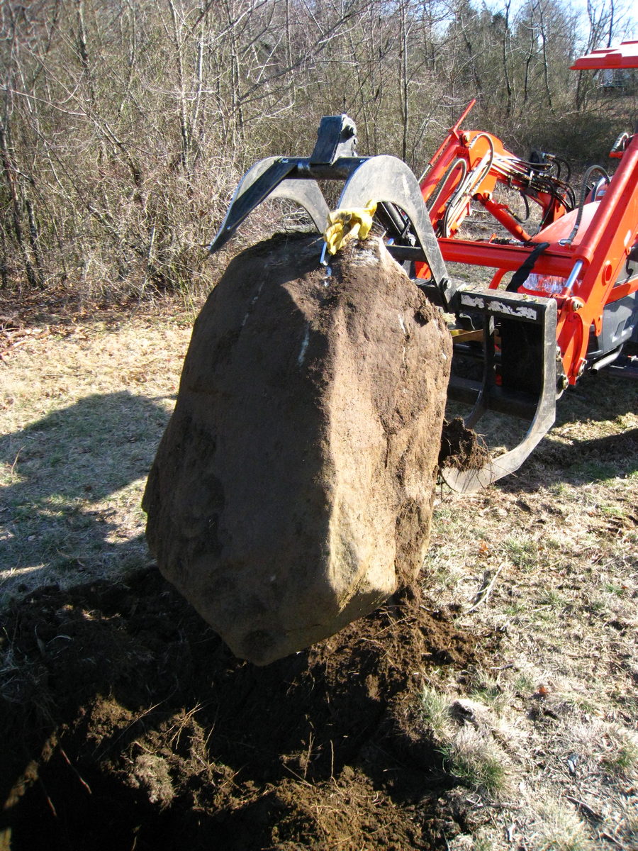

Monster grapple certainly opens wide, and because they are close enough for me to go pick up directly from the factory, I can get it at wholesale prices. Still 72" is less than 96", so trying to figure out what is best choice.
Machine width is listed as 83", but on the diagram, the out side width of tires is shown as 90 inches.

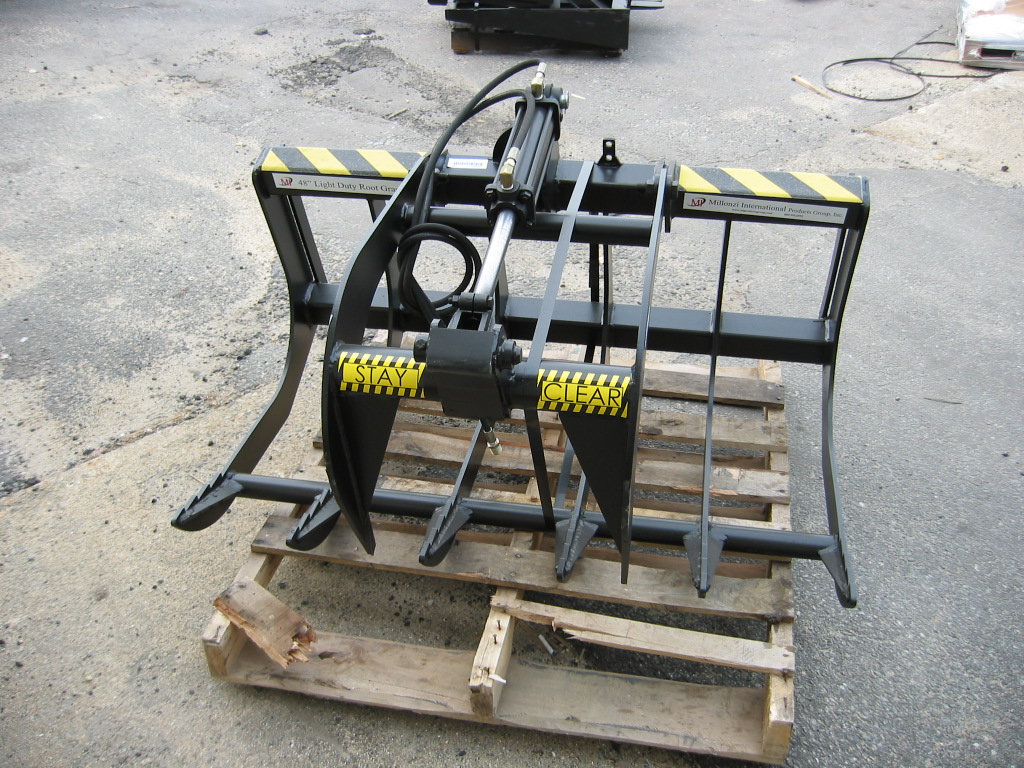

I do all that type of grapple work with a 300lb 48" grapple with opening width of 42+ inches. Never had a need for a wider or heavier grapple. I've used the same grapple on a 20hp and 40hp tractor. 3/8" mild steel with 0.25" square tube and round tube construction. Simple unsophisticated construction. Works fine 12 years later.
I wonder why no one can build a common sense grapple like that anymore. Wide opening, narrow, lightweight. Perfect.
Closest I see out there is the 48 inch WR Long obg2 but by the time I ship it, it is $2K.
