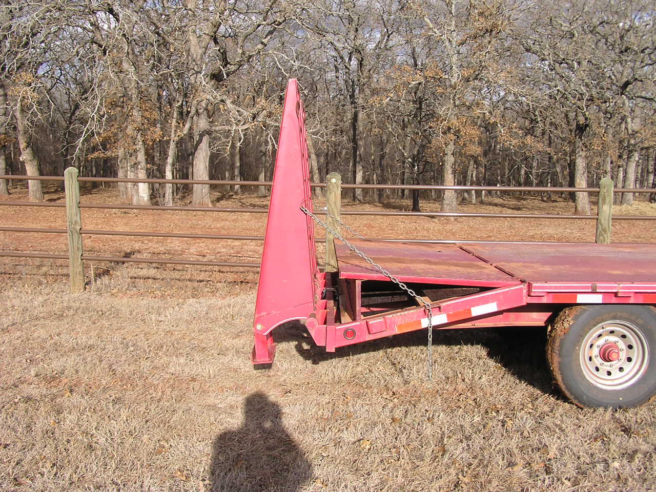

I don't like the "pop up dovetail" like some manufacturers have. I prefer the adjustable dovetail where the entire tail will level out greatly reducing the tail dragging coming out of fields!
/ Which Gooseneck Trailer? #22
Yep, tail dragging, had one that did that on the terraces in the hay field. Ordered this this Delta with a 4' pop up dovetail instead of 5' and no more tail dragging. :thumbsup:
I think some trailers come wi th 4' tails instead of 5'. Iirc my FIL had a quality trailer that had a 4 foot tail. I didn't care for the trailer much, but I'll still take the adjustable tail to have a completely flat deck for hay or bulk material hauling and drop the tail for loading rolling loads. The pop up tails looked to be alot lighter in construction to me. I don't know that it matters a whole lot, just personal preference. When I get a bigger GN, it will be a tandem dual with a hydraulic tail.
/ Which Gooseneck Trailer? #28
I would love to have one with a hydraulic tail. Especially hauling hay. And sometimes when hauling my equipment, I have to get creative with the ramps! LUTT
/ Which Gooseneck Trailer? #29
I agree. Loading cars can be a creative endeavor! If we are really dreaming I want to get air ride too!!

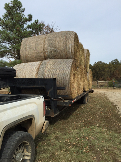

I have a Gatormade GN 20' + 5' deck over. It weighs 5700# and grosses at 16000#. I have a Ferguson To-35 with a Howse 5' bush hog, front end loader, and loaded tires. I tow with a 2012 Ford F-350 ccsb 4x4 6.7l diesel srw. The total combined weight full of fuel is 21750#. You won't win any drag races but it handles it easily. The reason I went with Gatormade was the ramp design. I previously owned another brand with a torque tube and fixed positioned ridged ramps. The ramps were 8' long and hinged at the outside edges of the trailer. They were super heavy, and half the time were in the wrong place to load what we were hauling. The other thing that presented itself was the ramps chasing me across any kind surface other than concrete or pavement. Why did we buy that rig in the first place? It was the cheapest one we could find. The suck age lasted WAY past the savings
