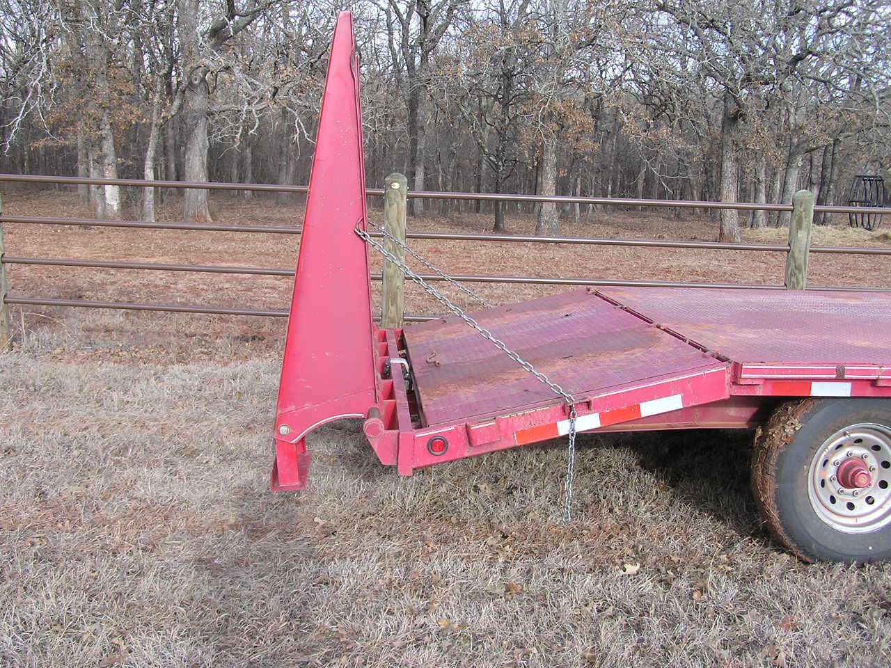

I have a Gatormade GN 20' + 5' deck over. It weighs 5700# and grosses at 16000#. I have a Ferguson To-35 with a Howse 5' bush hog, front end loader, and loaded tires. I tow with a 2012 Ford F-350 ccsb 4x4 6.7l diesel srw. The total combined weight full of fuel is 21750#. You won't win any drag races but it handles it easily. The reason I went with Gatormade was the ramp design.---------------------------------

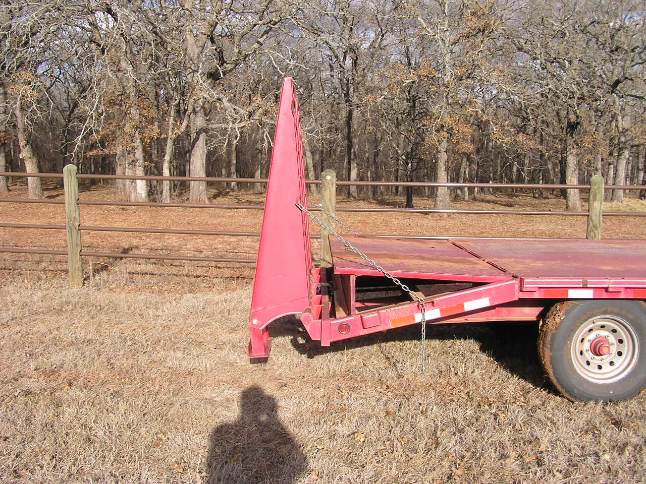

I went and picked up my Gatormade 25 plus 5 with the mega ramps and I had them outfit mine with the 2 10k super single axles with 17.5 tires instead of the tandem duals with 16" tires, I am very impressed with this trailer, everything about it from the clean welds to the powder coated finish, I was also impressed with how my 2500 HD with the 6.0 gas motor pulled the trailer, 70 mph with no trailer behind me going up to get it I got around 15 mpg, pulling the trailer home at 70mph I got 13 mpg and you couldn't even tell it was back there. Gatormade has some really good prices going right now, they made me a deal I couldn't pass up.

They arranged for it to make it as far as Byron Georgia and I drove up and picked it up from there. Are you near Gainesville? Charlie.

IMG_20151210_143003480_HDR.jpgIMG_20151210_142945533.jpgIMG_20151210_143018993_HDR.jpg
