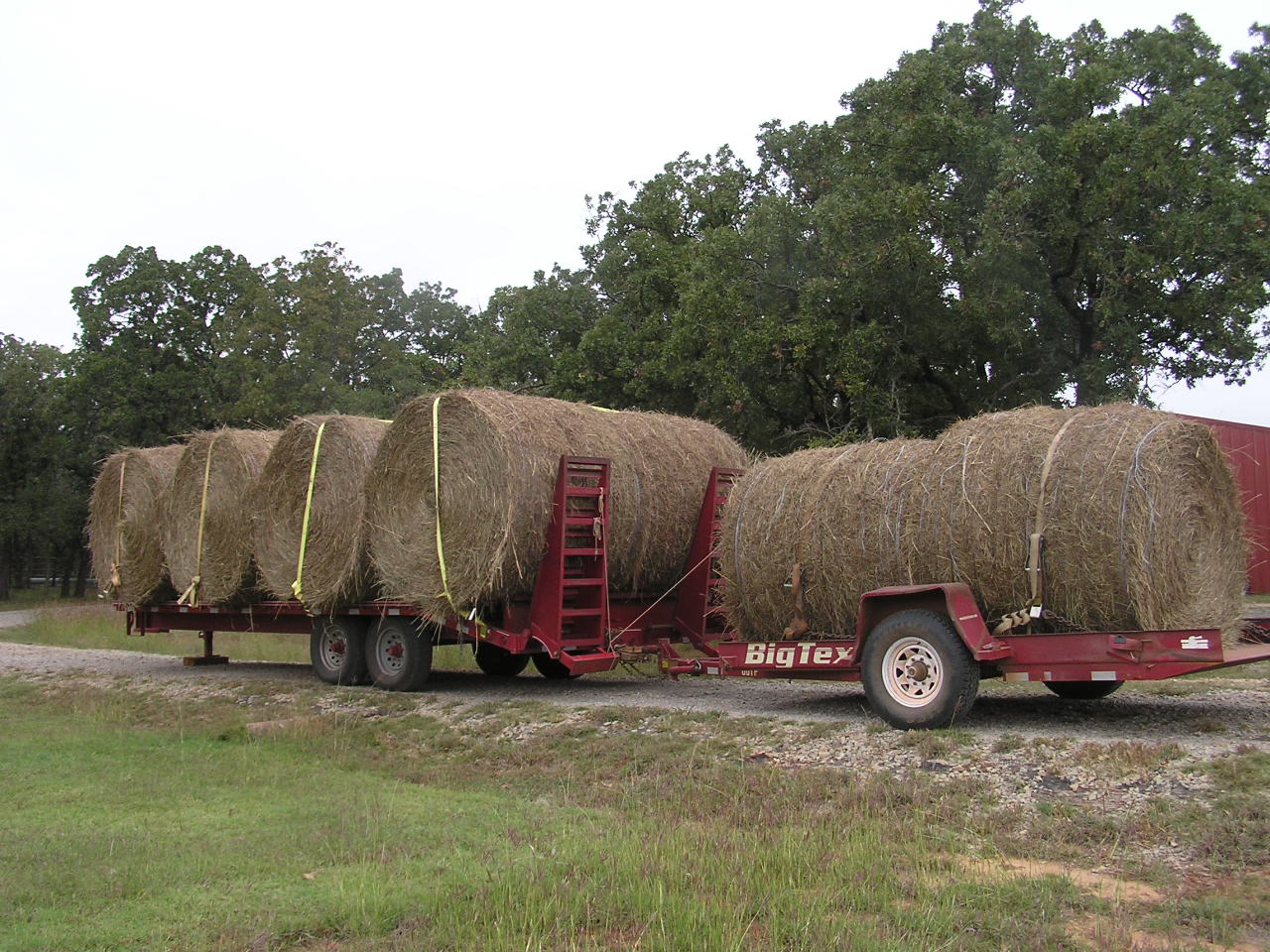

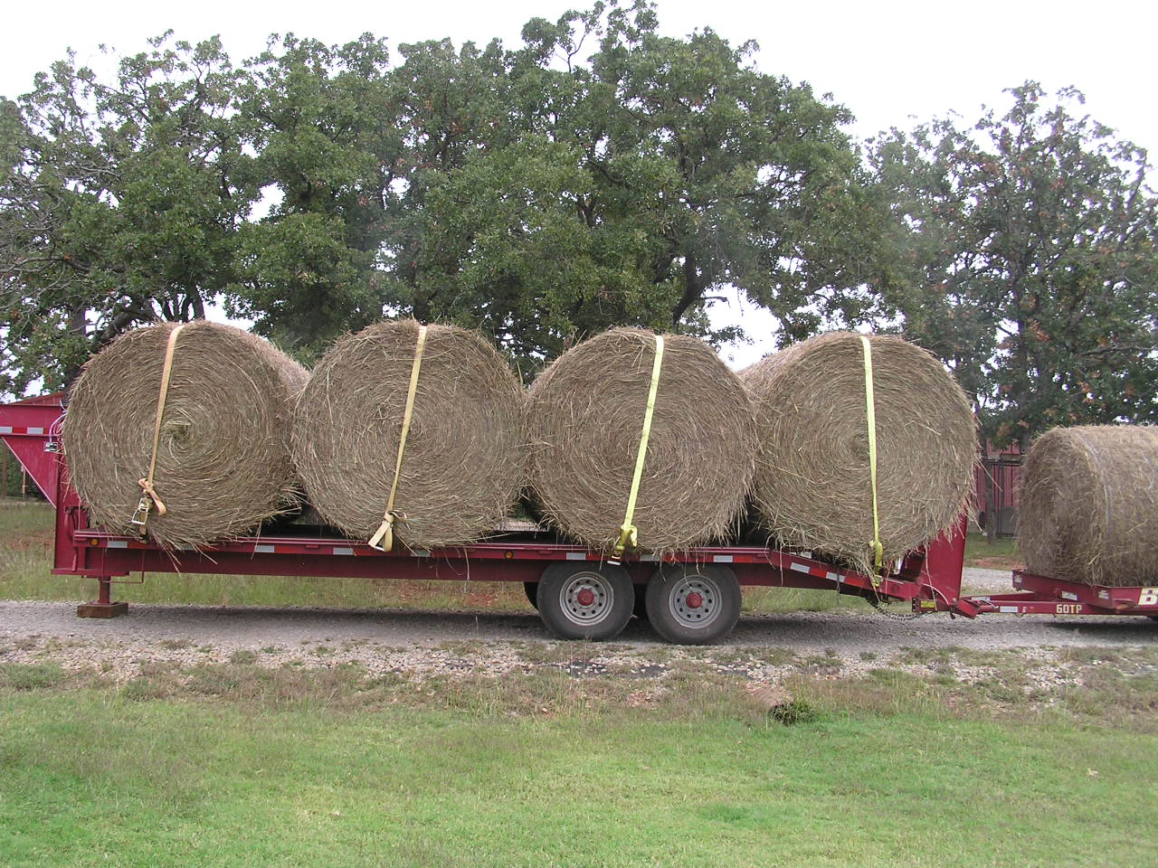

What size/weight round bales?
Here is our Delta 14K 18' deck with a 4' popup dovetail with over 11K of 5x6 bales.
More details on the trailer: http://www.tractorbynet.com/forums/...d-up-slide-ramps-post3224882.html#post3224882
And: http://www.tractorbynet.com/forums/...6068-hauling-10-5x6-round-hay.html?highlight=

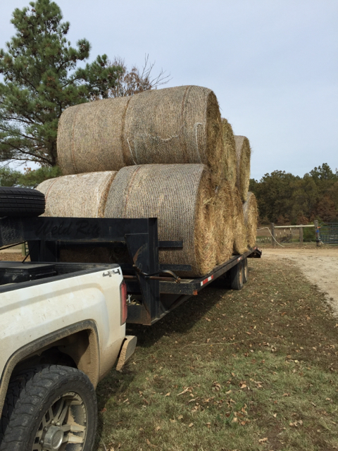

I have fourteen on here at the time. If i put a piece of plywood over the ramps, I can haul eighteen double stacked like this. Trips were short and only hauled fifty bale this day. My next gooseneck will be dual wheels for stability. I live in the hills, when you double stack hay and get your center gravity up, some of the places I haul in and out of are little rough. Lol. It would help if I had random duals. Trailer is a 25 dovetail, made here local by the same people that build Shaver wood furnaces. They are plenty stout. I also run fourteen ply tires. LUTT
They look like 4x5's, did you ever check the weight?
The heaviest load that I ever weighed was 12,640 on the deck, 3,440 ball, 14,200 axles, 24,940 total, 3/4T truck and trailer.
The trailer weighs 5,000 pounds, 1,000 on the ball, 4,000 on the axles.

Ours are 4x5 round rolls weighing somewhere in the neighborhood of 900 to 1000lbs each, the hay field is about 400 yards down the road from my driveway so I won't be hauling very far, I know I don't really need the 20,000lb capacity trailer but I figure I am probably only going to buy one of these in my lifetime and I want to be sure I have plenty of capacity.
Is your truck a gas or a diesel?

My truck is a diesel, and yes these are 4x5 bales, I can haul the 5x6 bales also. I have never checked weight of it loaded, those are John Deere baler made and roughly run 800 pounds for Bermuda, and a 1000 for the peanut bales. LUTT
