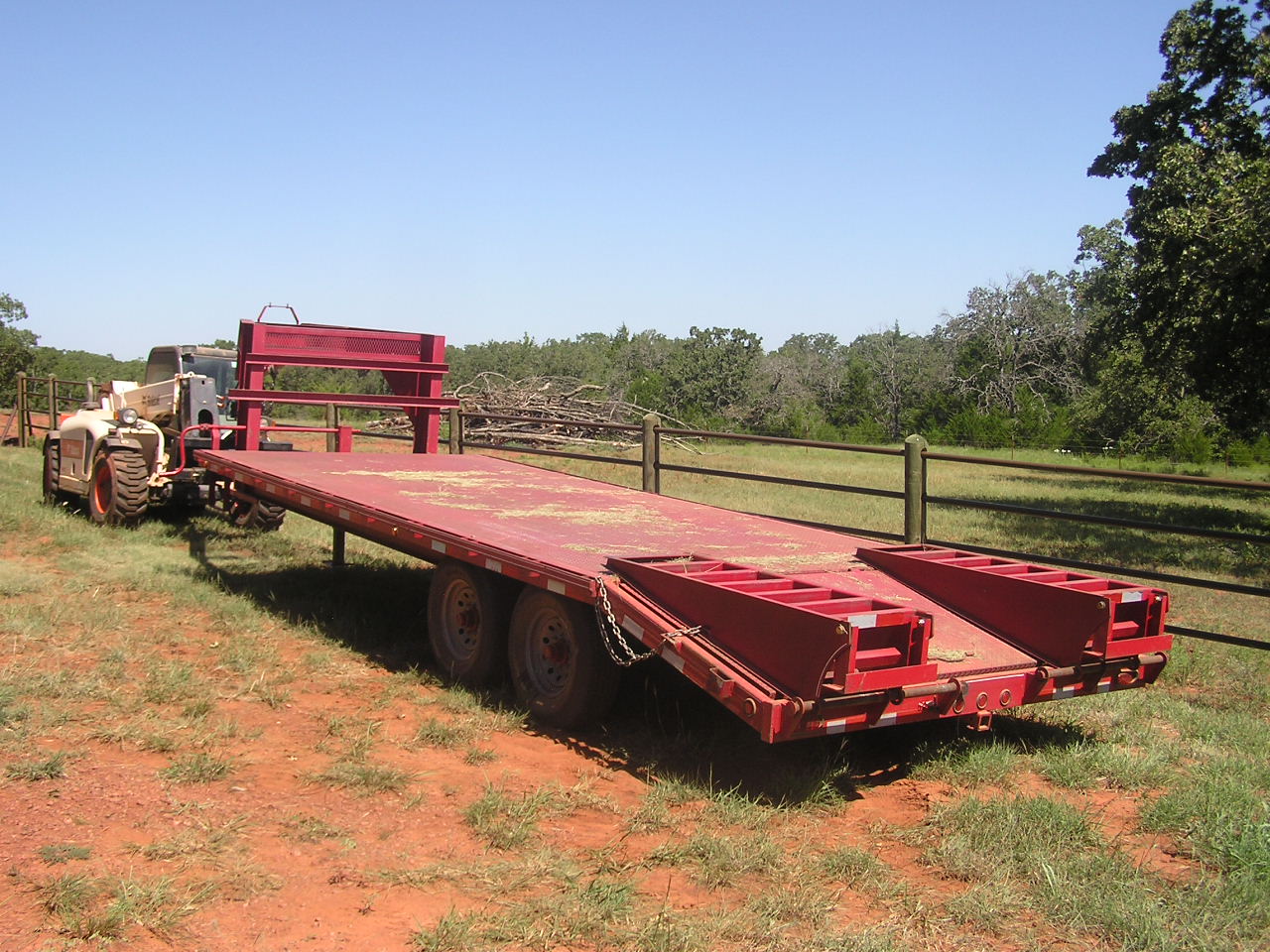

Nice trailer. Do you know the empty weight on it? What is the GVWR - 20k?
I,m sorry it took me so long to get this trailer weighed, but I have been so busy with any and everything else, but I put it on the scales today and it weighed in at 7,380 pounds almost exactly what my truck weighs. One other thing I felt like I needed to clarify is that the axles were not Dexter axles, they were LCI or Lippert axles, I have read a lot about problems with these axles but they were pretty much all on travel trailers and were not 10k axles, I have since talked to some people who said that there are nothing wrong with these axles and that the company had gotten their issues fixed and that all the parts are Dexter compatible, anyhow I haven't had any problems and thought I would give an update. Charlie.

Nice looking trailer Lineman! Those Gator trailers seem to be well built. I think I'll look into them for when I replace my gn trailer. I would be looking for almost the same trailer. We run 17.5s on stock trailers and have been super pleased with them.

I have been very pleased with the 17.5 tires and the 10k super single axles and yes they are heavy built trailers, I got the workhorse series which is their basic trailer but it still has the 14" I beam pierced frame and appears to be very well built, it doesn't have the Dexter axles like their top of the line trailer, it has Lippert axles but I haven't had any problems so far, for $ 7695.00 for a 25 plus 5 made just like I wanted it, I can't complain.

sweet trailer! I'm in the market. Assuming u have 4.10 grears like me, does this weight mean you have a carrying capacity of 6,620#s?

I do have the 4:10 gears in my truck, as far as the trailer goes they call it a 24k trailer, I assume they are considering pin weight as a factor in them rating it that high, this is what I consider it, the trailer has 2-10k super single axles with 17.5 tires, therefore I consider my carrying capacity to be somewhere around 13,000lbs. Will I put a little more than that on it when hauling hay out of the field, probably so.

Yup, they are expecting you to put 4~5 K on the pin when they rate your trailer. You will be limited by your trucks axle rating.

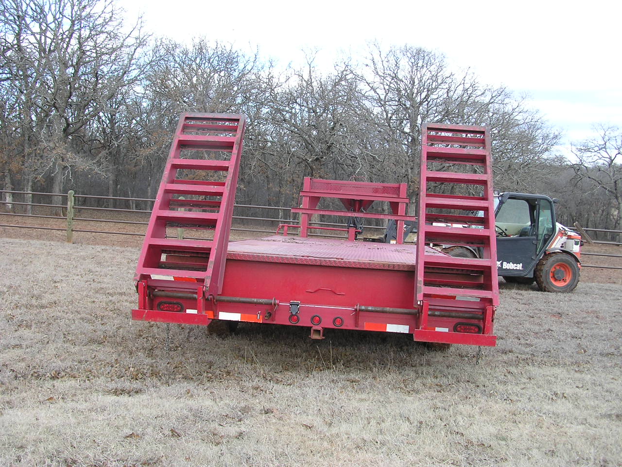

I imagine I am probably a little overloaded, but it pulled it and stopped it without a problem, I also decided to test the theory of not having a torque tube and completely loading one side, I did and it never flexed or budged that I could tell.
/ Which Gooseneck Trailer?
#80
Sorry on the last post I uploaded the same picture twice.
